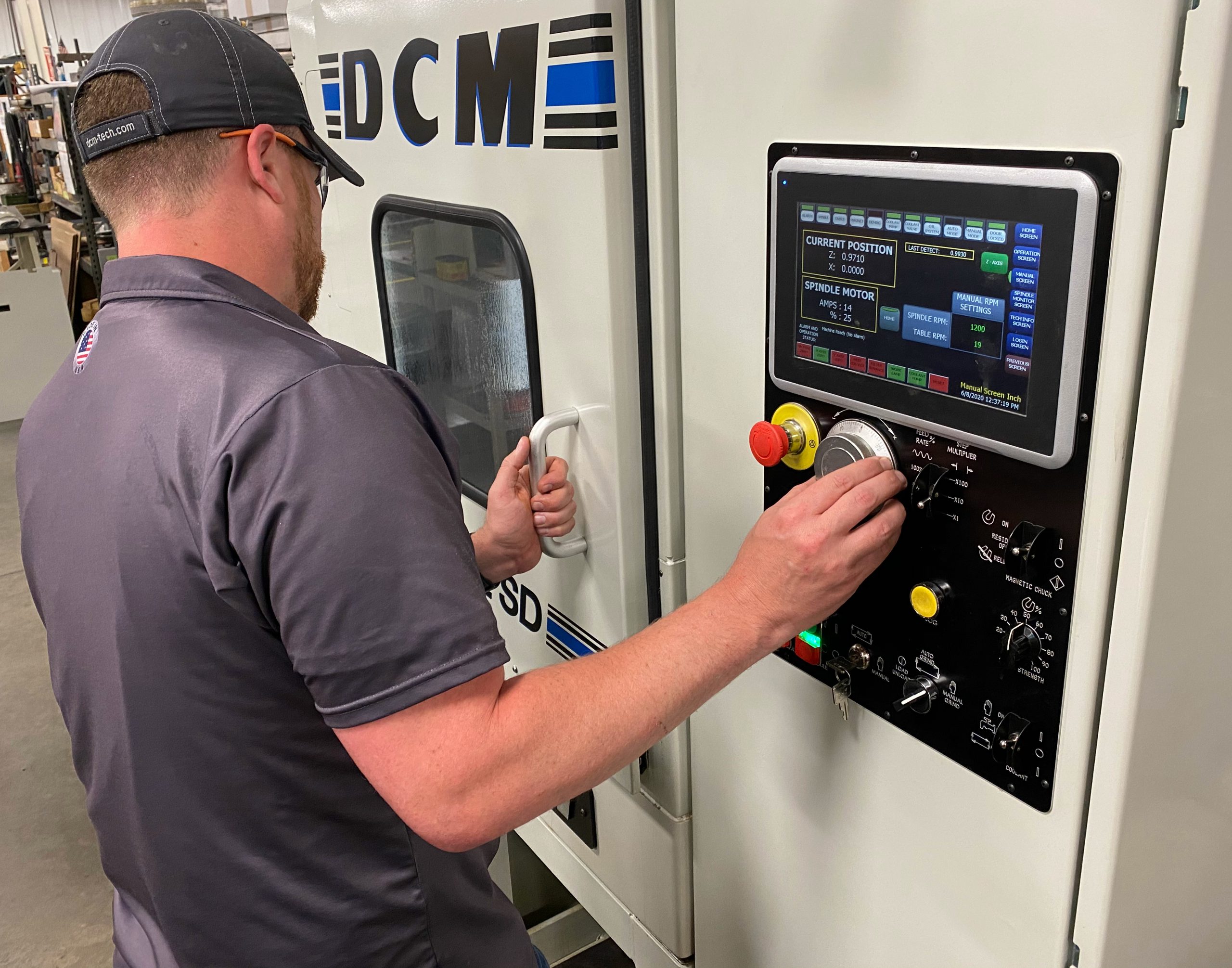

Today, surface grinders are designed with much more advanced sensors and controls that automatically maintain very tight tolerances, removing material down to within one ten-thousandth of an inch of the final thickness. Digital technology allows for an interface with easy-to-use touchscreen controls. When combined with automation, surface grinder operators are no longer required to be highly trained individuals.
For example, rotary units such as DCM Tech’s IG 282 SD, with a 24″ variable speed table and 20HP variable speed grinding spindle motor, make it possible for virtually anyone to successfully operate a unit.
One example of innovation available in this model involves the automation of the initial touch off sequence between the abrasive wheel and the part, which typically has to be finessed by the operator. With this updated option, advanced sensor technology detects vibration, then automatically initiates the grind sequence.
“Automatic part detection eliminates the need for the operator to do time-consuming, error prone ‘manual touch offs’ where they would manually feed the grinding machine until it just touches the surface of the part before manually starting the grind sequence,” says Anderson.
Advanced rotary surface grinders are also much faster than reciprocating grinders because the units can finish the grind faster by not having to take multiple fine step finish passes.
In addition, programmable Human Machine Interface (HMI) controls allow operators to enter grind parameters via a touch screen. For routine processes, a variety of grind “recipes” with sets of parameters for specific parts provide repeatability of processes, enhance quality, and aid in quick changeover.
According to Anderson, the automation provided by advanced rotary grinders allows operators to set up the machine and then attend to other tasks. The machine does not need to be constantly monitored because it has built-in load monitoring.
