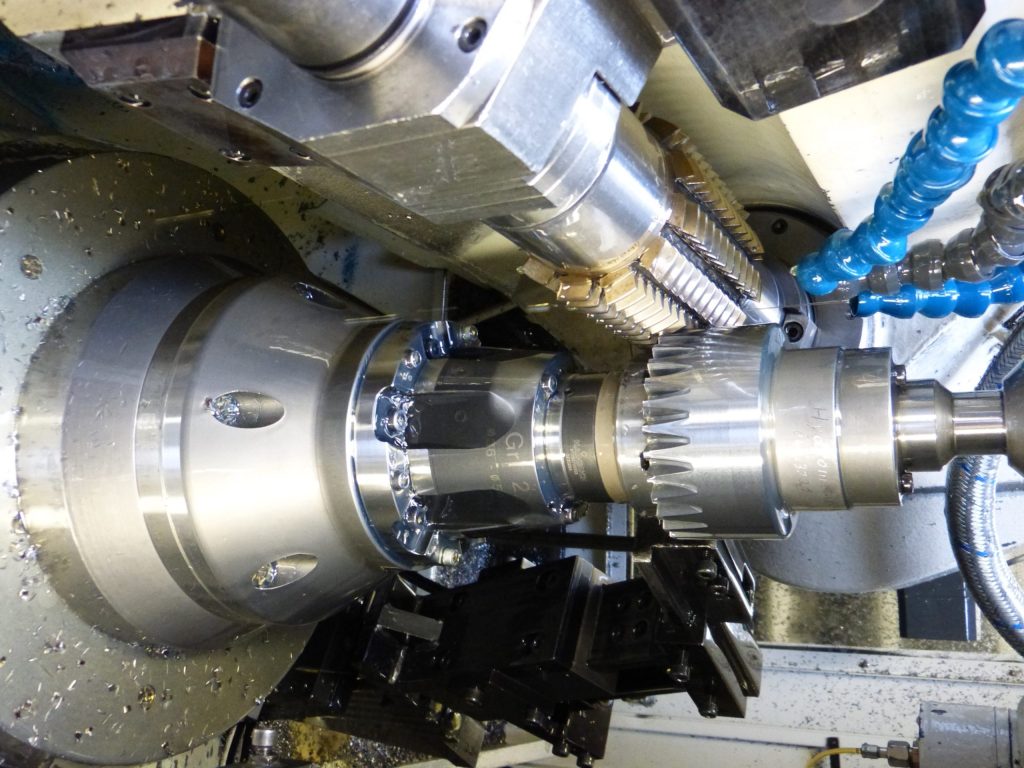

The Mando G211 mandrel on the Gleason Pfauter is suitable for hobbing. Photos courtesy of Hainbuch

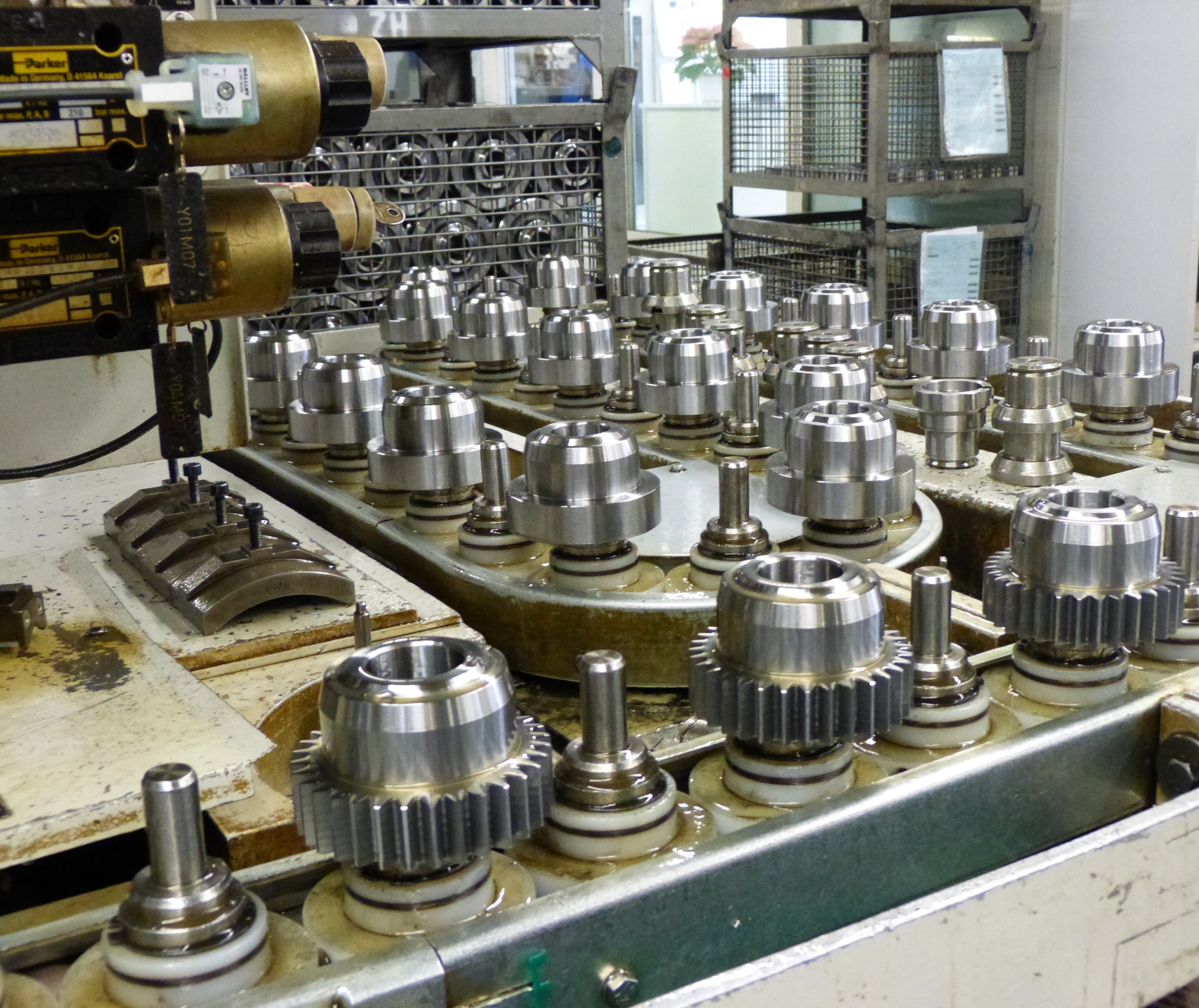

The automatic loading system with the gears on the Gleason Pfauter machine.

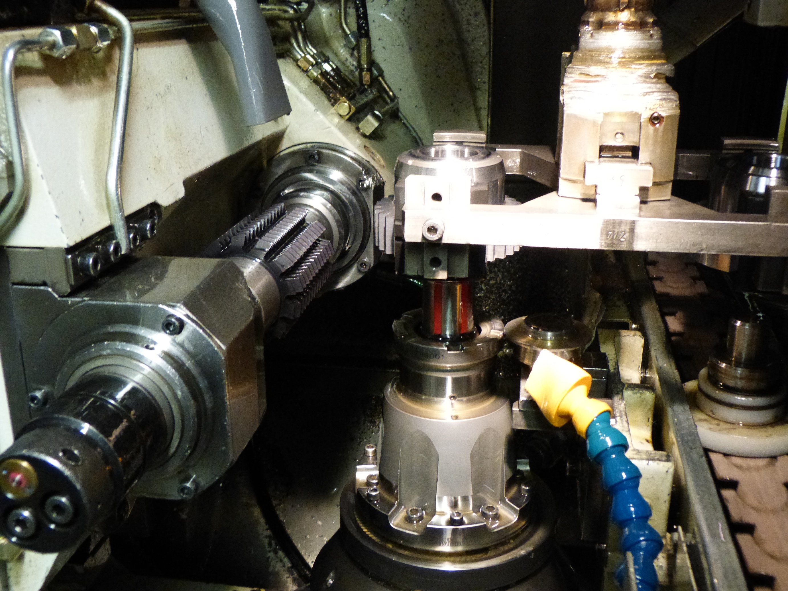

Hänel initially received two prototypes of the Mando G211 mandrel in sizes zero and two. The mandrels were tested on the Richardon R 400 manual loading machine and on the Gleason-Pfauter GP 200 hobbing machine with automatic loading to see if they would be compatible and work properly. Renner has to admit: "For our employees, this new clamping system was very strange. For 20 years, they worked with a clamping system from the machine manufacturer without radial clamping, which worked fine so far. For the first attempts, we had to make some adjustments to the machine. In addition, we did not reach our zero line on the Gleasen-Pfauter machine because the mandrel was too tall. As a result, adjustments to the machine and loading system were required. It also turned out that the mandrel had to be technically slightly optimized. What followed were a few conversations and phone calls with Thomas Steiger, product manager, and Hannes Ludwig, the responsible designer, both at Hainbuch. We have diligently tested and passed on all the information needed to further optimize the mandrel."
All design changes were implemented by Hainbuch. Subsequently, the revised second prototypes were made available. After a lengthy field trial and a few minor adjustments to the machine, the stiff and slender mandrel could, thanks to the use of Hänel, go into series production and be produced for stock.

Renner said: "With the current clamping system, we did not manage to achieve a good concentricity. The workpiece was pressed axially downwards. Now it is clamped with the mandrel from the inside, radially outwards. Thus, we have a higher stability within the clamping. This eliminates the reworking of certain components. For some of our orders, the old clamping system was good, because the concentricity was not so important. But basically, I must say, the better the concentricity, the easier it works later. With a normal hardened gear, the bore still needs to be reworked, but all the workpieces that are fully geared can now be reduced to one operation."
