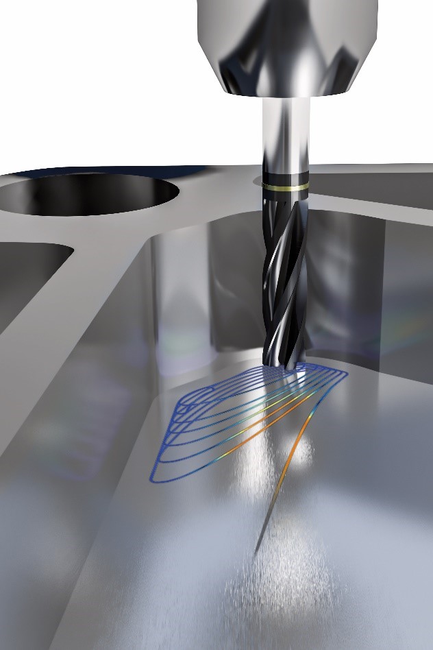

Trochoidal milling has been around for quite some time. Many in the industry have seen direct positive impacts on tool longevity and higher removal rates (MRR) by utilizing its fundamentals. Conventional machining methods are out of date in many situations.
Due to the ongoing improvements in machine motion control, CAM systems, and the design of simple, easy-to-use Trochoidal Cycles available at many controls, it is worth looking into its practices for a long roughing routine or for tough, hard-to-machine materials.
Trochoidal milling has become a popular technique to utilize in slotting, pocketing, roughing, and machining of hard materials found in aerospace components such as titanium and Inconel where the chips are typically hard to break.
How does it work?
VHM end mill
Imagine a satellite orbiting the earth at a constant height. If one were to apply a large enough force perpendicular to its orbital path to force it back to earth, it would exhibit a type of circular path. With each revolution, its rate of travel or pitch in this orbital path is its trochoidal movement. A circular motion with a low radial engagement and constant step-over (feed per tooth) is the best way to describe trochoidal motion.
Another similar type of toolpath motion that also reaps many of the benefits we will discuss is a peel-type toolpath. These toolpaths typically have an arc-in-path followed by a straight line or a line that follows the contour shape followed by an arc-out-path. There are specific parameters that generally describe a peel-type toolpath. Typically, it is around a maximum of 10% tool engagement with a maximum Z depth and higher feed rates between the transition moves. There is also a reduced feed rate upon entry to maintain the appropriate relationship in feed-per-tooth between the center of the cutter and the outside cutting edge upon engagement.
Capabilities and benefits of these strategies?
The advantages of low radial engagement in trochoidal milling create a reduced chip thickness that reduces the load on the tool, a positive byproduct of this strategy. A reduced deflection provides closer to nominal stock allowance in all areas of the contour. This helps to ensure the tool is removing the same amount of stock when finishing the surfaces, which will ensure uniform surface finish quality or integrity. Low radial engagement’s big advantage lowers the temperature at the cutting zone, which provides a less thermal load on the tool. This creates better predictability in a process and simultaneously provides better tool life.
Trochoidal milling techniques create superior chip removal, especially when M8 or air blast accompanies. Therefore, the possibility of having to re-cut chips is reduced. Uniform tool engagement both radially and axially is also a benefit of using these strategies. This translates to uniform wear along the cutting edges and also keeps the tool sharper longer due to the small radial engagement strategies created by the control or CAM system. Higher cutting parameters are also possible. This is because of chip thickness principles.

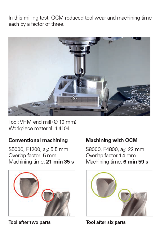

With Heidenhain’s latest generation of NC software, the company now has the capability to rough a part with trochoidal movements using its newest and latest OCM (optimized contour roughing) cycle. This is an option for the TNC Controls. With these cycles, a user can rough a 2D contour, and finish walls and floors if needed.

In closing, trochoidal/peel mill style techniques are well proven to save time and tool life in machining operations. If you are not yet using them, I encourage you to investigate this possibility on your existing equipment if it can handle fast and accurate requirements or on your next purchase.
If you have a newer machine, find the operations where you may be able to try these techniques, then find the right tool, hold it preferably in a hydraulic or shrink fit holder, and experiment with trochoidal techniques available on your control or in your CAM system.
