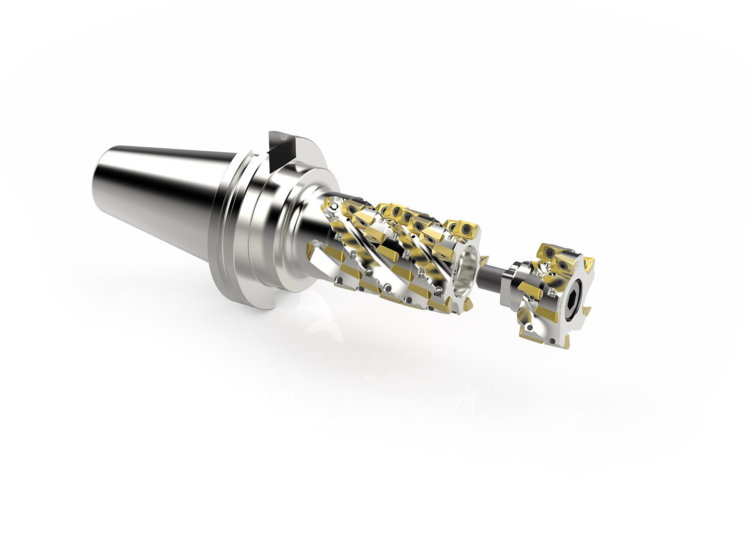

When it comes to achieving high material-removal rates in even the toughest materials, it’s hard to beat helical cutters. With the correct insert grades and cutting data, these cutters can achieve far greater depths of cut than non-helical milling tools without sacrificing reach or the ability to hold tolerance. This means higher rates of metal removal at speeds that reduce the time the inserts spend in-cut, simultaneously minimizing cycle times and maximizing tool life.

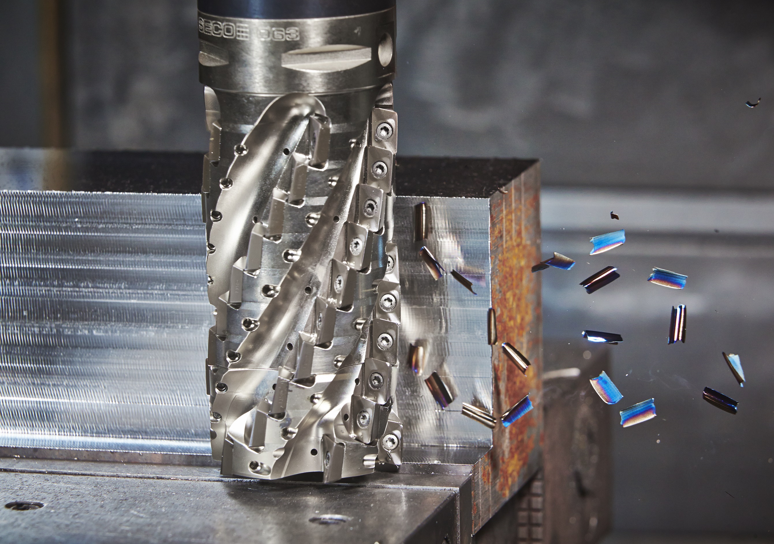

Despite that disadvantage, there are a myriad of reasons to choose helical cutters. In one example from the aerospace industry, a custom helical cutter used for machining landing gear torque links paid for itself within months. Made from Ti5553, a heat-treated titanium alloy, the part was previously machined using a high-feed milling strategy that required 84 passes. With a custom helical solution, that number was reduced to only four passes with a 1.25″ DOC.
Given the massive reduction in the number of passes, one might expect a slower process. However, the helical cutter provided six times the tool life of the high-feed mill and a 40 percent increase in metal-removal rate. The result was a cycle time reduction of 60 percent, which, over the course of a year of machining, created more than $40,000 in savings.
