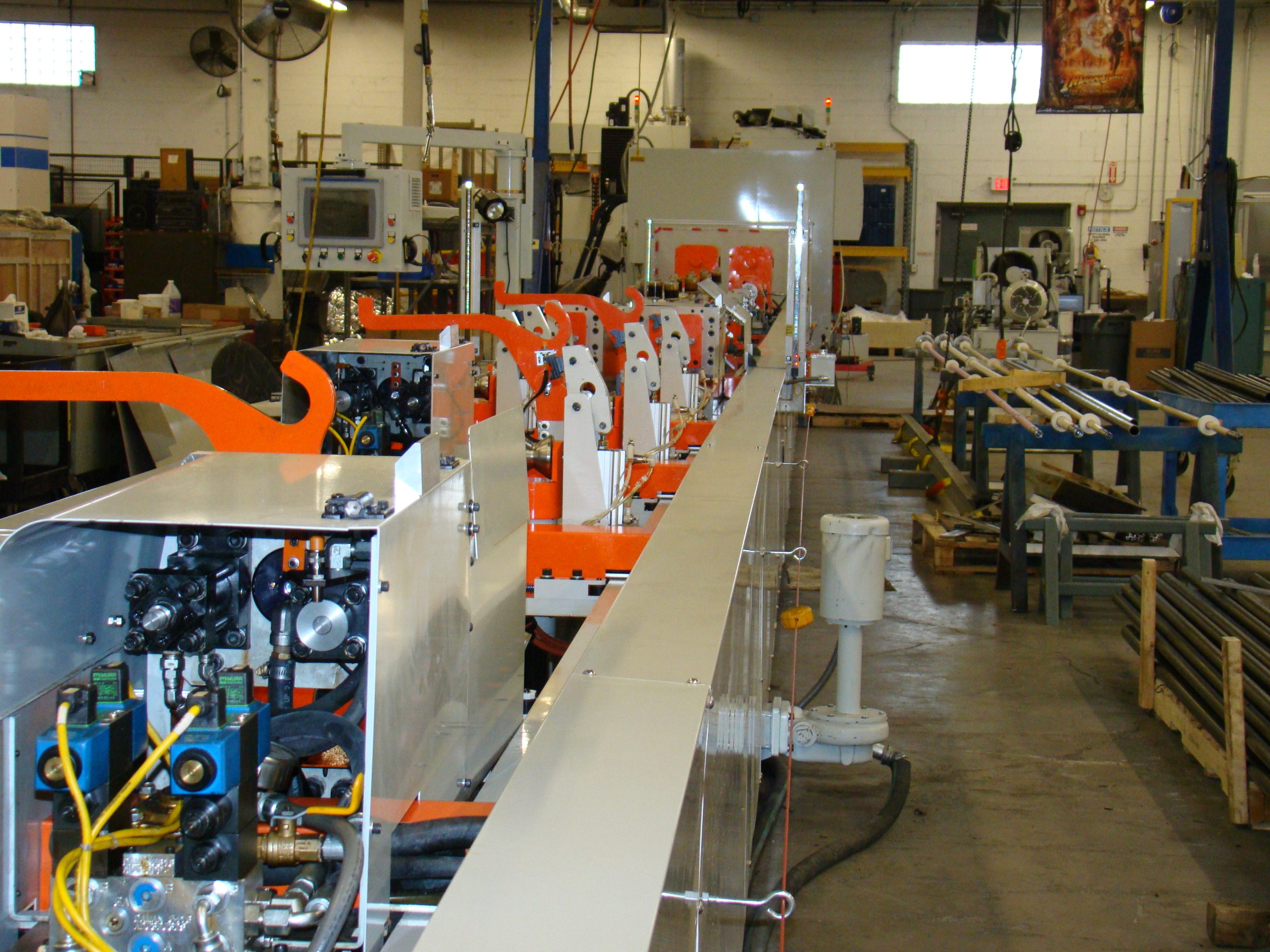

Another machine (pictured) being built to hone barrel rod tubing has an overall length of at least 80′ (24.4m) and 32′ (9.8m) of stroke.
