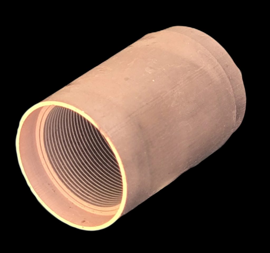

The activity covers three related but technically distinct application areas: overmoded waveguides, mode converter waveguides, and corrugated horn antennas. Each uses fine internal corrugations running perpendicular to the horn or waveguide axis to influence how electromagnetic waves propagate inside the device. These features can support functions such as propagation control, far-field pattern tailoring, and side-lobe suppression.
The focus of this announcement is the manufacturing capability itself, rather than the performance of any individual device. Ultimately, RF performance will derive from the component design and the ability to manufacture that design accurately and repeatably. Horizon’s progress lies in demonstrating an increasingly capable manufacturing route for sophisticated corrugated geometries.

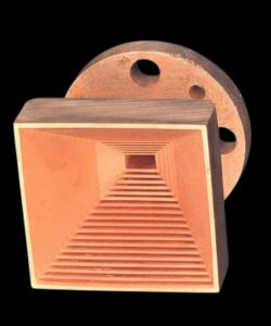

Overmoded waveguides have already been supplied for customer use and repeat use. Mode converter waveguides have also demonstrated success, with deeper or varying corrugation profiles representing a further step in manufacturing complexity. To put that challenge into perspective, at D-band frequencies (110–170 GHz), relevant corrugation features can be only around 250 µm wide while extending to approximately 500 µm in depth — dimensions that must be reproduced accurately around an internal geometry and then metallised consistently. Corrugated horn antennas are a larger industrial opportunity, particularly in sensing, radar, and selected satellite communications applications, but remain at an earlier stage of active exploration and application-specific refinement.

According to a company statement, Horizon’s work illustrates both dimensions of this manufacturing progression: the challenge of producing increasingly narrow corrugations as operating frequency rises, and the separate challenge of producing long, high-aspect-ratio geometries where conventional tool access becomes increasingly restrictive. Overmoded waveguides and mode converters have demonstrated the ability to manufacture extremely fine corrugated features, with characteristic dimensions in the 100 µm range, for devices operating at frequencies extending up to the D-band (170 GHz). Separately, development work on corrugated horn antennas is demonstrating the potential of the approach for longer, high-aspect-ratio geometries where conventional machining (and in some cases alternative additive or additive-plus-metallisation routes) becomes increasingly problematic.
Horizon’s approach tackles this manufacturing barrier. By precision 3D printing the geometry in high-performance polymers and then applying a specialist metallisation layer, the company can produce complex conductive corrugated structures without automatically defaulting to fully solid-metal fabrication. The significance of the polymer-metal hybrid approach lies primarily in the manufacturing freedom it creates. It provides a route around some of the geometric and economic constraints of conventional metal fabrication. Additionally, the metal-polymer hybrid nature of the device can deliver further benefits. Examples are lower heat conductivity in cryostat applications (e.g., quantum computing) or lower weight in on-the-move and otherwise SWaP-sensitive applications.

The opportunity extends across scientific instrumentation, electronics testing, sensing, high-frequency measurement systems, and selected space and radar applications. In antenna applications, side-lobe control can be critical, and in some sensor markets the pressure to control emitted power in unwanted directions is increasing. Horizon sees corrugated horn antennas as a significant potential application area, with its manufacturing platform enabling geometries to be tailored to specific RF requirements and then evaluated against the performance needs of the intended application.
