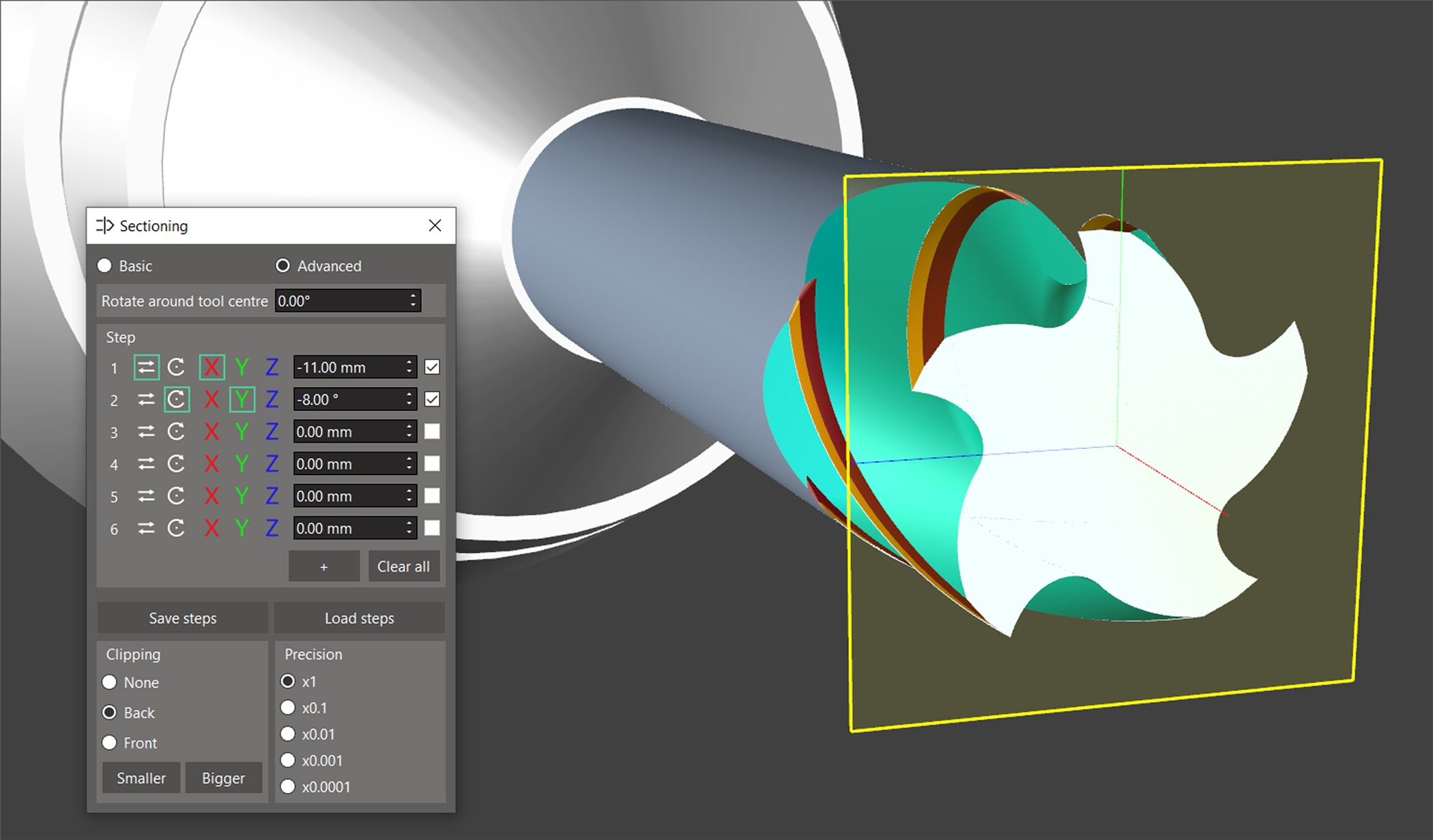

Recognizing the market need for adaptability to produce custom tools Riddiford highlighted the range of processes offered by ANCA that are targeted to increasing the “speed to get to the grinding point.” ANCA’s 3D simulation software generates a special profile offline, while the machine is still running and completing the previous jobs. The program is then downloaded to the machine, allowing ARCH to obtain better production of the first tool.

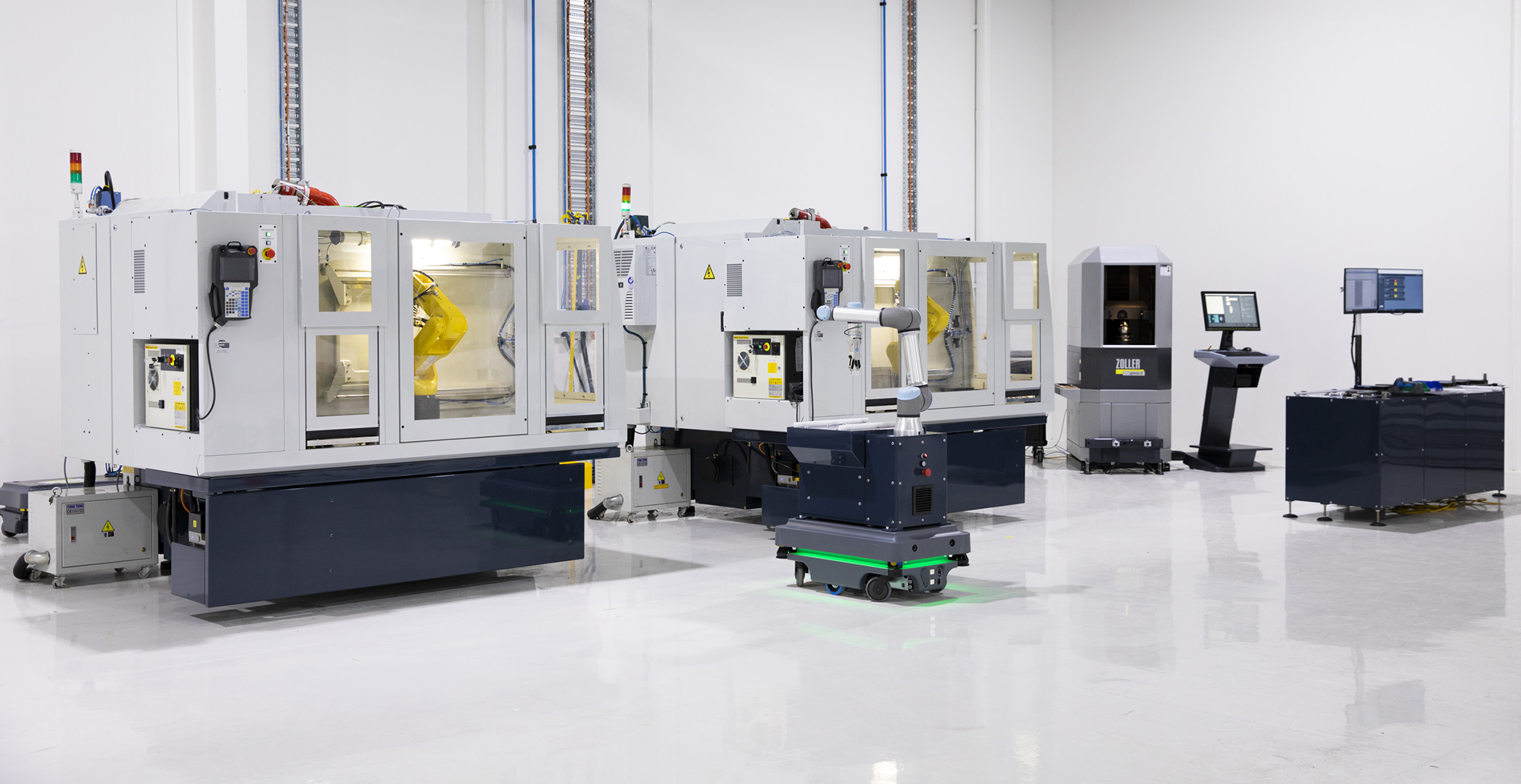

Both Cederstrom and Riddiford identified automation as another rising trend. From customers looking for more output, better quality and more productivity, to the social distancing requirements of COVID, to the gap in skilled labor; increased automation provides a solution to these challenges. To this end ANCA has developed AIMS (ANCA Integrated Manufacturing System), said Riddiford. “This is the ability to bring a stock piece of carbide at the front end and at the back end have a finished tool…without manual or operator input throughout the process. This allows end-to-end grinding.” Adding to ANCA’s product range is automated laser etching with the AutoMarkX, which fits with AIMS to complete the process. Riddiford added: “Some people might think of it as the future, but AIMS is here today.”
