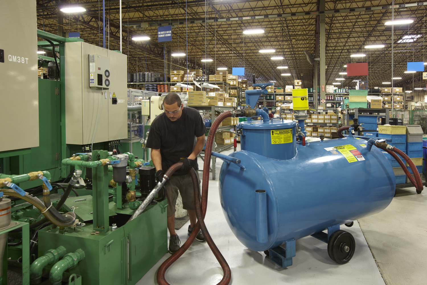

A sump cleaner filters the fluid it removes from the sump, making it possible to pump the filtered fluid back into the sump. This reduces both the need for new coolant concentrate purchase and disposal.The metalworking and metal forming industries have taken a leadership role in protecting the environment through an emphasis on fluid recycling and metal recovery. Shop managers understand fluid recycling can be an integral part of their process, just like tooling, inspection and everything else that affects their bottom line. In addition, other managers have developed systems that produce a revenue stream by recycling copper chips.

There is nothing that can be done to the coolant or added to the coolant to penetrate the sludge and kill the bacteria. It must be physically removed on a regular basis. Using a sump cleaner, a CNC machine tool sump with 50 gallons of coolant and 20 pounds of sludge can be completely cleaned in 10 to 15 minutes with the filtered coolant returned to the sump for re-use.
A sump cleaner filters the fluid it removes from the sump, making it possible to pump the filtered fluid back into the sump. This reduces both the need for new coolant concentrate purchase and disposal. Customers using a sump cleaner typically see a ROI in just a few months and continue to accumulate savings from that point forward.

For example, companies can achieve an excellent ROI with a simple sump cleaner instead of the traditional time-consuming methods used to dispose of fine particulates. A sump cleaner is a portable, powerful filter. It helps shops clean machines efficiently and is faster than using a Shop-Vac or shovel and rake. A sump cleaner reduces labor and downtime for cleaning the machine.
