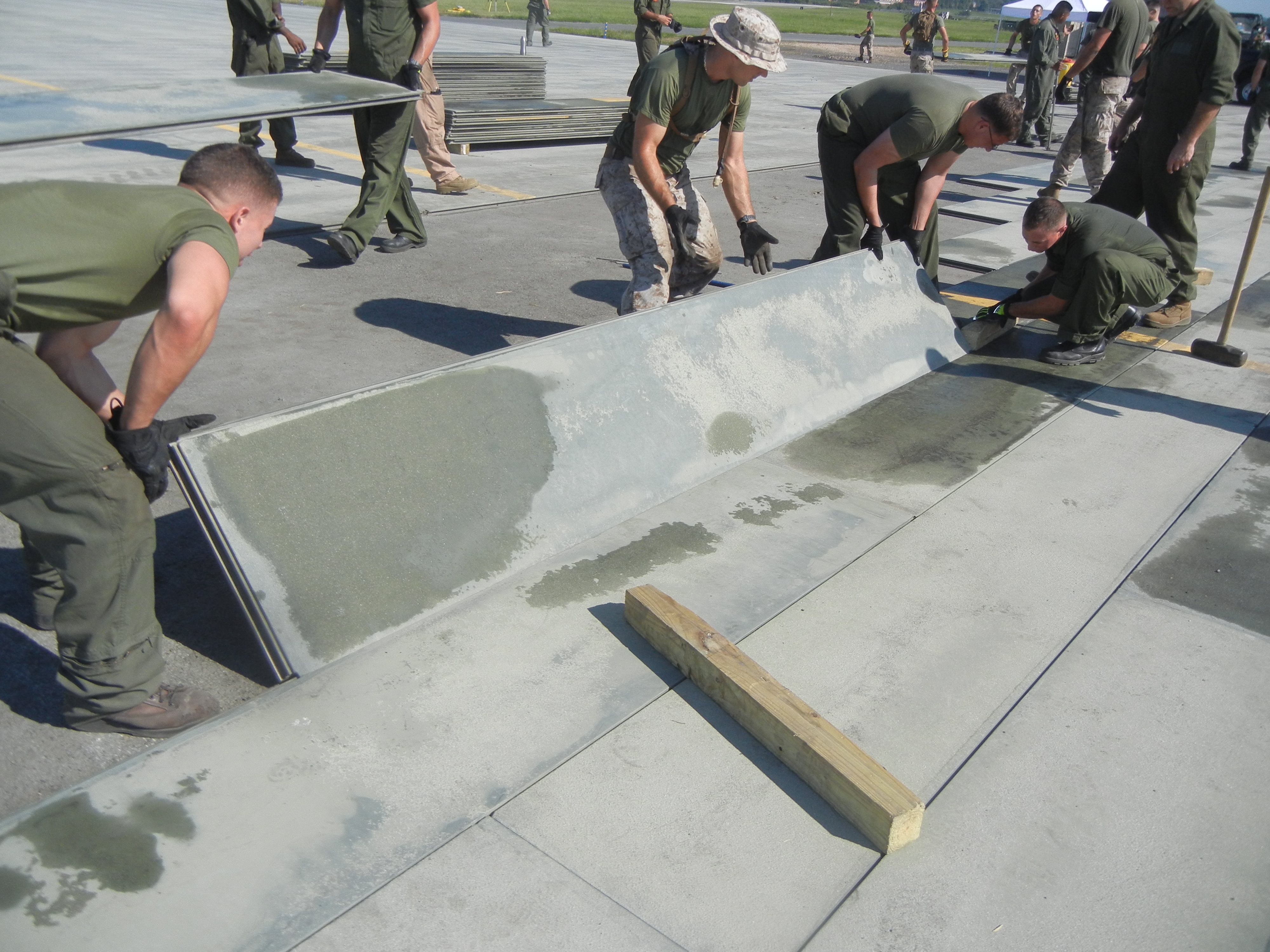

Marines from Marine Corps Air Station, Expeditionary Airfields, Marine Wing Support Squadron 274 put down AM-2 matting on the Delta taxiway at Quantico's Marine Corps Air Facility. ITAMCO will be replacing the labor-intensive AM-2 matting with a revolutionary product. Photo by John Holli
