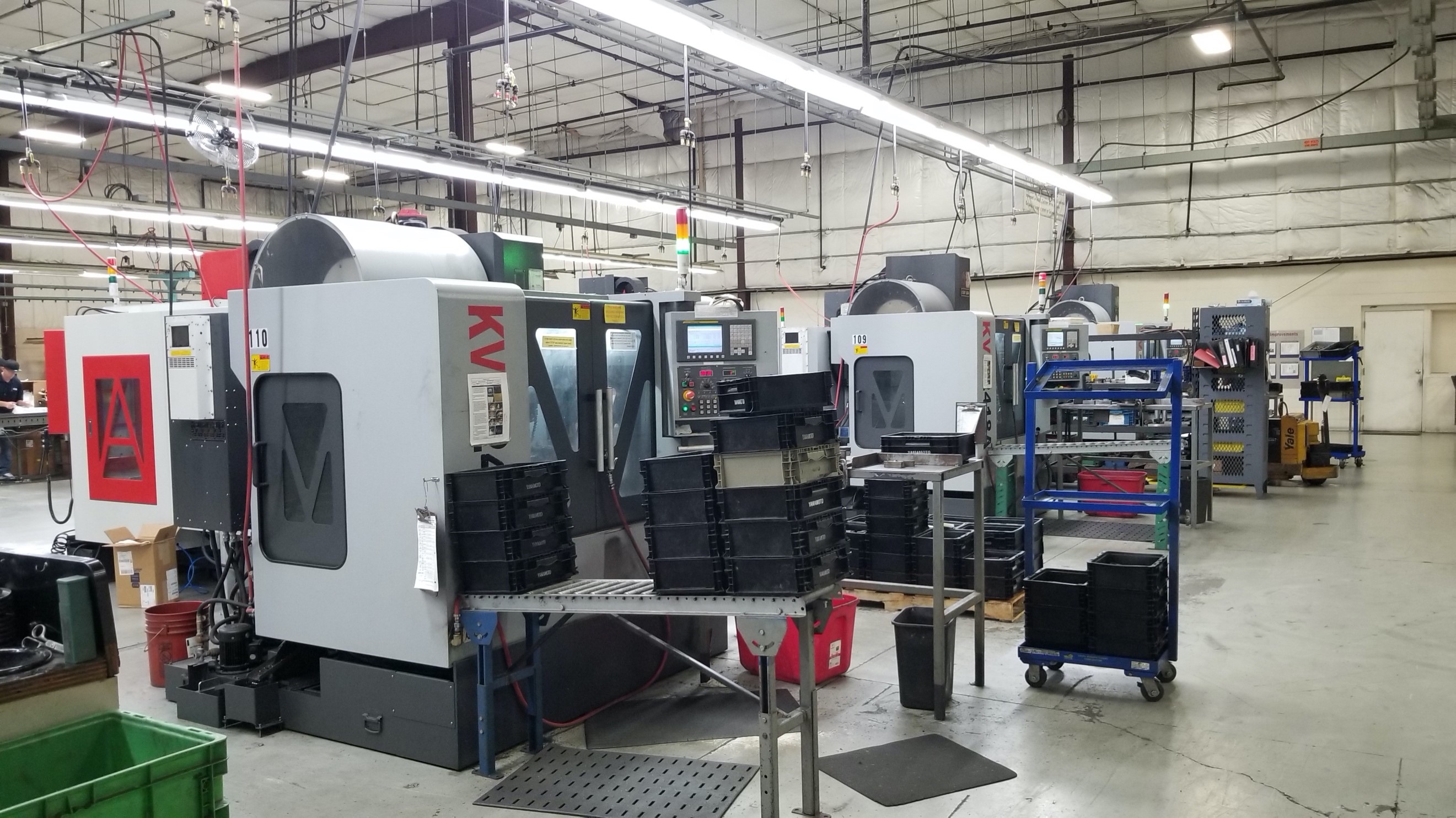

Miyama USA’s 50 employees serve a variety of automotive and appliance customers, with capabilities that include stamping, machining, robotic welding and precision assembly. All photos courtesy of Miyama USA

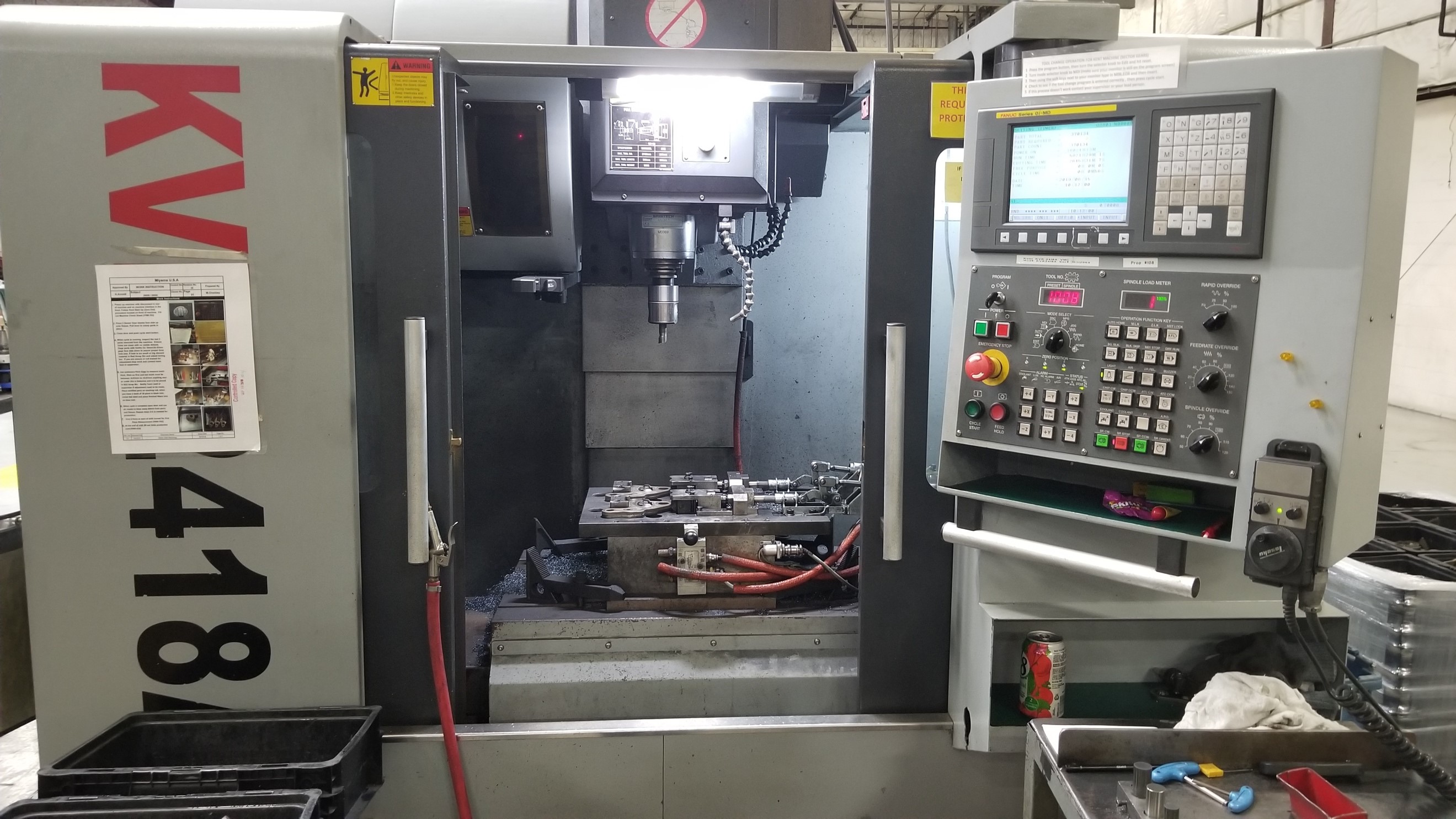

After winning the bid nearly five years ago on a long-term contract for an automotive seat gear, Overbay and his team were faced with tooling up for the big job, beginning with the purchase of three new CNC vertical machining centers. At first glance, the parts were small enough that a drill-tap machine seemed like it might be a more logical choice, but because each gear required semifinish and finish boring operations, Overbay knew that a 40-taper machine would be needed to accommodate the adjustable boring heads, each of which weighs close to 4 lbs.
Still, he didn’t want to sacrifice speed and accuracy. “When you’re a Tier 3 supplier, price per part is everything,” he said. “This presents a strong argument for finding the least expensive machine available, but we also needed one that was fast enough to meet our cycle time objectives, and able to consistently hold tolerances down to 20 microns (0.0007″) on a pair of holes.”
After evaluating several well-known brands of equipment, Overbay reached out to Glen Goins, president of Amerigo Machinery Co., whom he had known previously. “Glen’s been in this business longer than anyone and I trust him to stand behind his equipment; he’ll do whatever’s needed to treat his customers right,” said Overbay said. “He showed us a couple different options, but it was the KVR-2418 vertical machining center from Kent USA that we kept coming back to. Where everyone else makes you pay for a 12,000-rpm chilled spindle upgrade, a better control and other needed machine options, Kent USA includes those features as standard, and has a lower price.”

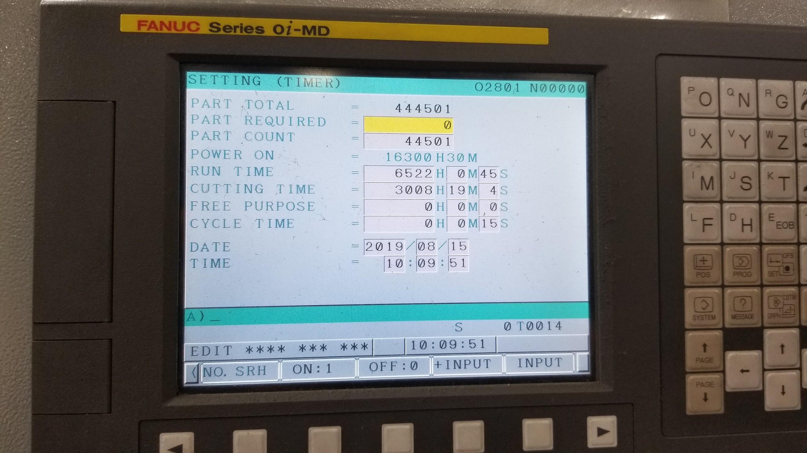

Check out the part total and power on counters on Miyama USA’s KVR-2418 vertical machining center from Kent Industrial USA.

Despite the price, the KVRs have proven to be extremely reliable. Each of the machines produces two seat gears every 35 seconds, and does so 16 hours a day, five days a week. With three tool changes per cycle, that comes out to nearly 1.5 million tool changes annually. “Aside from the routine maintenance to replace the tool pods every year or so — something that’s quite reasonable considering the high number of tool changes — we’ve had no appreciable downtime, and the only failures are when the operator accidentally stops the machine in the middle of a tool change,” Overbay said. “And after four years of moving to the exact same four points, we have almost no visible wear on the ballscrews.”
Tool life has also been exceptional. The seat gears are made of 400 series stainless steel that’s been heat-treated to 62 HRC, hard enough that relatively expensive PCBN cutting tools are needed. Due to their brittle nature, however, these tools require rigid, stable machining conditions if they’re to last as long as possible. The Kent USA KVR machining center produces up to 3,000 parts per tool, a figure that Overbay said they’re quite proud to achieve.

Miyama USA has achieved three tool changes and two parts every 35 seconds for four years running.

Because of this long-standing success, Miyama has since purchased two additional KVRs, bringing the total to four machines dedicated to seat gear production and one for general shop work. Overbay estimates the company has made more than four million of the automotive components so far, with all of the machines still going strong.
