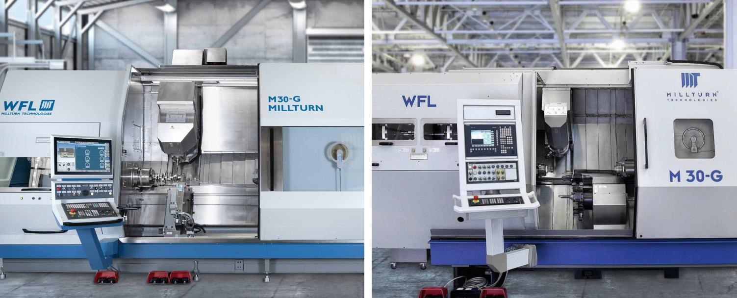

The M30 Millturn from WFL Millturn Technologies Inc. is one of the most popular and successful WFL machines in the extensive Millturn range. The classic Millturn complete machining centers ushered in a completely new era in their original version more than 25 years ago.
After all, this machine was the first WFL Millturn with an individual tool carrier for turning, drilling, and milling with a B-axis. Many of these old M30 machines are currently still in use. And when taken good care of, the oldest member of the Millturn family still delivers top performance even after many years. Ultimately, supreme quality and lasting accuracy are among the virtues of all WFL machines. We, therefore, decided to take the opportunity to take a closer look at one of these proto-Millturns.
Although the details of the current design have very little in common with its original version, the basic structure with the stable 60° slant bed is still there. Particularly noteworthy features include the powerful headstock with a 37 kW main drive and 2-speed gearbox and an external C-axis. Although the design dates back to the earlier Voest-Alpine WNC slant bed machines, it is still used in the latest Millturn models of the M35, M40, and M50 series with modernized drive motors. Water-cooled direct drives are available as alternatives nowadays.

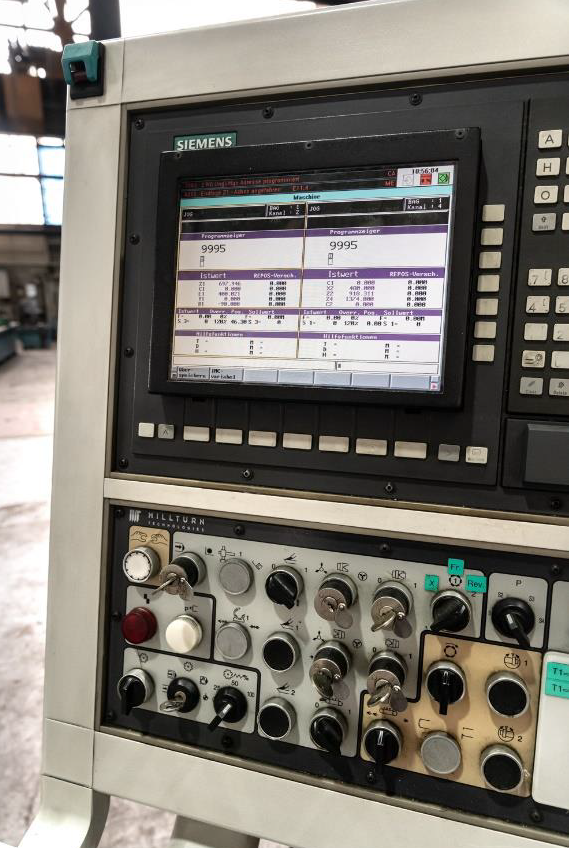

The Siemens Sinumerik 880T was initially used as the control system for the first machines. The data memories of this control system were still in EPROM form and were therefore only writeable and erasable with a special device. The newer machines made back then were then delivered with the Sinumerik 840 C. This version already had a hard drive for data storage.

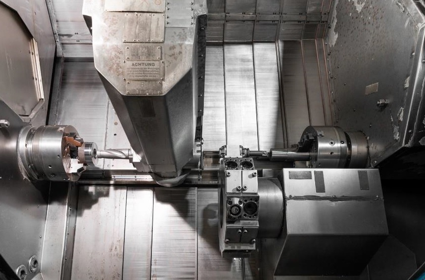

Depending on the configuration, the machine had up to 9 NC machining axes and could perform 5-axis interpolations. However, due to the lack of corresponding software solutions for the programming, this was a difficult and laborious undertaking back then. Thanks to the B-axis with 7.5 kW milling drive and 4,000 rpm, complex and highly precise oblique machining was possible with high productivity.
At the time, a new feature was the use of a compressor cooling unit to stabilize the temperature of the turning-boring-milling unit. This made it possible to perform lengthy milling operations with a high output. However, the high continuous speeds were the Achilles’ heel of the turning-boring-milling unit, because the permanent grease lubrication was simply not sufficient.
It was only with the newer models – which featured oil mist lubrication – that this problem was solved. But, so what, even back then it was possible to use large milling cutters and drills even for heavy roughing cuts since the milling unit achieved maximum performance even at lower speeds due to the gearbox design. When it came to turning, the machines were unbeatable anyway. The machines were predominantly used in the aerospace industry, the automotive sector, for hydraulic components, in the demanding field of mechanical engineering as well as in tool manufacture and medical technology. Typical areas of application were complex precision parts made of materials that are difficult to machine.
