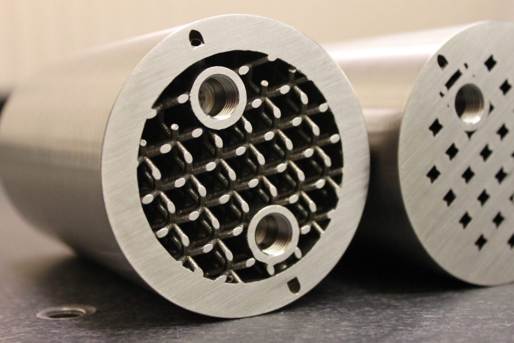

“We’ve really hit our stride in the last couple of years. In particular we’ve been able to separate ourselves by offering comprehensive hybrid manufacturing services that marry additive and subtractive techniques effectively,” Joest said. “Having extensive machining, welding and fabricating experience provides significant advantages since almost all metal additively manufactured items require some level of machining after they are ‘printed.’ Many additive shops and organizations simply can’t do this because they don’t have the robust machining background we have. Hybrid manufacturing is what’s unlocking the most innovative designs, not just additive on its own.”
(Editor’s note: Hybrid manufacturing refers to performing precision machining work on intricate additively manufactured components. Hybrid manufacturing captures the design freedom of AM and the precision of CNC machine tools.)
