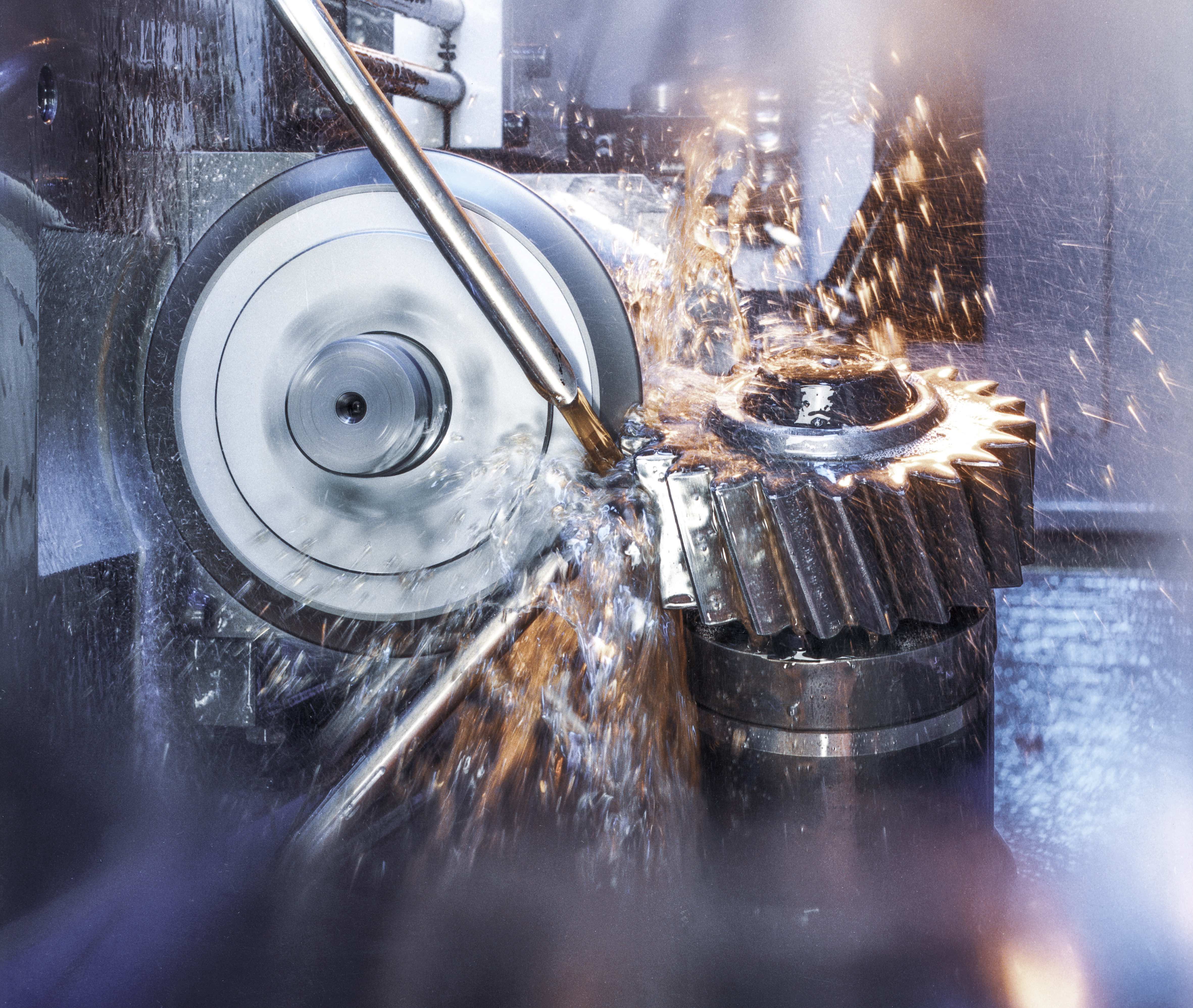

Figure 1. Example of hypoid planetary gear grinding, becoming typical in EV transmissions.It has become abundantly clear that not only are electric vehicles (EVs) becoming more prevalent on the roads, but that almost all automotive companies are announcing plans whereby EVs will eventually dominate their product portfolio.

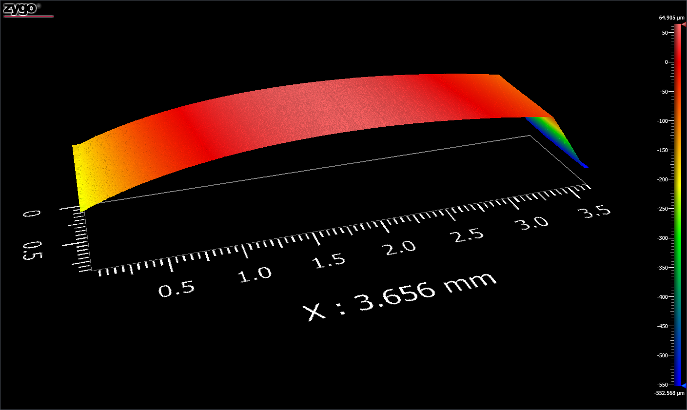

Figure 2. Example of non-planar stitching over a hypoid gear flank, from root to tip.Second, the sound from the IC engine typically masked the noise from the drivetrain. Efforts to dampen sound in the passenger cabin were designed into the vehicle frame and the passenger compartment. Yet, with the shift to electric engines, gear noise could again become prominent if it were not for a change to new manufacturing methods and processes.

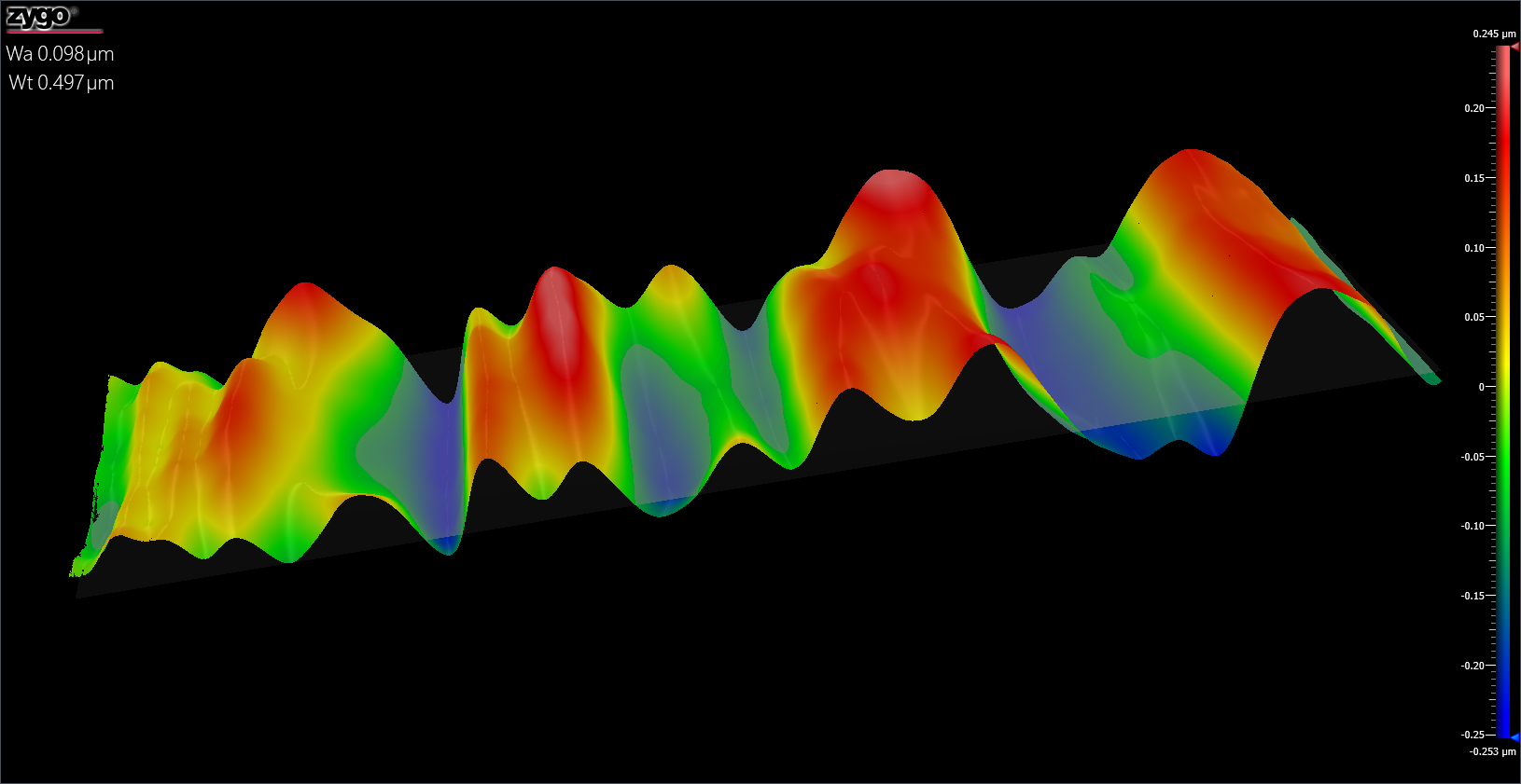

Figure 3. Processing of data for waviness allows engineers to visualize small fluctuations which may occur in part processing.But when achieved, specific techniques can produce gears in high quantities while attaining the required form and surface texture demands. One such method is continuous generating grinding that utilizes threaded wheels, which remain in constant contact with the developing gear tooth structure (see figure 1). This method, among others, has been proven to produce the essential gear texture and waviness specifications to improve gear tooth interaction while reducing contingent noise.

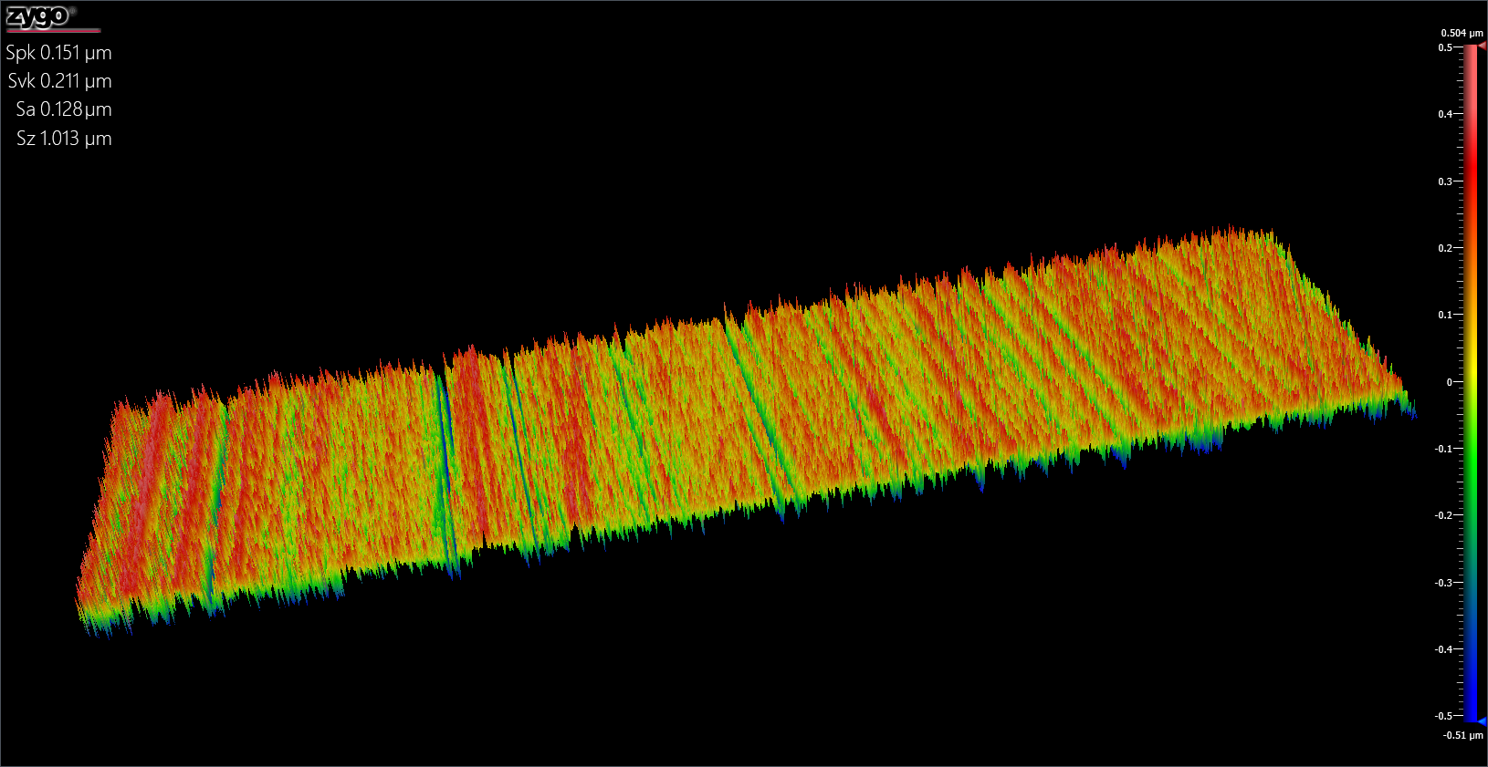

Figure 4. Gear flank roughness plays a key role in lubricant film retention as well as making surfaces more durable.At the heart of Zygo’s optical metrology solutions is its coherence scanning interferometry (CSI), which uses specialized optical microscope objectives that provide the imaging and magnification of a surface and measure the 3D topography of the surface. CSI profiling is entirely non-contact and, in contrast with other microscope-based 3D topography techniques, CSI has the distinct advantage that the height resolution of the measurement is consistent across all magnifications, whether the magnification is 1x or 100x. This presents a unique opportunity for CSI-based systems as the shape and size of the gear may limit the types of objectives able to gain access to the area of interest.

Another key driver built into Zygo’s solutions is field stitching. With some similarities to panoramic photography, a user can set up a measurement to capture more area than the installed objective. This creates a matrix of overlapping measurements, when done acquiring, are ‘stitched’ together to form a larger measurement than a single objective can accomplish. Where this is advantageous in gear metrology is the acquisition of surface texture along a gear flank, from edge to edge, or stitching from the gear root to the tip, traversing over the involute shape. What should be emphasized is the ability to perform these stitched measurements over non-planar surfaces, such as hypoid-shaped surfaces. By programming the start and end positions of the measurement sequence, a user can re-measure a hypoid gear with continuous high precision because of Zygo’s proprietary stitching algorithms.
