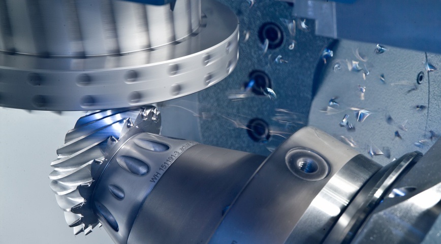

Dry machining has conquered the field of gear manufacturing, as predicted. Photo courtesy of Klingelnberg.
Gear hobbing now exclusively dry
“The advantages of MQL over wet machining lie in the lower costs for the cooling lubricant and the elimination of chemical additives in the lubricant. This results in cost advantages, and also fewer adverse health effects for the employees,” said Dr. Hartmuth Müller, head of technology and innovation at Klingelnberg GmbH’s Hückeswagen production site. The mechanical engineering company, headquartered in Zurich, employs around 1,300 people worldwide and specializes in bevel and spur gear technology.
“The principle behind MQL is based on wetting the rake face. This is easy to achieve with internally cooled tools, while it is not feasible with the complicated tool geometries of gear cutting tools. For this reason, Klingelnberg relies exclusively on dry machining for gear hobbing. We only use MQL when machining cast components for use in engineering,” he added.
Tungsten-carbide bar cutting tools are deployed for bevel gear milling. For cost reasons, tungsten-carbide tools are not widely used for spur gear milling; dry-cut PM-HSS hobs are generally used for this purpose. The subsequent hard finishing of gear wheels is carried out – whenever possible – by grinding, using oil as coolant lubricant.
“Dry machining has definitely triumphed in gear manufacturing, as predicted,” Müller said. “Thanks to developments in cutting materials and coatings, cutting speeds are up to five times higher than they were with wet machining 20 years ago. Dry machining has not only led to a considerable increase in productivity, but also to cleaner production.”

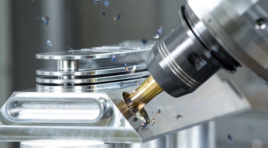

MQL offers several advantages. Photo courtesy of Horn-Sauermann.
MQL offers several advantages. Photo courtesy of Horn – Sauerma
Cost-efficient and environment-friendly
Hartmetall-Werkzeugfabrik Paul Horn GmbH from Tübingen, Germany, is one of the leading tool manufacturers. “MQL has replaced conventional coolant lubricants in some machining processes,” said Managing Director Lothar Horn. “Cooling and lubricating using minimum quantity lubrication offer users a number of advantages. This has led to MQL being used in many machining operations, particularly in series production. This type of cooling reduces the high costs in the maintenance, preparation and disposal of conventional coolant lubricants. In addition, it eliminates the energy costs for the high-pressure pumps and feed pumps required for returning lubricants to the collection basin. In addition, the government is imposing stricter requirements on coolant lubricants with regard to hazardous ingredients. In spite of the advantages of MQL I just mentioned, conventional coolant lubricants are indispensable in production facilities. Many processes – such as drilling, machining of high-temperature alloys, or internal machining with high chip-removal rates – require an adequate supply of conventional cooling lubricant.”

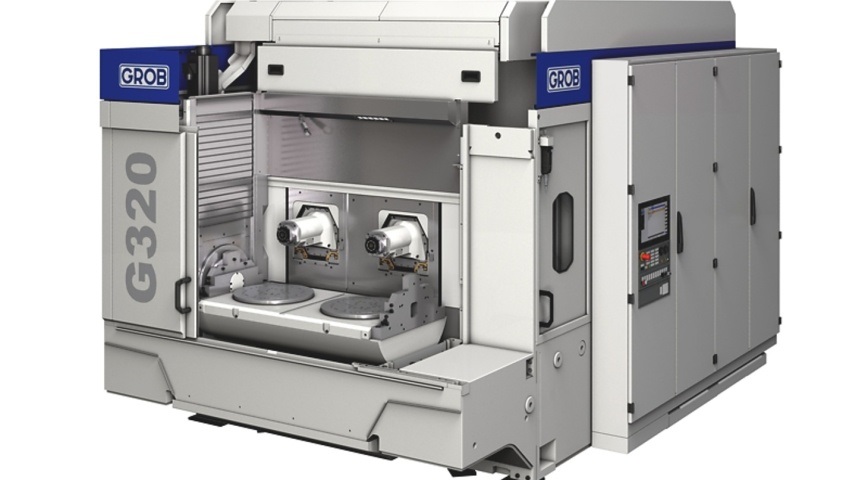

The G320 twin-spindle machining center permits efficient production of automotive components. Photo courtesy of Grob-Werke.
Planning dry machining correctly
“In Grob machines, dry or MQL machining is used for processes with a geometrically defined cutting edge such as drilling, milling or roughing,” said Jochen Nahl, CSO of Grob-Werke GmbH & Co. KG from Mindelheim (Bavaria), Germany. “Typical workpieces are frame structure or chassis parts, combustion engine and drive train components made of aluminium or gray cast iron, and now also turbocharger housings made of highly heat-resistant cast steel. Wet machining is still very much part of the DNA of many companies, yet the share of MQL machines has already increased to 12% in recent years and is continuing to rise, especially for the machining of frame structure and chassis parts.”
The family-owned company has a total workforce of around 6,900 employees worldwide and has been a pioneer in the construction of highly innovative production and automation systems for more than 90 years. “The advantages of MQL machining speak for themselves,” Nahl added. “Production line investment costs can be lowered and the effort involved in cleaning the workpieces can be reduced significantly. In addition, MQL uses around a quarter less energy compared to wet machining.”
Although dry machining is not currently being deployed to the extent that was expected, it is clear that industry is gradually accepting it. “If the benefits are to be reaped, any switch from wet to dry machining should be based on an intelligent strategy and implemented with a competent machine supplier as a partner,” Nahl said. “Modern companies are already benefitting from recent positive developments such as temperature compensation, the use of higher air pressure levels, and modular systems that reduce manufacturing costs and avoid unnecessary over-engineering.”
