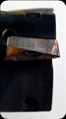

Note the wear pattern on this insert after 93.435 cu. in. of material removal using a standard retention knob.

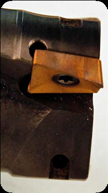

An insert after 186.867 cu. in. of material removal using a High Torque retention knob shows significantly less wear.

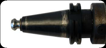

Identifying toolholder expansion can be achieved by simply looking at the wear patterns on the toolholder itself. Wear marks at the small end or at the gauge line, with no wear in between, are a clear indication of toolholder
expansion.

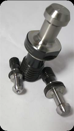

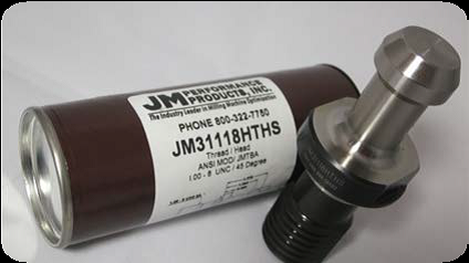

JM Performance Products has been spearheading the charge to overcome this “spindle-to-toolholder” relationship production obstacle–by directly addressing the inherent flaw design in V-flange tooling with the company’s patented “High Torque” or lower-deformation retention knobs. The essential element of the design is a knob that is longer and reaches deeper into the holder’s threaded bore. As a result, all thread engagement occurs in a region of the toolholder where there is correspondingly more material to resist deformation.
Additionally, High Torque knobs feature a precision pilot to increase rigidity, and a relief below the flange that forces threads into a deeper cross section of the toolholder. These design elements eliminate the toolholder expansion responsible for costly and ongoing CNC milling and boring issues.

Fretting marks on the small end of the toolholder and on the gauge line.
