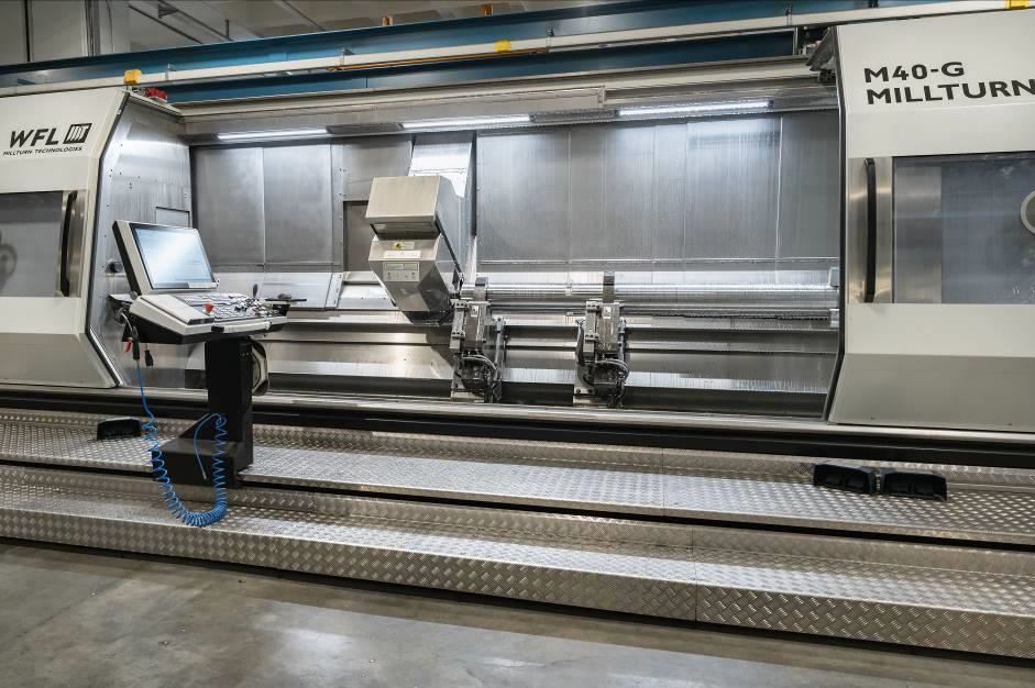

Mikrosan is using an M40-G Millturn with a 4,500 mm center distance and a swing of 520 mm for screw manufacturing. Important for Mikrosan's decision for the WFL was the superior output and torque values of the spindle drives.
"The advantage of the WFL machine is the chuck and the tailstock function of the counter spindle. The size is perfect for us, because of the long center distance and the strength of the machine. It can easily handle different screws and barrels. The power of the turning spindle with up to 54 kW and the milling spindle with 33 kW was also an important point for us. WFL was from the very beginning the right partner. As far as communication is concerned, we had just one face, one contact person that we gave all the feedback within the project execution. So, the process was very easy for us", Abdullah Demirci is describing.
The WFL is used for high precision machining operations as well as for pre-machining for screws and barrels. Middle-sized to big-sized screws are done on the WFL. The range size of screws machined on the WFL starts from just 90 mm in diameter.
With the WFL machine, Mikrosan achieves the manufacturing of a screw in only one clamping. The longest part ever produced on the machine was approximately 4000 mm. The usage of nitriding steels, with a DIN Norm of 1.8519/1.8550, is the industry standard of the market. Screws are normally made of 1.8519/1.8550 and barrels are made of 1.8550. After machining the workpieces they need heat treatment to harden the surface. In another step nitriding needs to be done, otherwise, the parts would have a very short lifetime.

For screw machining special steady rests are required because the parts are very slender. The length/diameter ratio is up to 40/1, so a special machine structure is needed, otherwise, there would be a risk of vibrations and the required good surface quality could not be achieved. For a good surface quality, it is also necessary that the clamping and workpiece support is very stable, and steady rests must be capable to move during machining operations. While moving the milling head, the steady rests are moving simultaneously, everything is synchronized with the milling head. This is a great advantage.
