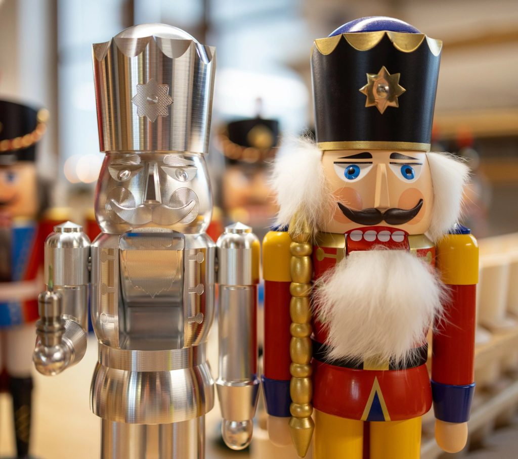

Open Mind, the developer of hyperMILL CAM software, created a replica of a famous nutcracker from the Erzgebirge a region in East Germany. The example is milled from aluminum and demonstrates an end-to-end digital process chain and efficient 5-axis machining with hyperMILL.
Together with Emuge-Franken, CAD/CAM developer Open Mind set itself a task: Digitally reproducing a 40-centimeter tall nutcracker as accurately as possible and mill it from aluminum as efficiently as possible. The traditional Seiffener Volkskunst nutcrackers provided the wooden figure, which was handcrafted in around 150 steps and consisted of around thirty individual parts.

Production was carried out at Franken’s Rückersdorf application center on a Hermle C32 machining center in a single clamping operation using 5-axis and 5-axis simultaneous processes. This allowed the surfaces to be machined continuously without segmentation.
Top: CNC-milled aluminum nutcracker and its wooden counterpart. Above: CAD/CAM model and milled part: legs and body part of the aluminum nutcracker.​​​​" data-entity-type="file" data-entity-uuid="74601764-1bad-4580-8abe-4d435ad54435" height="220" src="/wp-content/uploads/legacy/inline-images/csm_nutcracker-legs-body_ede5b7bf23.jpg" width="329" />The opening cut for the large central pocket of the upper body was efficiently achieved using 5-axis helical drilling, which enables a particularly high level of material removal and is also gentler on the tool than a helical plunging movement. Strategies from the hyperMILL MAXX Machining high-performance package were used to optimize roughing operations. The 5-axis rest machining function then ensured that the roughing was completed safely and efficiently.The new EvoGrip centric clamp from Emuge was used for workpiece clamping. With its modular and slim system design, reliable clamping was guaranteed.Finishing with circle segment end millThe 'high-precision surface' mode was used for finishing, whereby hyperMILL® generates tool paths on the actual CAD surfaces and not on a calculation model. The large surfaces of the nutcracker that are curved in two directions, lent themselves to the use of FRANKEN's circle segment end mill in various shapes. For this application, taper and teardrop shape tools with cutting radii from 200mm to 1000mm were used. These tools, also known as barrel cutters, enable particularly efficient production of high-quality surfaces despite the large in-feeds or large step-over line increments. hyperMILL® offers optimum control of the cutting edge area of circle segment cutters.Simulation and optimization in the virtual machineModern interpretation of the nutcracker with tool holder and tool
