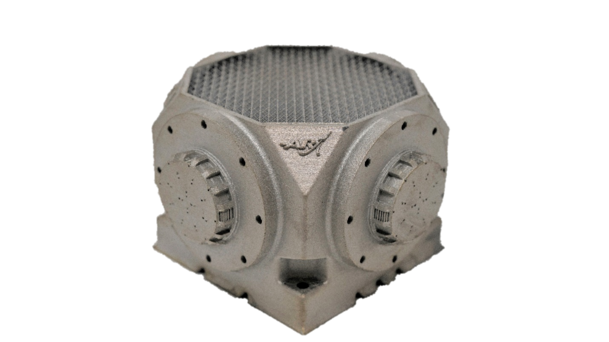

Here again, metal AM was the answer, as it allowed the team to print special injector geometries that could stably burn the fuel. They soon designed and built a concept model from the nickel-based superalloy Inconel 718, but unfortunately, ran into limitations with their metal 3D printer.
"We had to build the RCS injector body at a 45-degree angle, due to overhang concerns, and also add in a series of large support structures to prevent thermal warping during the build process," Horton said. "The supports would need to be machined away afterward, adding cost to the product, while the orientation angle created less than desirable surface quality. There was room for improvement."
At the same time, they realized there was room for substantial lightweight and topology optimization. Horton noted that they'd eliminated "large chunks" of unnecessary material during the redesign, but it was far from perfect. "Every single pound of material you can remove from a spacecraft saves money on launch costs," he said. "That's why we turned to nTopology for help with optimizing the design, and then Velo3D to build it for us."
Shell, fill and print again
Technicians from New York-based engineering and design software company nTopology were quickly able to "shell out" the injector body's blocky structure, leaving consistent wall thicknesses around the complex fluid ports and channels while eliminating stress concentration areas.
They then filled the resultant void with a thin lattice structure, increasing its strength and stiffness while adding only minimal weight; because of its "implicit modeling" capabilities, nTopology was able to cut the quad injector's mass in half.
Design iteration
The Aerojet Rocketdyne team sent the optimized part file to Velo3D's facility in Campbell, Calif. It was there that the metal AM solution provider gave Horton some good news.
Due to the company's mastery of 3D-printed titanium—a metal favored throughout the aerospace industry for its strength and lightweight—the RCS injector body would weigh much less than its Inconel counterpart. And as Velo3D technical sales engineer Gene Miller noted, there'd be no need to build it at an angle or use the big, blocky supports as in the first iteration.
"Our proprietary, pre-print software is intuitive enough to recognize different geometric features and apply specific laser parameters to those areas so that they print as efficiently as possible and without the need for added support material," Miller said. "In addition, we're one of the few metal AM system providers that can successfully print large complex titanium parts without cracking. We have a unique solution to mitigate accumulated internal stress within the printed material, and can avoid cracking more so than other printers on the market."
3-d printed part
The final result? Aerojet Rocketdyne now has an RCS thruster that is 1/5 the mass, 1/2 the size, and 1/3 the cost of a conventionally manufactured version.

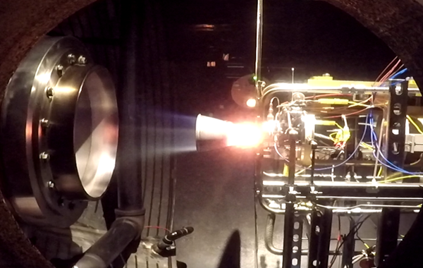

And since it contains far fewer components, it's also easier to assemble, with much less chance of failure during operation. Said Horton, "We've shown that by leveraging additive manufacturing and advanced software technology, we're able to interject affordability, reduce lead times, and greatly improve upon system performance compared to the way we built parts in the past. Our next step is to demo this proof of concept, bringing it into actual field testing and, hopefully, final qualification. From there, it's headed into space."
