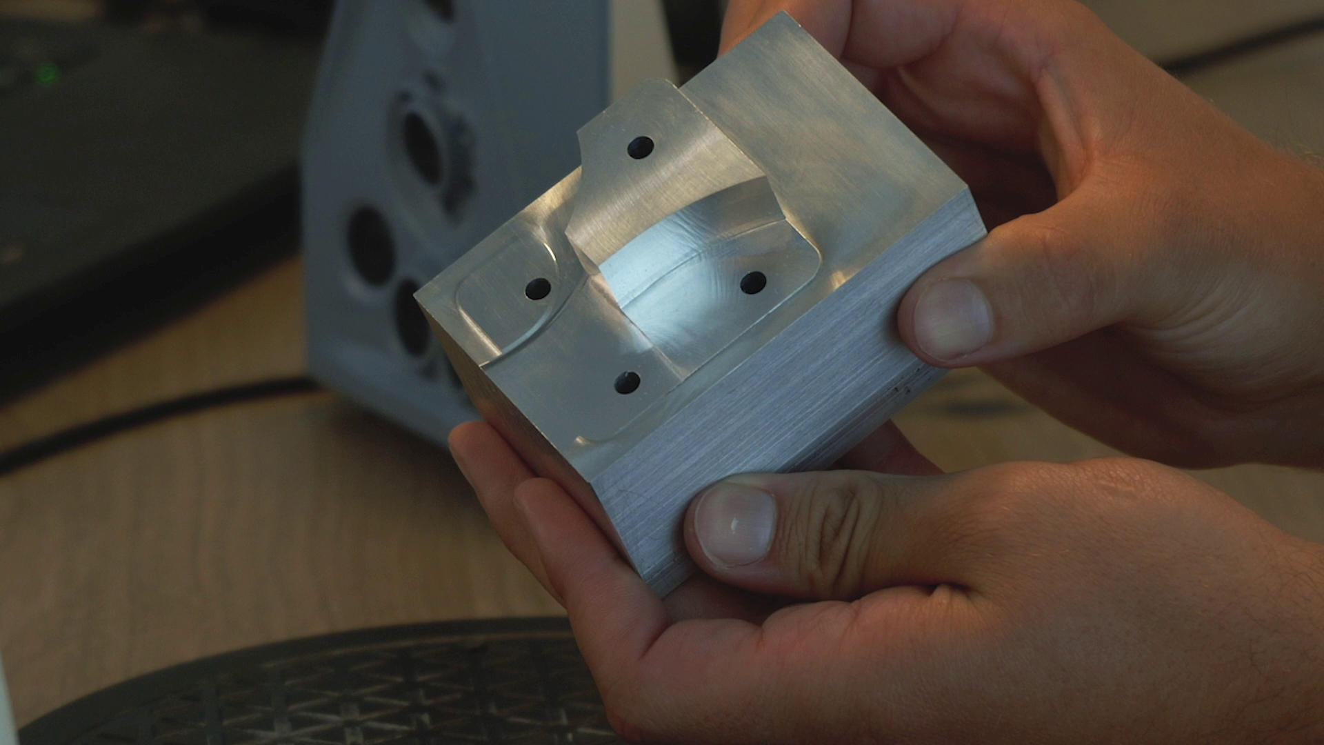

Shiny part challenges
Top and above: The shiny surfaces of the metal block can barely be captured by a scanner.
Material costs for 3D-printed parts are high, so the machining allowances are kept small. The milling process has to be extremely precise. Capturing the freeform surfaces, however, is more complicated than with standard milled parts. Added to this is the fact that castings and 3D-printed parts are frequently shiny, and in some cases have deep recesses. These surfaces cannot be fully captured by many scanners. Here, it is helpful to mat the surfaces with a scanning spray, for example from AESUB.
With the spray, shiny metal surfaces are matted in a few seconds and can be measured immediately. The scanner can fully capture the matted surfaces, leading to faster availability of reliable workpiece data. In particular with small production runs and prototype production/first article inspection, scanning sprays help to speed up measuring, and thereby the machining processes, and avoid wastage.
Recommended here are sublimating scanning sprays that completely vanish after a short time and thus remove the need for subsequent cleaning of the workpiece and machine. AESUB currently offers three sprays with different sublimation times.

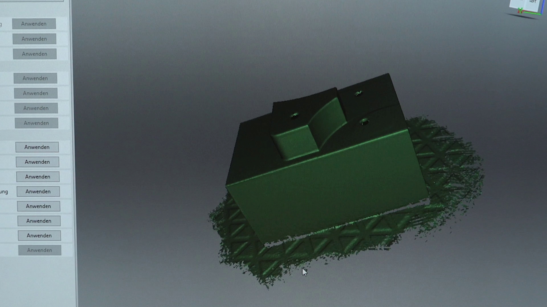

Without Scanningspray: The shiny surfaces of the metal block cannot be shown.
1. Measure shiny and reflective surfaces faster; accelerate the machining process
Workpieces are matted within a few seconds, thereby generating high contrast values, so that the measuring process can start immediately.

Even sprayed layer
With Scanningspray: Metal block was sprayed with AESUB blue. All the surfaces are now easily visible.
With Scanningspray: The metal block was sprayed with AESUB blue. All the surfaces are now easily visible.
To achieve a homogeneous sprayed layer, the sprays have to be very fine and be applied without any drops forming. With inferior sprays, reliable measurement results are impossible owing to the uneven application. If the sprays are too liquid, then drops and puddles form, whereas if they are too viscous, then the material is applied too thickly. As a result, the measurement results become distorted.
The scanning sprays from AESUB can be applied very finely and evenly. Depending on the AESUB spray variant, the layer thickness is between 0.5 and 15 µm.
