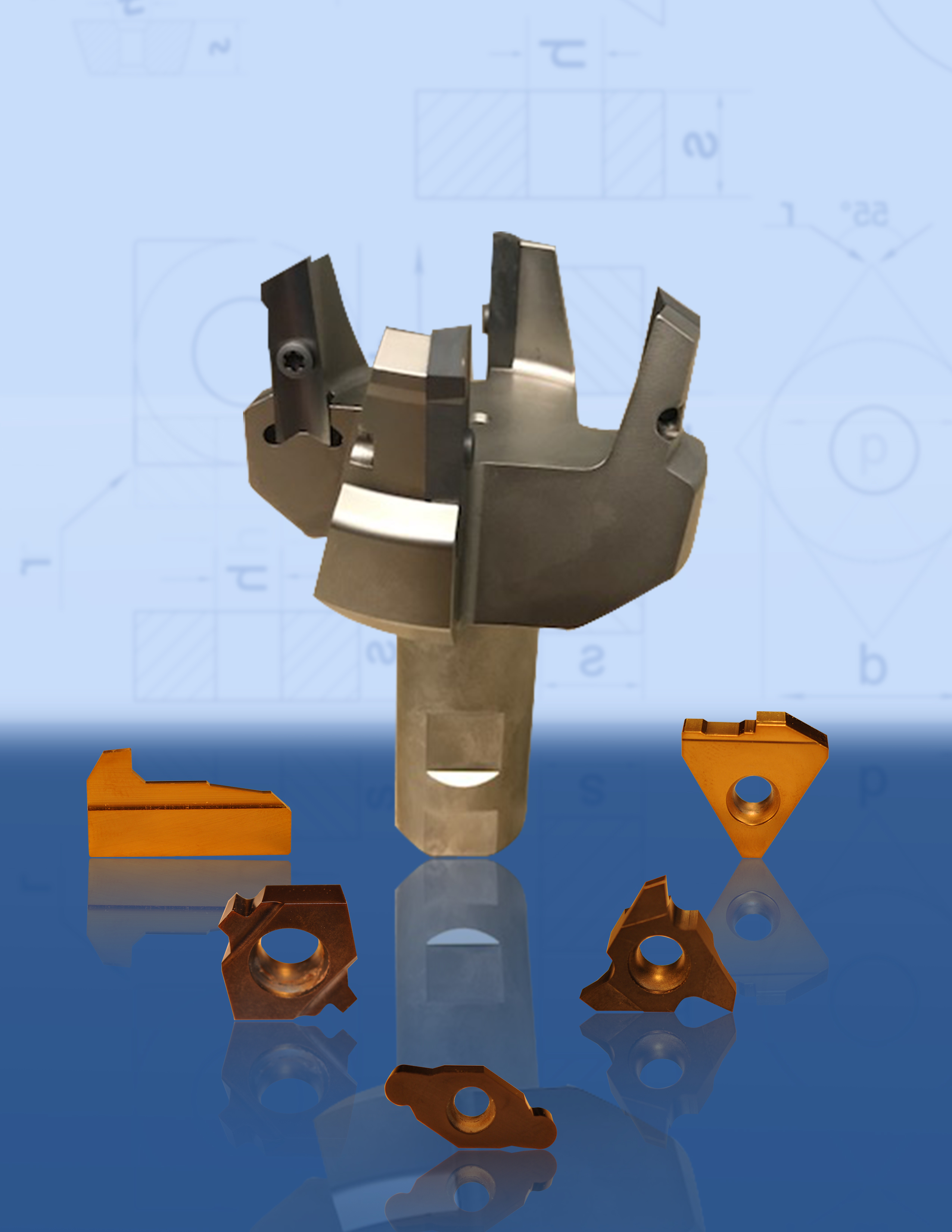

A custom toolholder and custom inserts. Image courtesy of Knight Carbide.
