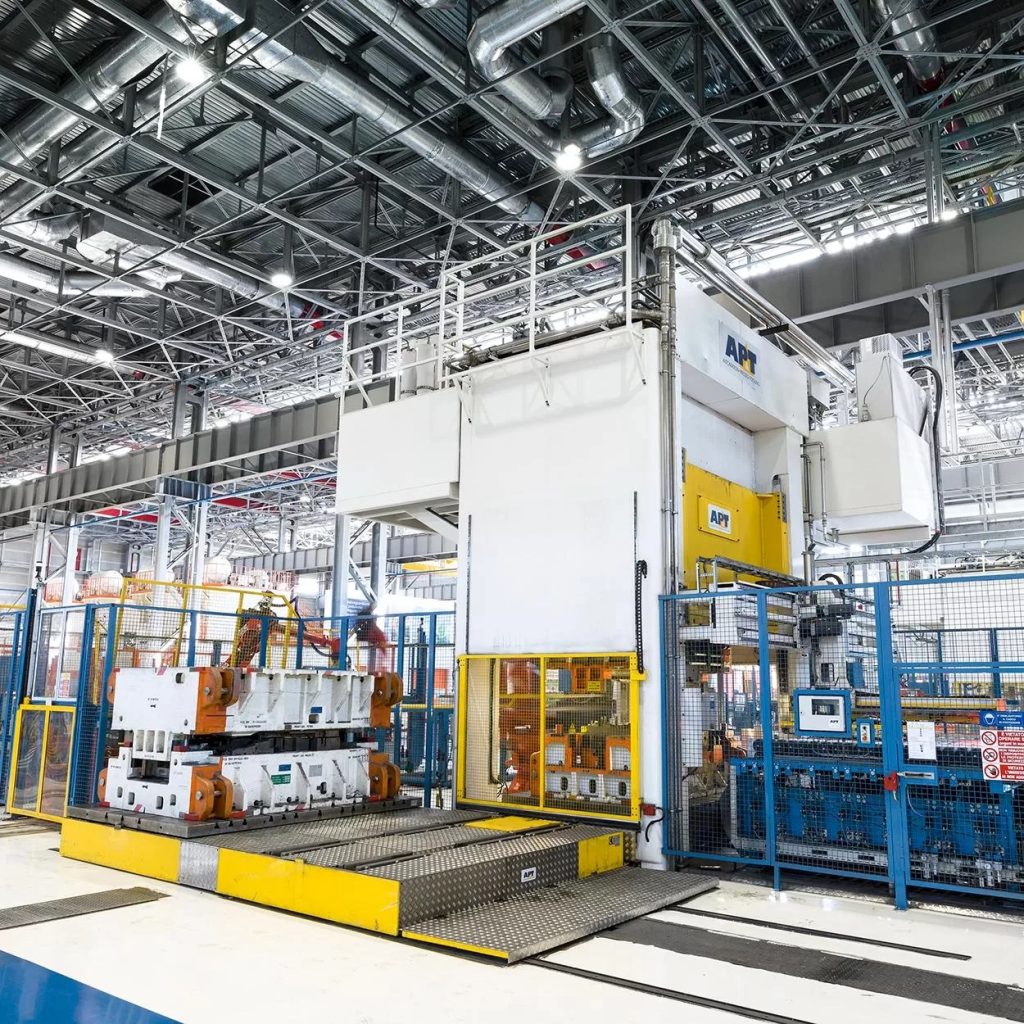

How can you get the most out of an existing press-hardening line? According to AP&T, a company that develops high-performing production solutions for the sheet metal forming industry, when updating a press-hardening line there is significant potential to shorten cycle times and increase production.
“It's not uncommon that we conclude that cycle times can be reduced by about 20% or more,” said Jan Larsson, experienced press-hardening expert and currently responsible for developing AP&T's aftermarket business.

Fiat Chrysler Automobiles (FCA, Stellantis) is one of the customers who has increased their productivity by allowing AP&T to optimize the company’s press-hardening lines.
FCA based in Cassino, Italy, invested in five complete press hardening lines from AP&T more than ten years ago, it was AP&T's largest deal with a customer in the automotive industry at the time, and it was the start of an innovative, open-minded collaboration that paved the way for continuous optimization of manufacturing processes, shorter cycle times and increased productivity.
