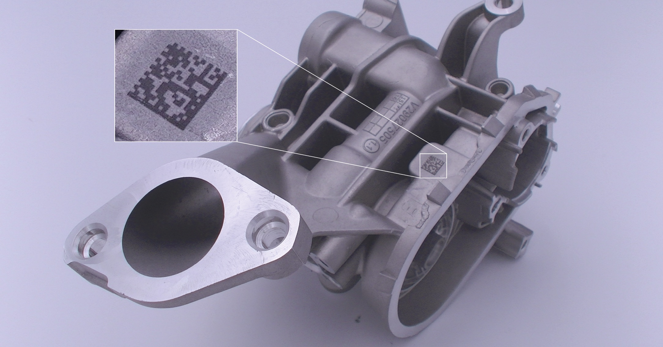

Among these challenges was a particularly complex request from a major Japanese player in the automotive sector who wanted a station dedicated to marking Datamatrix codes on power steering components. The solution had to withstand a constraining environment (humidity, dust), fit into a small space and adapt to different part numbers. SIC Marking was able to offer a compact customized station equipped with an HD laser automatically controlled on 2 axes, for fast and high-contrast marking. It is protected by a dust and moisture protection system, making it easy to integrate into a difficult industrial environment.
In another application, SIC Marking worked with a major German equipment manufacturer to mark a 7 x 7mm DMC code on air conditioning compressor pistons to facilitate their internal traceability. These codes needed to be marked deep enough to allow proofreading even after shot peening and tinning. All this in reduced cycle times. After various marking tests carried out by SIC Marking dedicated project experts, the chosen solution was a 50W fiber laser, its power enabling it to carry out deep marking in record time.
