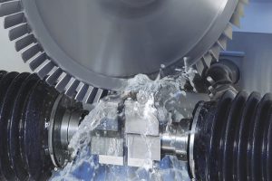

Imagine a machining process that removes material five times faster than milling and 10 times faster than sinker EDMing, machines Inconel and hardened steel with ease, holds tolerances to ±0.0006" and utilizes the same tool to process thousands of parts with virtually no tool wear. Machine builder EMAG LLC USA, Farmington Hills, Mich., calls this process pulsed electrochemical machining (PECM). A subset of electrochemical machining, PECM is far more accurate than the decades-old ECM and has matured into a viable alternative to more-traditional machining processes over the past few years, according to the company.
