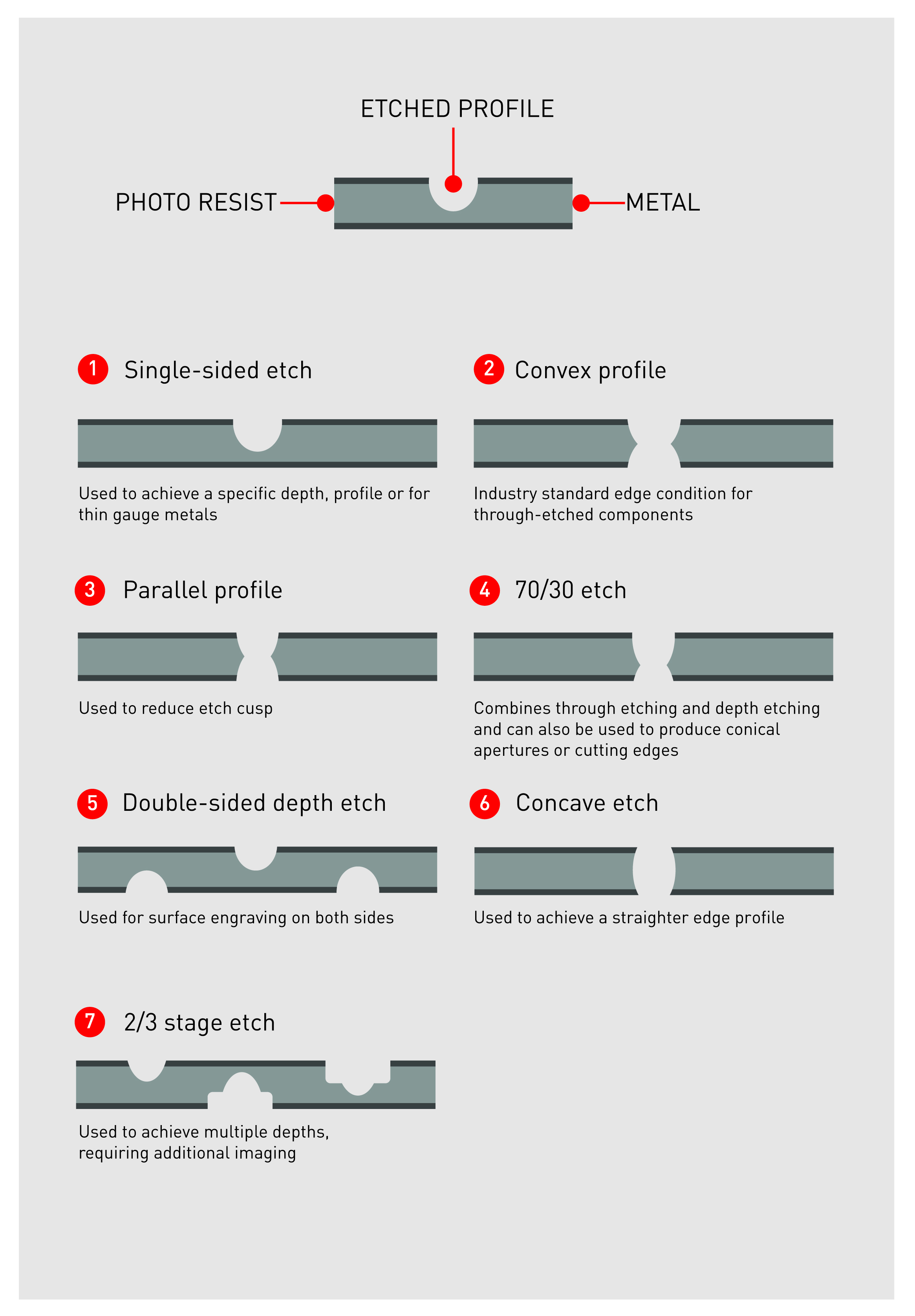

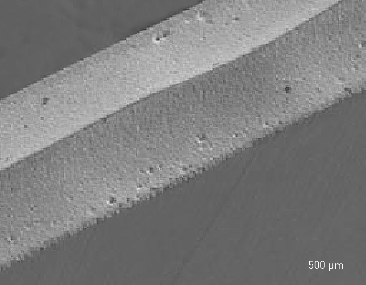

Unique features at no additional cost. Unique characteristics can be designed into products manufactured using photo etching due to the inherent edge "cusp" (see Figure 1) created during the process. Precision Micro can control etch cusp, and by doing so introduce a range of profiles allowing the manufacture of sharp cutting edges, such as those used in medical blades, or conical openings, such as those used to direct fluid flow in filtration meshes. (See Figure 2.)
