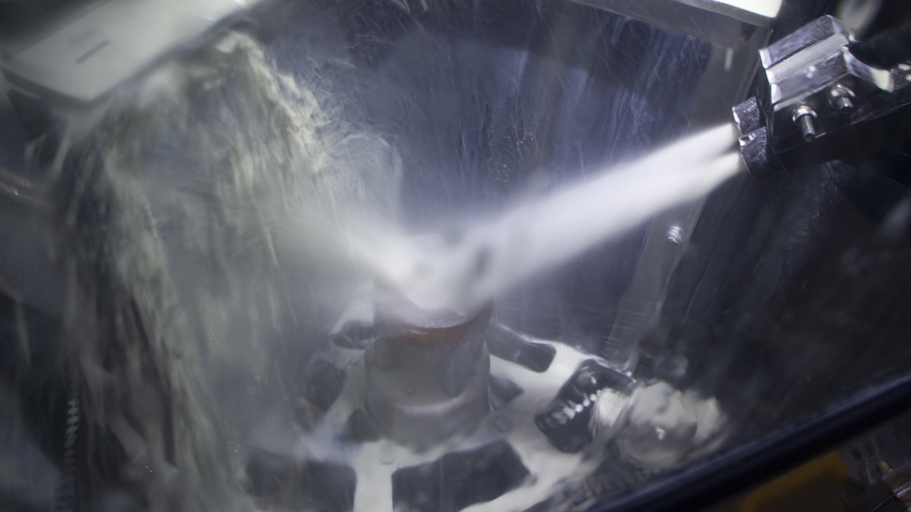

Wet blast processA finishing/post-processing solution that is largely neglected when looking at AM parts is wet blasting. Wet blasting is a clean, reliable, repeatable, and accurate process that creates parts with a consistently superior surface finish than alternative processes, and is ideal for parts made using direct metal laser sintering (DMLS) and selective laser sintering (SLS).
Wet blasting
From the family of shot blasting post-processing technologies, wet blasting is what it is called when water and abrasives media work together, and is particularly well suited for the finishing of delicate, precision-produced parts. The process is characterized as being dust free, can use very fine abrasives, uses very low volumes of abrasives due to the protective water layer, and minimizes the risk of embedding (especially for soft metals). It also produces what is perhaps the most important AM post-processed part characteristic, a superior surface finish.

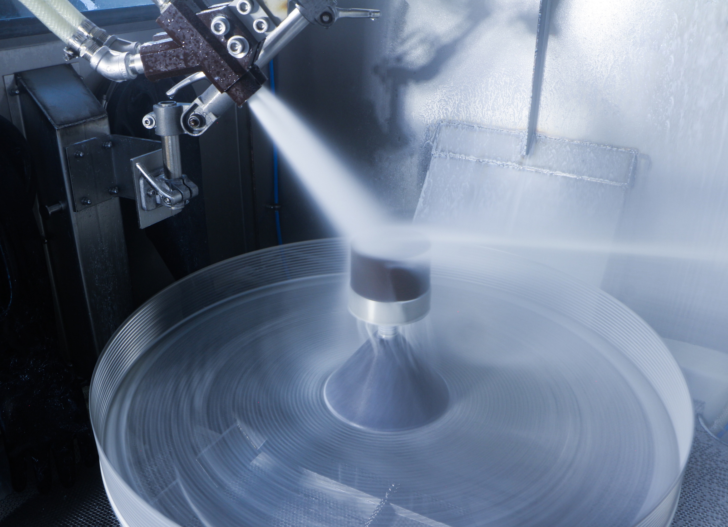

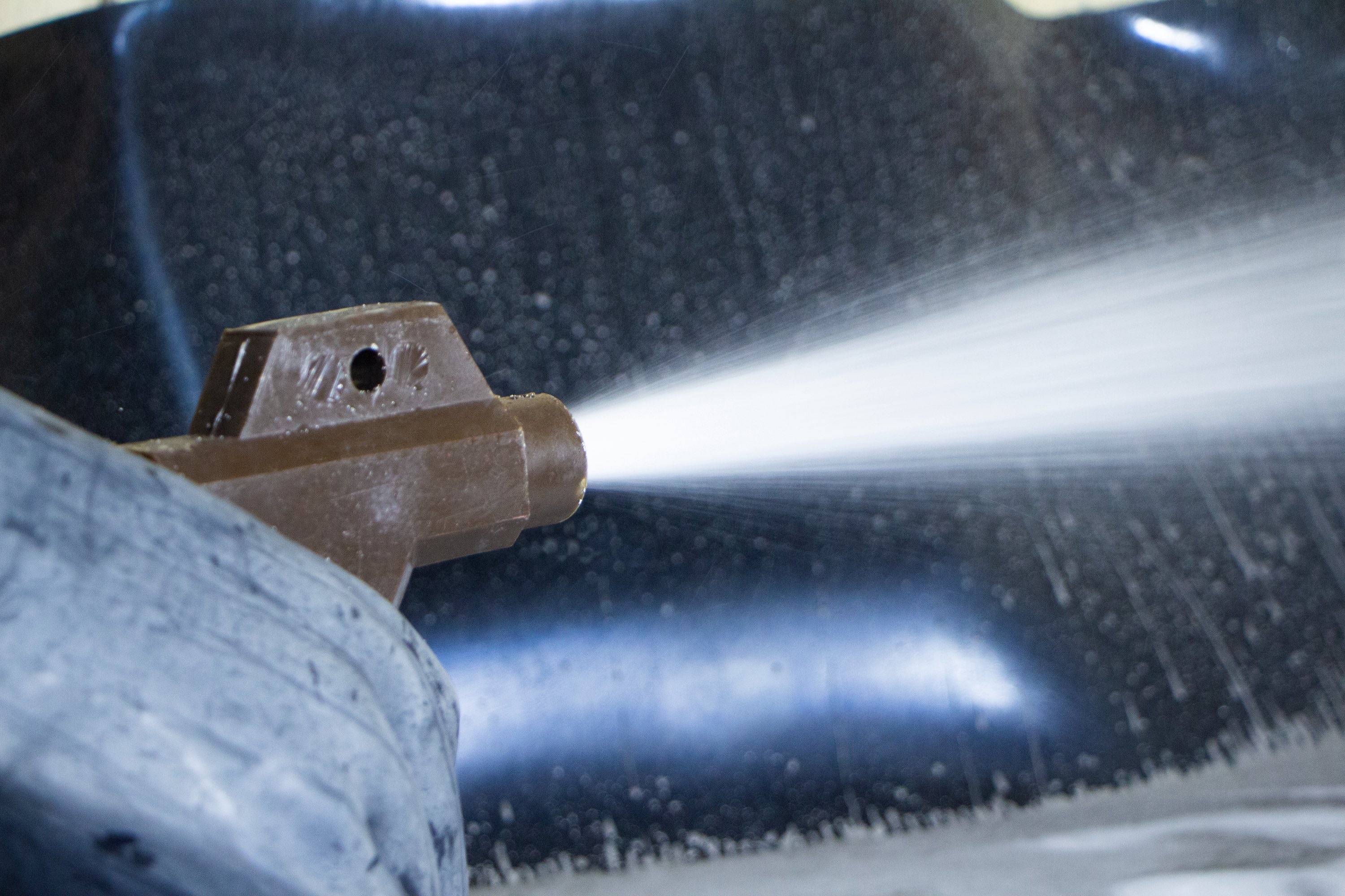

Wet blasting typically sees a mix of between 10-40% abrasive media to water. The slurry is pumped to the blast gun and then accelerated to a high velocity using compressed air through a blast gun nozzle that is directed at the part. The blast media impact on the workpiece creates the desired effect, be that cleaning, surface smoothing, coating preparation, cosmetic surface texturing, or peening.
The process removes powder and supports (from some plastic AM parts) and enhances the surface finish in one, and the use of different media can either promote a cosmetic or functional surface finish. Wet blasting machines can easily be integrated into an automated production line, or used as an isolated stand-alone technology.

Wet blastingWet blasting has benefits for the characteristics of the workpiece itself, but also the processing environment. The over-riding advantage is its gentleness, but also the process produces no dust, which prevents electro-static issues and therefore removes the need to consider ATEX regulations concerning explosive atmospheres. There is also no media impingement using wet blasting, an ever-present problem with dry blasting where media particles can embed in the workpiece surface compromising surface integrity.
Dry blasting generates significant heat during post-processing which when combined with the high-impact energy of the media on the workpiece can lead to the warping and bending of delicate parts. Wet blasting by contrast is a cooler gentler process that is especially suited to the post-processing of fragile thin-walled parts and components.

Wet blasting is an essential technology for various AM post-processing tasks. Wet blasting cleans the 3D-printed components by removing residual powder and significantly reduces their initial high surface roughness. It is capable of de-powdering and providing general surface cleaning and initial surface smoothing from Ra 25 µm to 1–1.5 µm. The technology makes parts more homogeneous and therefore better prepared for effective mass finishing, which also takes less time once a part has been wet blasted.
On metal AM parts the loosely sintered grains on corners are effectively removed. The wet process eliminates the worry about residual powder containment or sparking during the blasting process.
Wet blasting can be applied to and provide numerous finishes to metal and non-metal parts alike. Different media and different blast intensities customize the surface finish achieved. In addition, many AM parts require coating or painting post-build, and wet blasting creates what is called a “wet out” surface that allows the optimal adhesion of paints or coatings.
Changing media amount and blast intensity allows the effective cleaning and depowdering of a variety of plastic and metal AM parts with wet blasting. Often, AM parts have difficulty reaching internal channels and complex geometries which are not well served by dry blasting technologies but are easily and demonstrably cleaned and completely depowdered using wet blasting.
