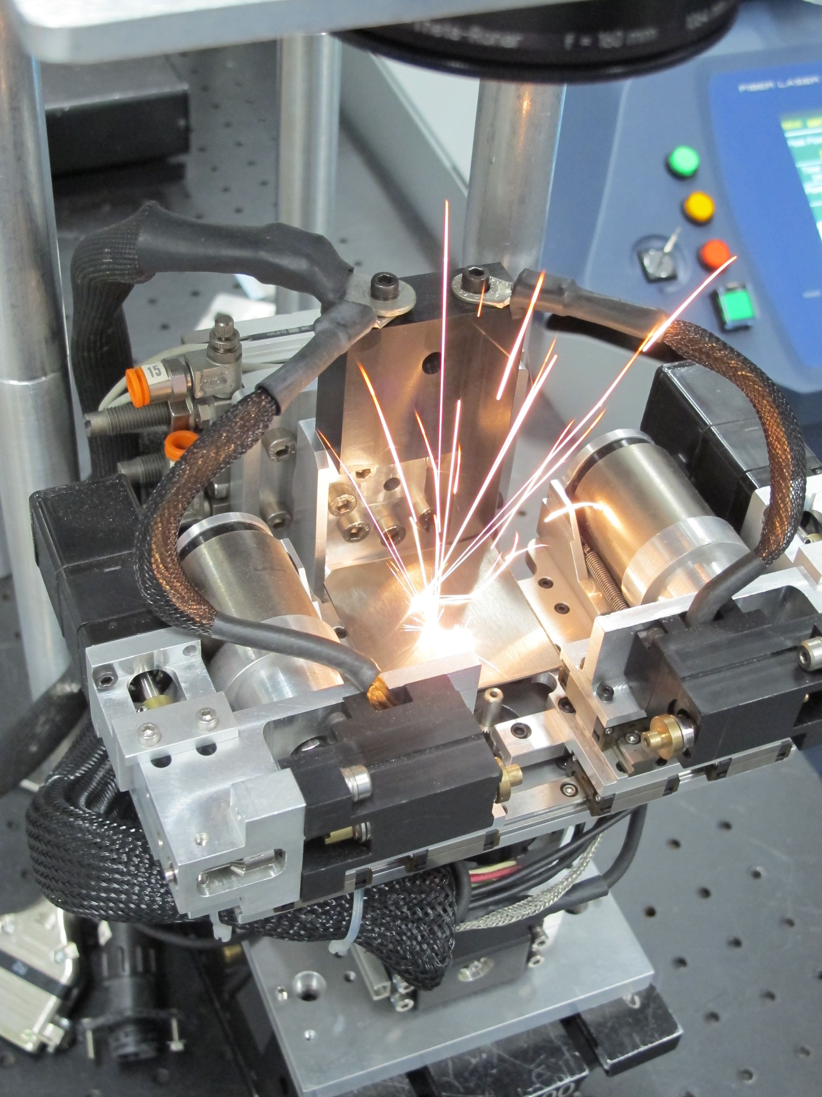

Equipment selection is another area in which application knowledge is vital. Unlike resistance welding, laser welding is a noncontact process and doesn’t utilize electrodes to hold parts in place, so customers must develop part fixturing to hold parts in place during welding. Application experts can suggest a range of standard tooling or help design custom tooling for manual, pneumatic or servo processes that enable customers to make the transition to laser welding.
Process, too, can be revised to unlock production potential. In some factories, customers seek to perform a butt weld to join two pieces with beveled or round edges so the parts will not be sharp. This process, though, can diminish the likelihood of a successful laser weld. Two pieces with rounded corners pushed flush to each other will meet below the surface, with no metal in the area between parts. This lack of material can make it impossible for a laser to effectively melt enough metal to create a weld of decent strength, so a process that includes rounding or beveling edges that must then be welded may prove less than ideal. In this case, application experts might advise against welding rounded corners, and instead implement a process in which operators can round off corners after the weld has been completed.

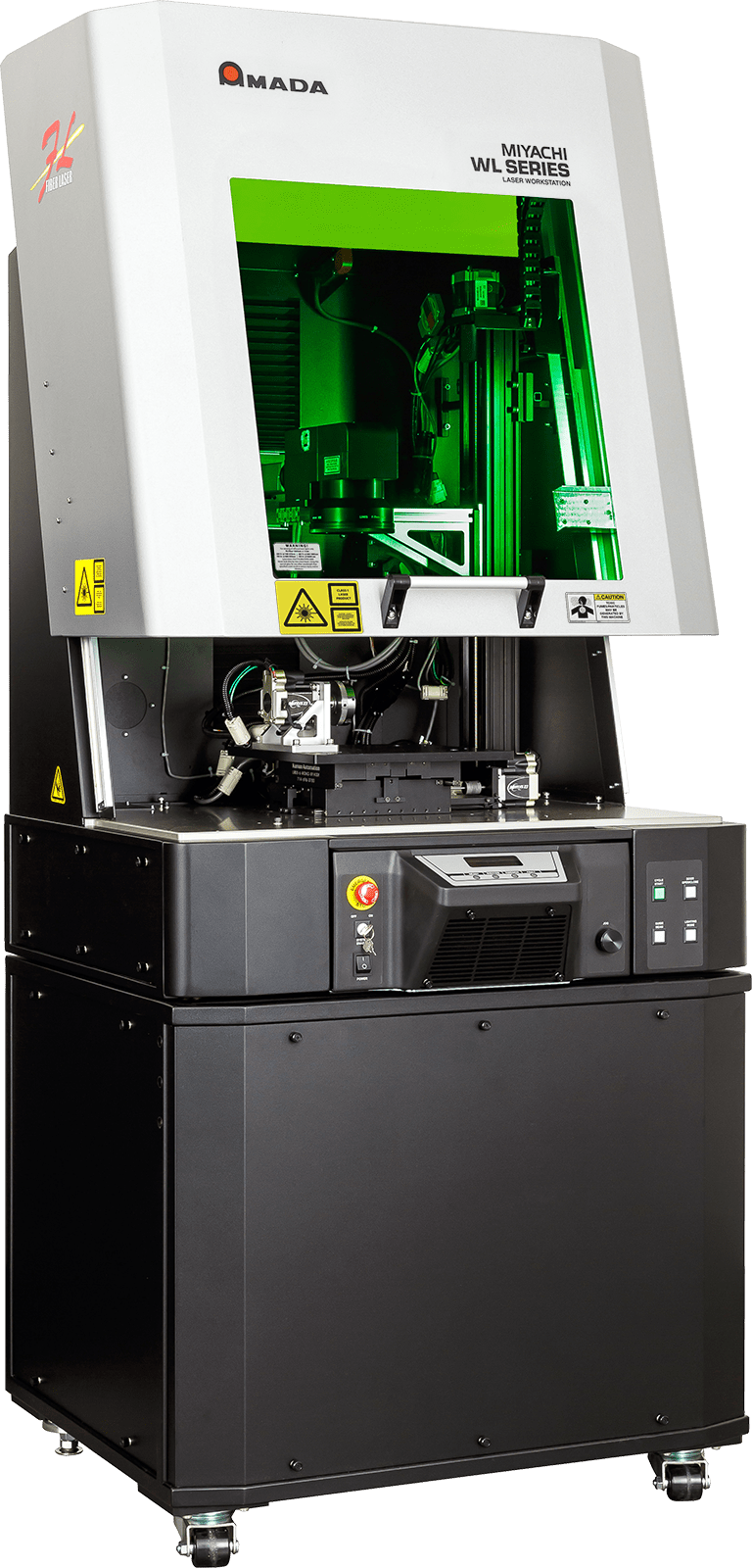

Upon determining that samples meet desired parameters, engineers design a preferred solution or a short list of potential fits. For laser welding, available options include both pulsed Nd:YAG and fiber lasers. These technologies are largely capable of the same performance but differ with regard to serviceability. A pulsed Nd:YAG laser is field serviceable, whereas a fiber laser must be sent back to the factory for repair and servicing. In the marking area, several units can do the same job but there are fine distinctions among them; selection is based on process-specific requirements.

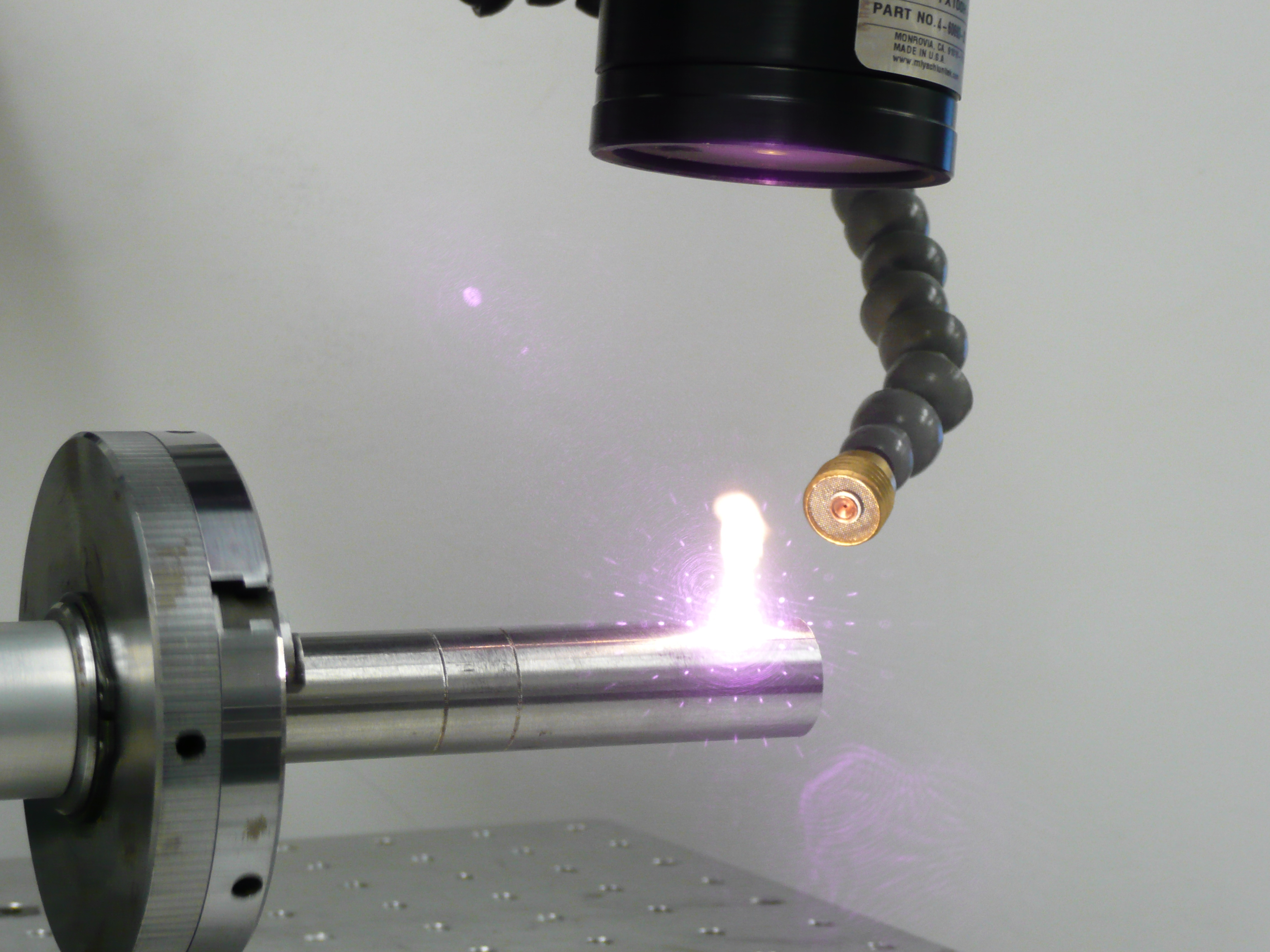

The design of the laser equipment itself centers on three elements: the laser, beam deliver and motion. Once an Nd:YAG or fiber laser is selected, the delivery mechanism is developed. Fiber delivery often calls for a focus head, which can be set up in a variety of configurations. Once the laser beam has been delivered to the part, motion is required to enable the beam to contact the part at multiple spot weld sites or along seams. Lighting or vision capabilities to identify laser location on a part can provide critical functionality for this phase of the process. Experts may add cover gas as well. The specifics of these mechanisms are closely linked to the intended use of the laser. For example, marking applications may include bar code scanners.
