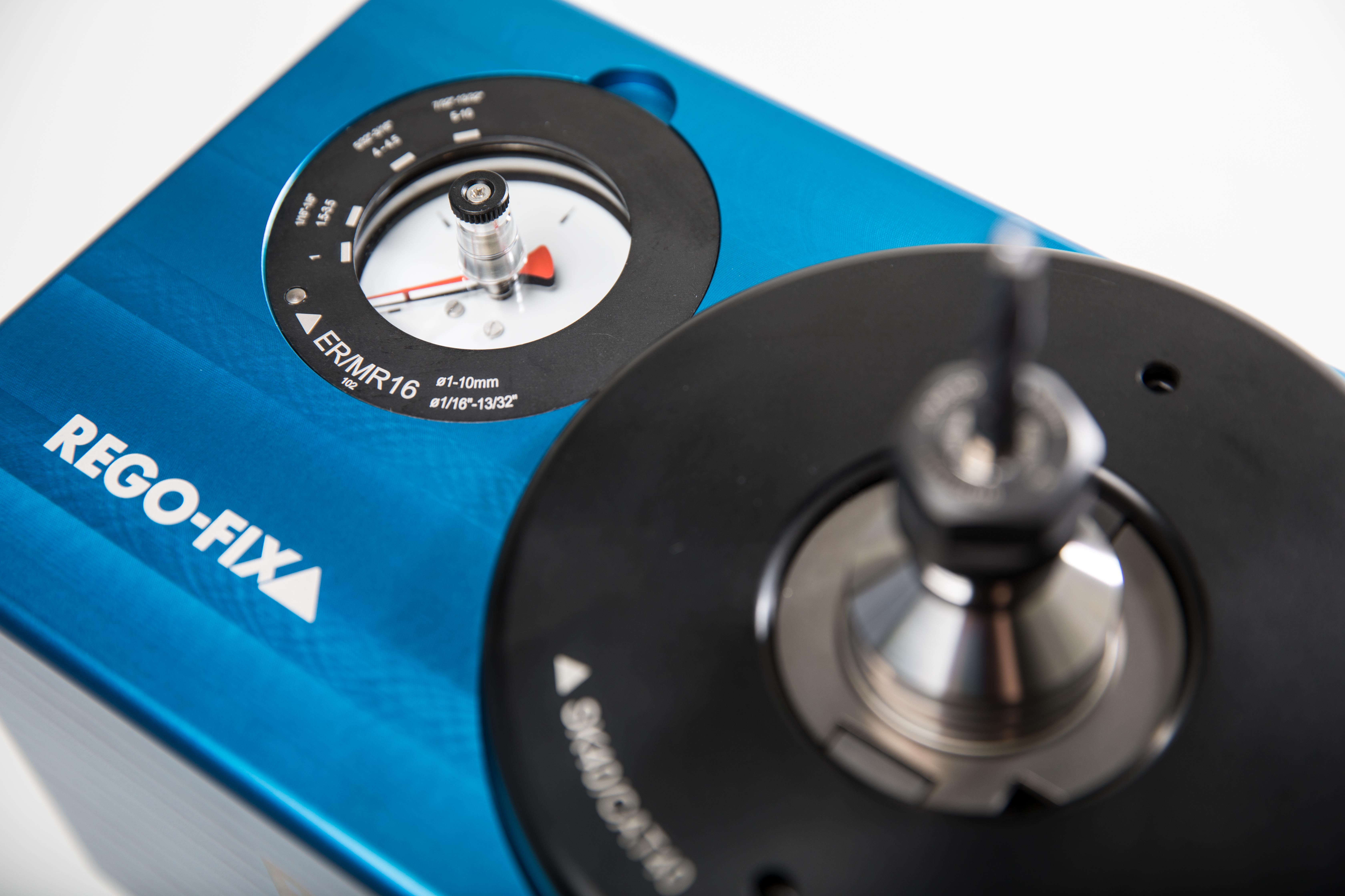

The TORCO-BLOCK system requires neither charts nor torque wrenches.

Seeing the damaging consequences of over-torqued tools, including its own ER collets and nuts, toolholder OEM REGO-FIX developed the TORCO-BLOCK system, which requires neither charts nor torque wrenches. The TORCO-BLOCK relies on new technology that enables one gauge to cover virtually an entire collet series. This straightforward device measures the applied torque quickly and accurately, replacing a large collection of reference tables and specialized adjustable wrenches with a single compact system that operators of all skill and experience levels can use successfully.

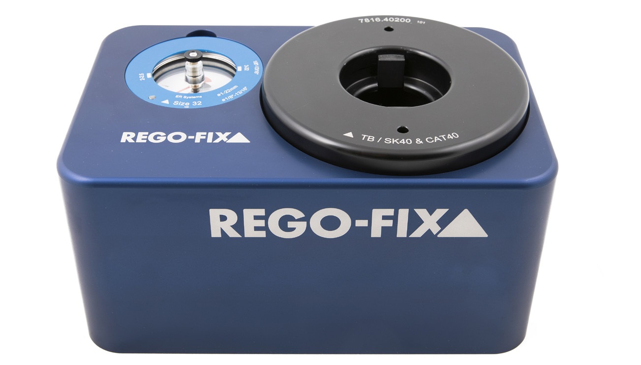

The TORCO-BLOCK is an analog device that attaches to a workbench with six bolts.

Some solutions to these setup problems substitute new complexities for old ones, adding bulky hardware or complex, expensive digital technologies that change the setup process but may not improve it. The TORCO-BLOCK is an analog device that attaches to a workbench with six bolts in a 6.693" x 10.629" (170 x 270 mm) footprint, and includes a set of 10 color-coded indicator rings, each displaying the shank diameters for a specific type of collet. An operator places the appropriate ring on top of the unit, sets a single indicator to the appropriate shank diameter and uses a standard wrench to tighten the toolholder until an indicator needle lines up with the target size. A hydraulic system inside the unit measures torque and displays it on the pressure gauge on top of the unit. When the indicator needle lines up with the torque value, the operator knows that the adjustment is correct and complete.
Simplicity and flexibility make a torque-assist system easy to use for a wide range of common toolholders, provided that the manufacturer sets up the system to handle the full range of production hardware. Along with REGO-FIX ER collets, the TORCO-BLOCK system also handles other brands with compatible torque ratings. The TORCO-BLOCK's set of adapters accommodates all standard spindle interfaces, including CAT, SK, BT, HSK and REGO-FIX Capto options. Each adapter inserts into the top of the TORCO-BLOCK unit and turns until it clicks into place. Recessed screws tighten with a standard Allen key and hold the adapters in place.
