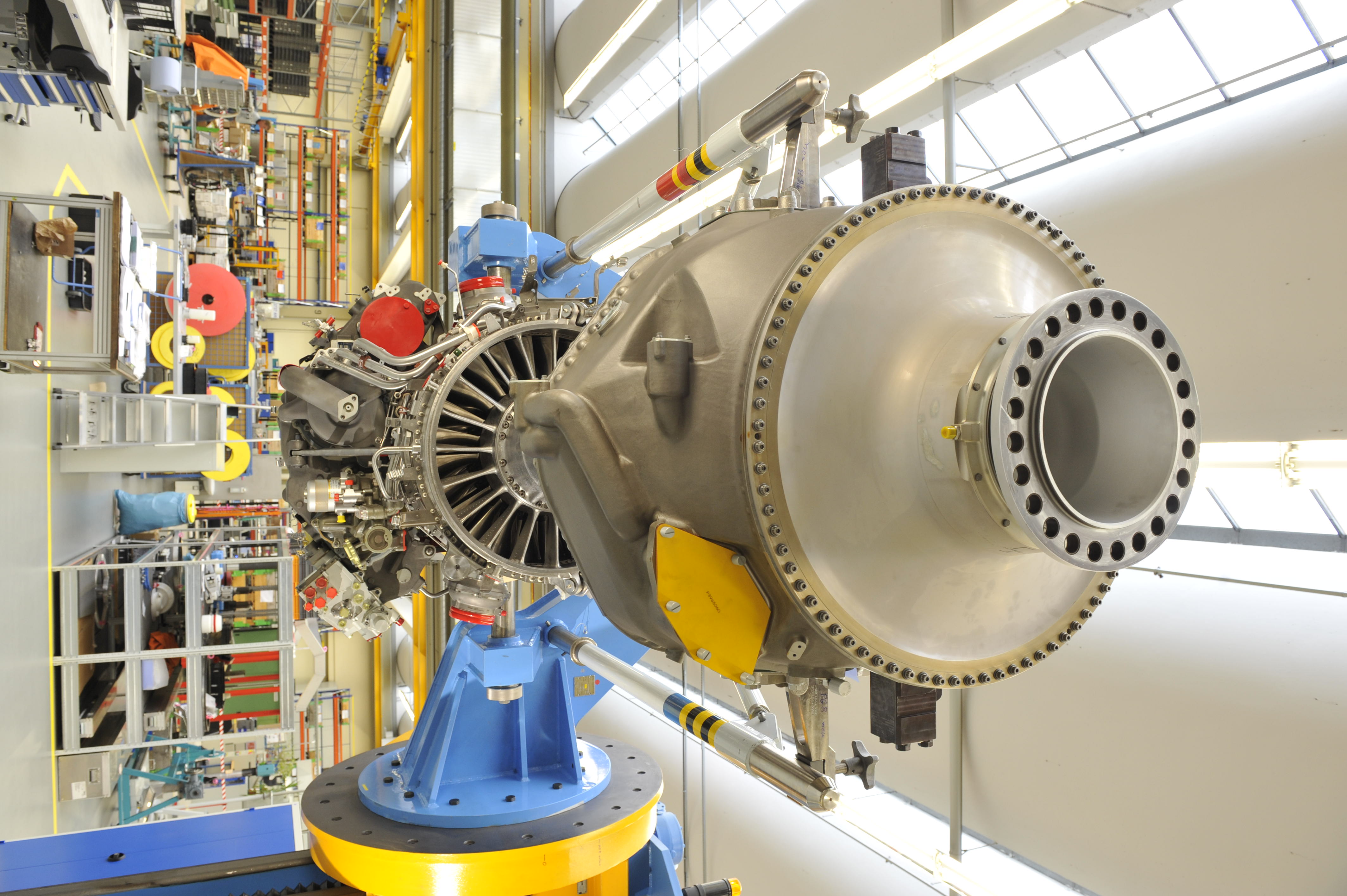

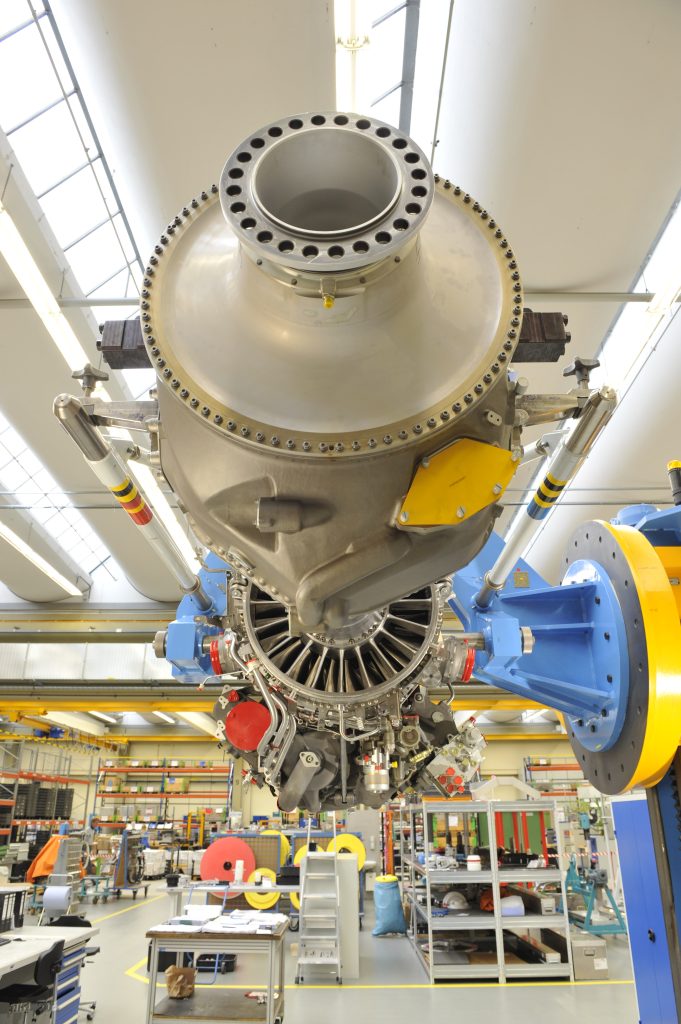

MTU Aero Engines manages challenging roughing applications for the military turboprop engine TP400-D6 with Haimer Safe-Lock. MTU is responsible for the TP400-D6’s intermediate-pressure compressor, intermediate-pressure turbine and intermediate-pressure shaft and has a stake in the engine control unit. Furthermore, final assembly of all TP400-D6 production engines takes place at MTU Aero Engines in Munich. Photo courtesy of MTU Aero Engines

As a consequence, Safe-Lock is in widespread use within the aerospace industry. Alexander Steurer, senior manager NC – programming stator components at MTU Aero Engines in Munich, explains the decision to use the Haimer system: “Through the introduction of Safe-Lock and the shrinking technology from Haimer, we can guarantee process reliability even with milling challenging high-temperature materials. This is a prerequisite to guarantee smooth processing during manufacturing of frames and castings, given our high degree of automation.”
The combination of pull-out protection and highest concentricity of the Safe-Lock system leads to low vibration and as a result, a stable machining process. Because of increased cutting depths and feeds, the mrr can be increased significantly. And thanks to the improved runout accuracy of Haimer shrink-fit chucks, tool life is improved by up to 50 percent.
The benefits of less than 3µm runout, that the symmetrical Safe-Lock design provides, coupled with optimal balance and the possibility for easy length presetting were substantial reasons for MTU to switch to the HAIMER system instead of continuing to use Whistle Notch or Weldon tooling systems. While these other systems do prevent tool pull out, both are unsymmetrical by design, hence providing insufficient runout and balance accuracy.
