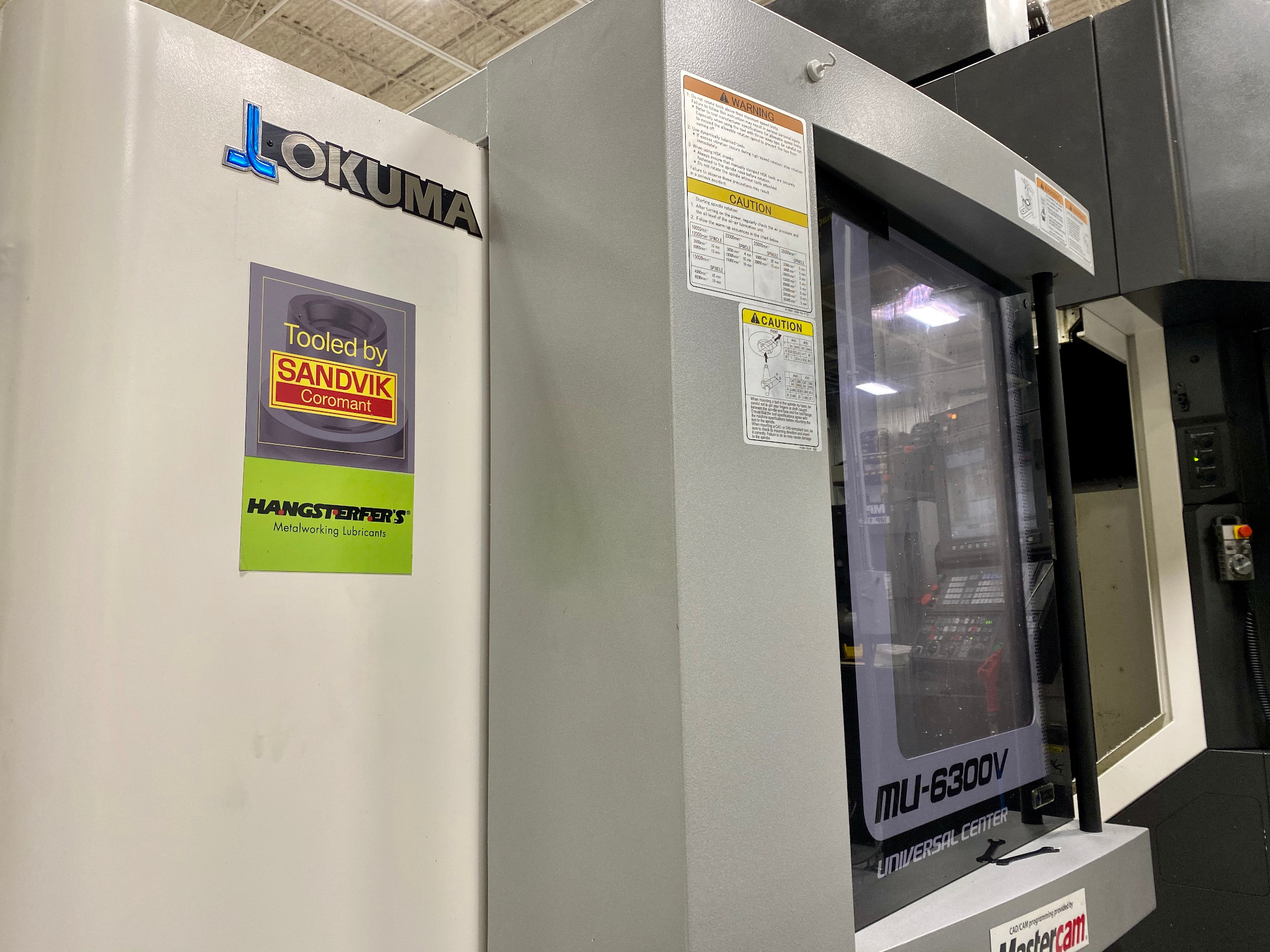

For these applications, DSM uses the CoroMill 390 shoulder milling cutters. With light-cutting insert geometries, the CoroMill 390 is designed for low cutting forces and vibration-free machining, for secure milling with all materials.
These properties are particularly advantageous when machining aluminium, which has a tendency to move if aggressive, deep radial cuts are used at high speeds because of the high stress levels of the material.
