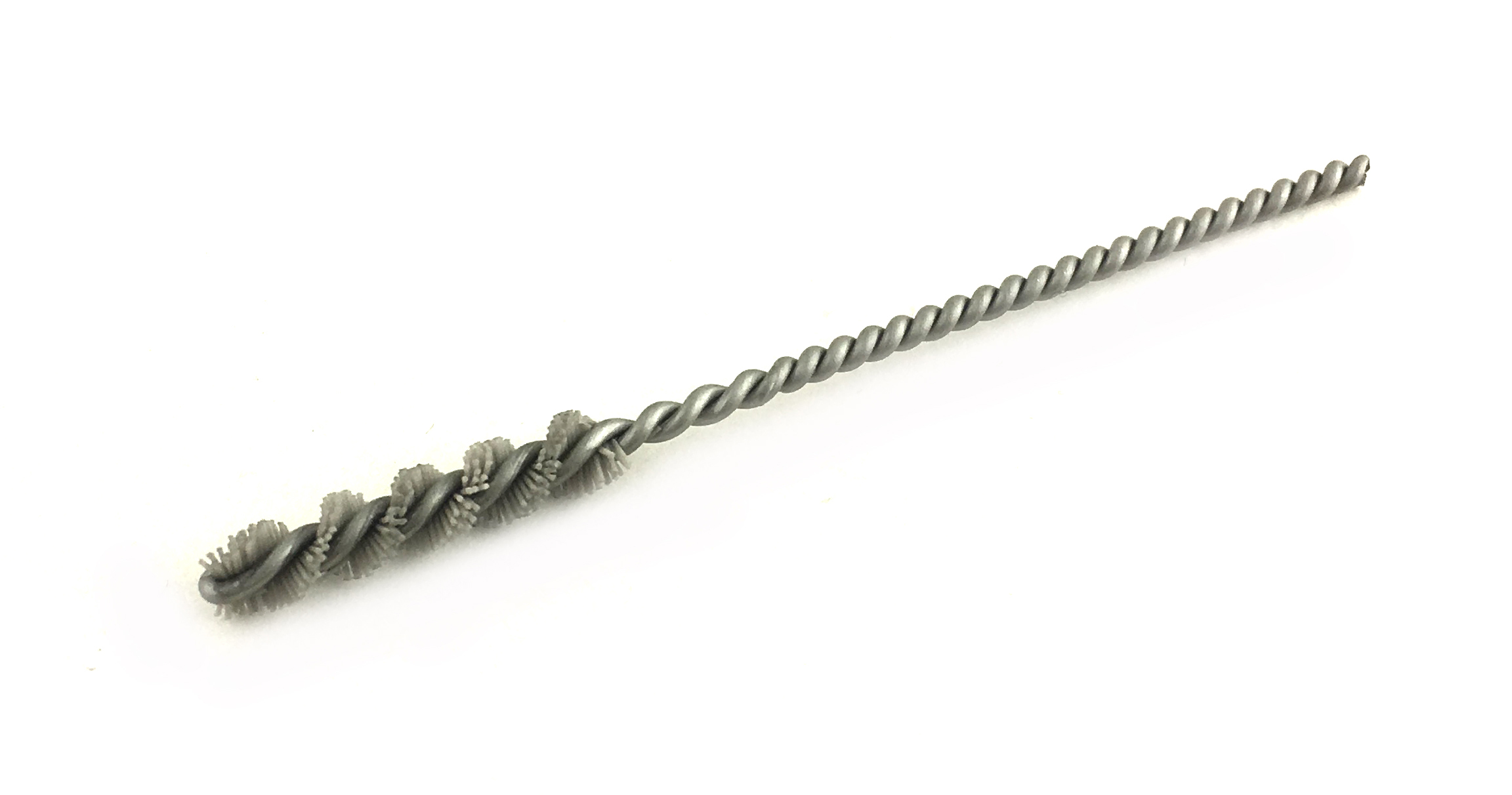

Miniature Deburring Brushes
For threaded parts and machined holes less than 0.125″, miniature metalworking brushes are an affordable tool to remove small burrs and perform internal polishing.
Miniature brushes come in various small sizes (including kits), contours and materials. These tools are best suited to address tight tolerances, edge blending, deburring and other finishing requirements.
“Machine shops come to us for miniature brushes because they do not want to outsource the parts anymore and want to do that work in-house,” said Jonathan Borden, national sales manager of Brush Research Manufacturing. “With a miniature brush, they no longer have to worry about the lead times and extra coordination to send parts out and bring them right back in.”
As a full-line supplier of surface finishing solutions, Brush Research Manufacturing offers miniature deburring brushes in a variety of filament types and tip styles. The company’s smallest diameter brush measures only 0.014″.

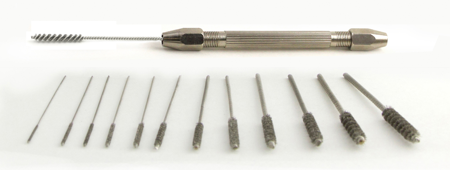

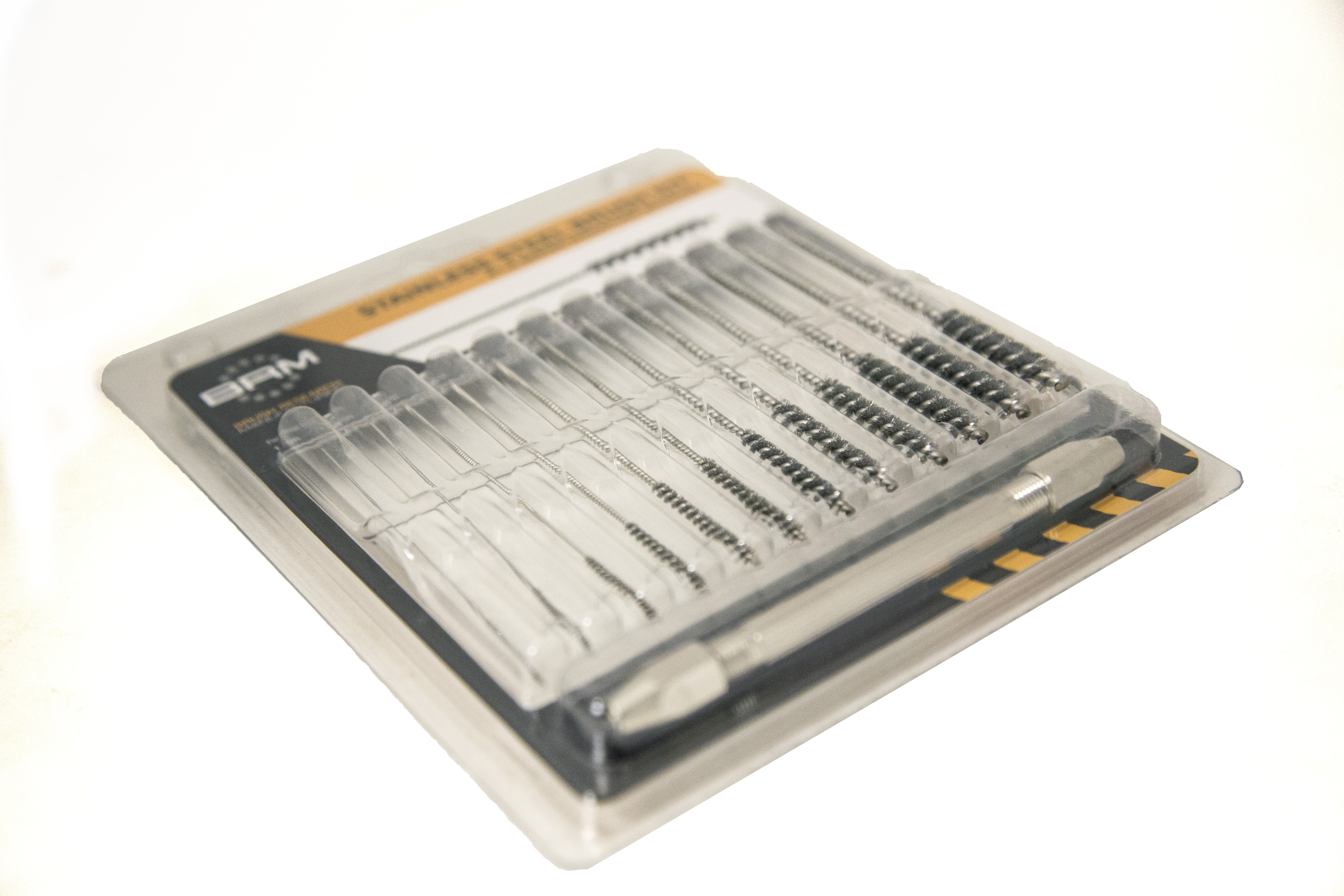

The miniature deburring brushes can be used by hand. However, because the brush stem wires are very fine and may bend, the company recommends using a pin vise. The company offers a double-end pin vise in kits with up to 12 brushes in both decimal (0.032″ to 0.189″) and metric hole sizes (1mm to 6.5mm).

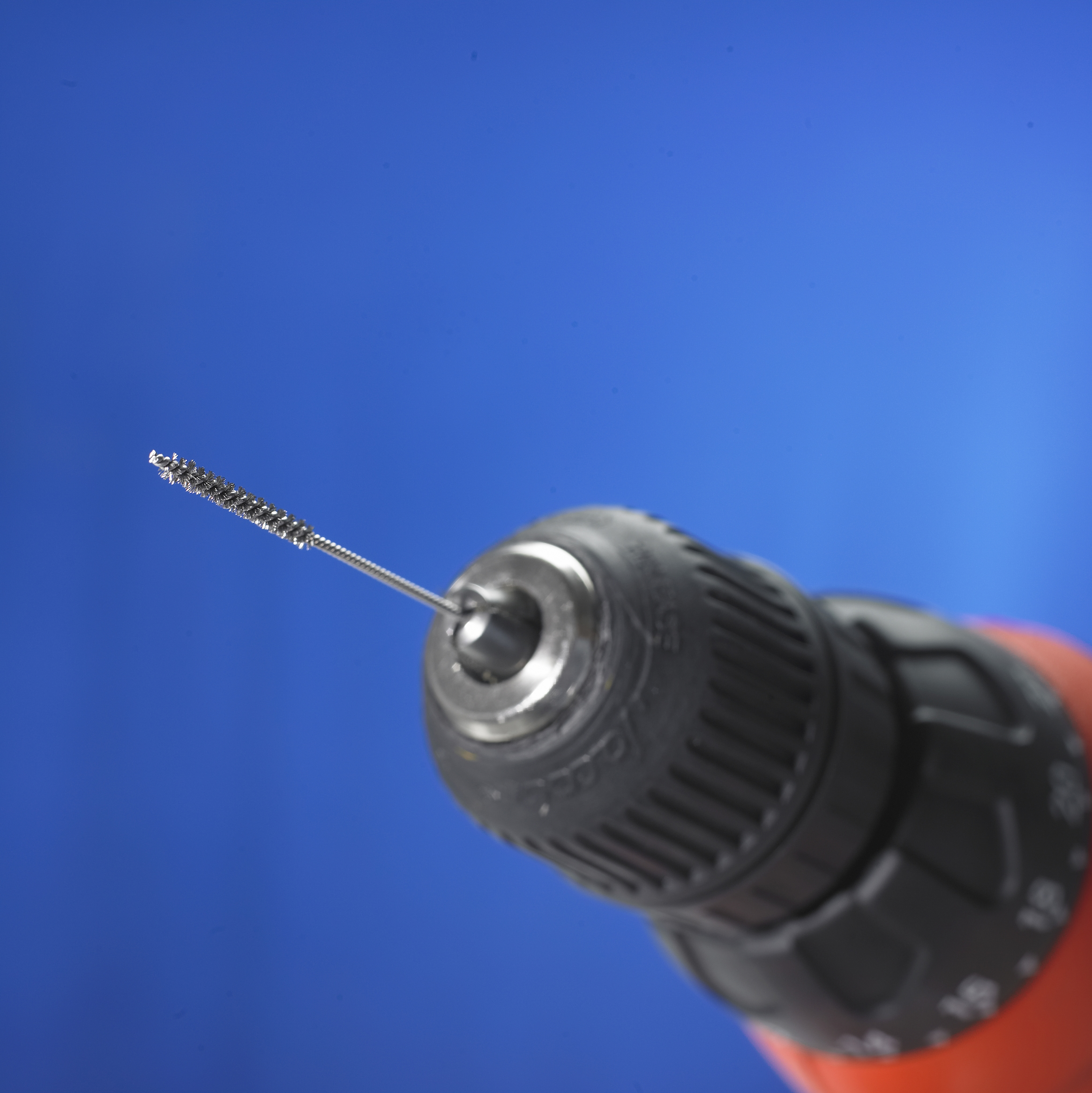

The pin vises can also be used to grip the small-diameter brushes to allow them to be rotated under power on a handheld drill and CNC machine.
Miniature brushes can also be used on external threads, to remove small burrs that can form at the start of the thread. These burrs can cause problems and should be removed, because any displaced metal can cause critical and potentially hazardous situations in industries that require exceptional precision and cleanliness.
To prevent deflection of the twisted wire stem of the brush, CNC equipment can be programmed to apply the precise pressure and rotational speed.

“These kinds of deburring operations – even with very small diameter miniature brushes – can be automated,” Borden said. “You can use the tools on CNC machines using the pin vise or by making an adapter.”
There are several types of miniature brushes available today that vary not just in size, but also filament type. Carbon steel, stainless steel, brass, nylon and abrasive-filled nylon are commonly used. Abrasive-filled nylon can contain silicon carbide, aluminum oxide or diamond abrasive.
According to Borden, abrasive nylon is particularly effective for removing burrs and polishing thread peaks and flank angles in tapped aluminum holes.
“If you cut a single-point thread in aluminum or the part was threaded using diamond tooling, there will be a lot of ‘fuzz’ and rough thread flank angles that need to be polished,” Borden said.
Miniature stainless-steel brushes are popular for more aggressive deburring of materials like cast iron or steel to remove chips or clear break-through burrs. Although abrasive nylon miniature brushes are available as small as 0.032″, due to the nature of the stainless steel, Brush Research was able to add three smaller brush sizes: 0.014″, 0.018″ and 0.020″.
Brush Research also supplies miniature deburring brushes with diamond abrasive filaments for harder materials such as hardened steel, ceramic, glass, and aerospace alloys.
“The choice of filament depends on the surface finish specifications, or if there is a need for a little more aggressive deburring power,” Borden said.
