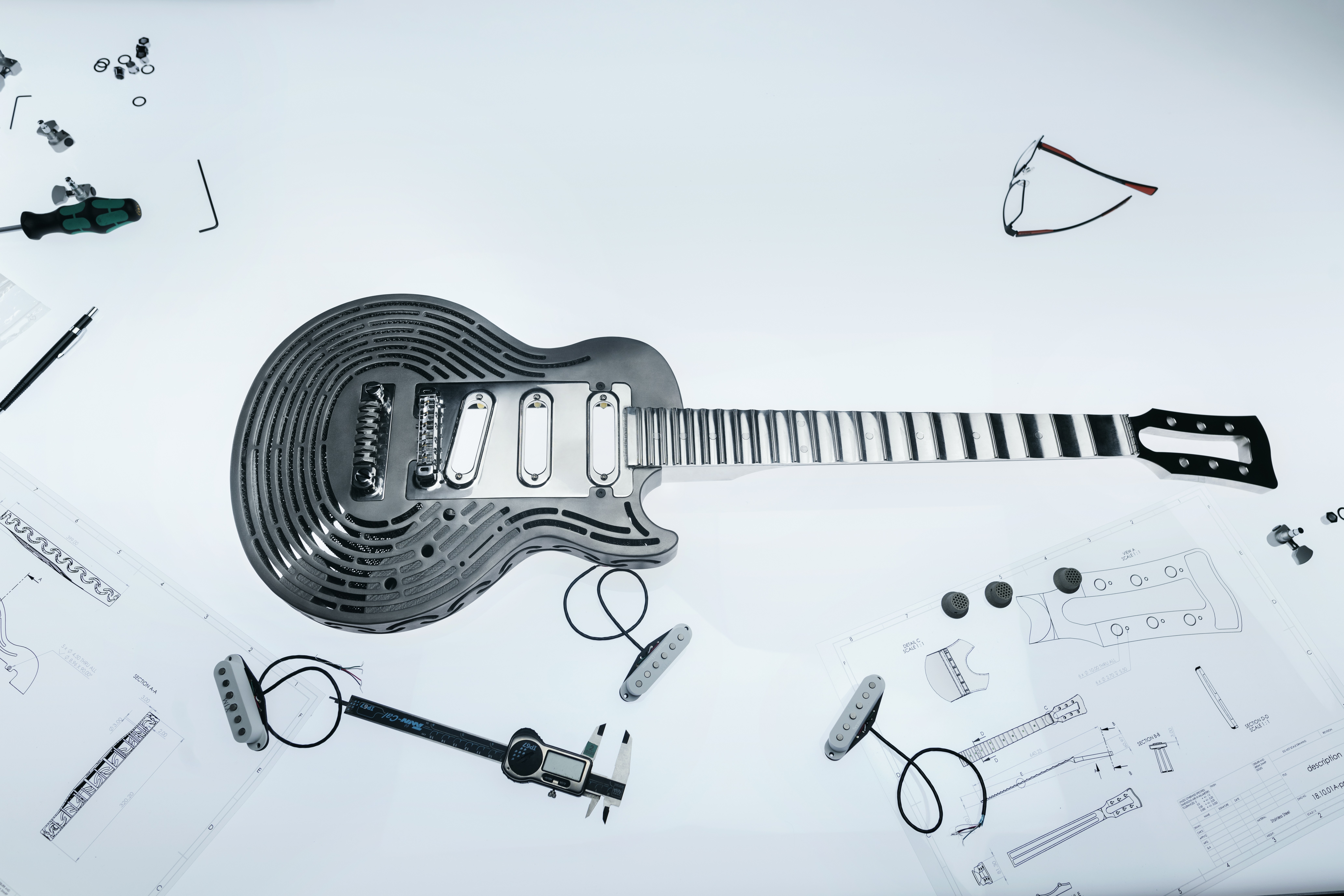

Sandvik engineers teamed with renowned guitar designer Andy Holt, of Drewman Guitars, to match Malmsteen's exacting musical standards and his lightning-fast playing style.
"We've had to innovate from the top down. There's not a single part of this guitar that has been made before. It's a piece of art, really," explains Holt. "The weak point in any guitar is where the neck joins the body. Sandvik solved the problem by milling the neck and the main hub of the body as one piece. You could use the guitar as a hammer and it wouldn't break."
Several different divisions of Sandvik collaborated to make the instrument. For the guitar's 3D printed body, Sandvik relied on its expertise in metal powder and additive manufacturing. Lasers traced a design in beds of fine titanium powder, fusing layers of material one on top of the other. The layers, each thinner than a human hair, built up to make the body of the guitar.
"Additive manufacturing allows us to build highly complex designs in small production runs," said Amelie Norrby, additive manufacturing engineer at Sandvik. "It lets us create lighter, stronger and more flexible components with internal structures that would be impossible to mill traditionally. And it is more sustainable because you only use the material you need for the component, minimizing waste."
The guitar's neck and fretboard were machined by Sandvik Coromant in one machine from a solid block of recycled stainless steel.
"Precision was critical," said Henrik Loikkanen, machining process developer at Sandvik Coromant. "Our software is built on years of experience, giving tool and the cutting data recommendations that helped us mill the fretboard down to a challenging thickness of one millimetre in places."
The next challenge was to strengthen the fret and neck as they extended into the guitar's body. That solution took the form of a new, super-light lattice structure that was sandwiched between the guitar's neck and fretboard. Made from hyper-duplex steel, a Sandvik innovation, the lattice structure is reportedly the strongest in the world for a given weight.
