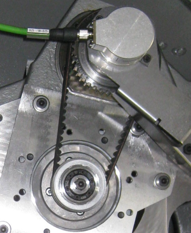

The ROQ model HEIDENHAIN rotary encoder sits directly on the Z-axis, which is driven by a motor through a toothed belt. Photos courtesy of INDEX-Werke

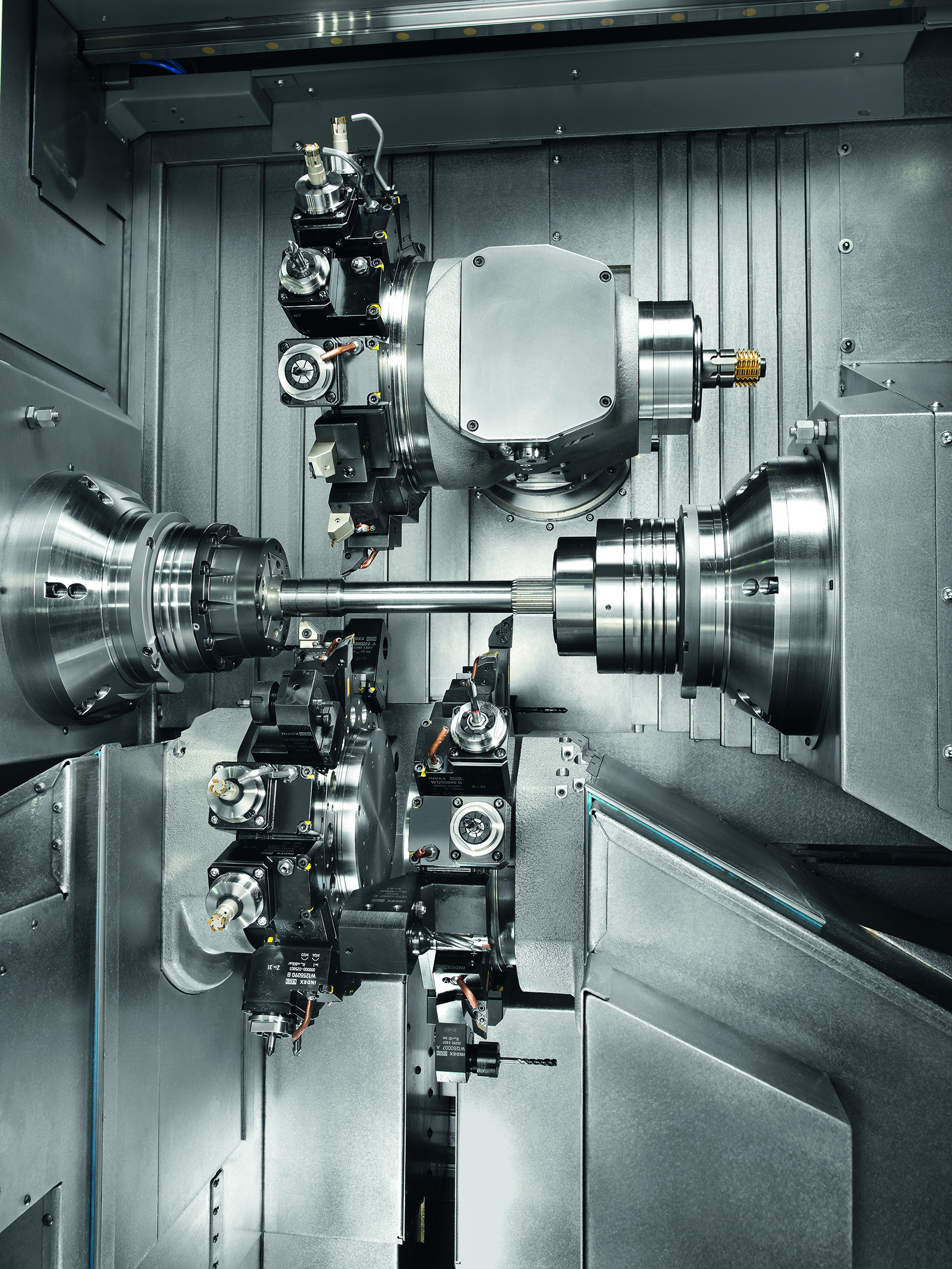

There’s a lot happening in an INDEX G200; if you see the full working space, one can well imagine the consequences of a crash of the tool carriers with the opposing spindle.

That’s where the additional ROQ rotary encoder from HEIDENHAIN on the Z-axis helps. To transfer a workpiece from the main spindle to the counter spindle, the machine initially moves the counter spindle over the workpiece and the counter spindle then clamps it. During this clamping process, the axis moves due to the forces that are ascertained by the rotary encoder. The encoder then transmits the measured values to the control via its DRIVE-CLiQ interface, which offsets them during further machining.
“With the second rotary encoder on the Z-axis, we are closer to the cutting edge and can therefore measure more accurately than with the motor encoder. Thanks to this arrangement, we are able to reliably realize a length deviation of less than 0.02mm during the workpiece transfer process, ” said Eberhard Beck, head of control technology at INDEX.

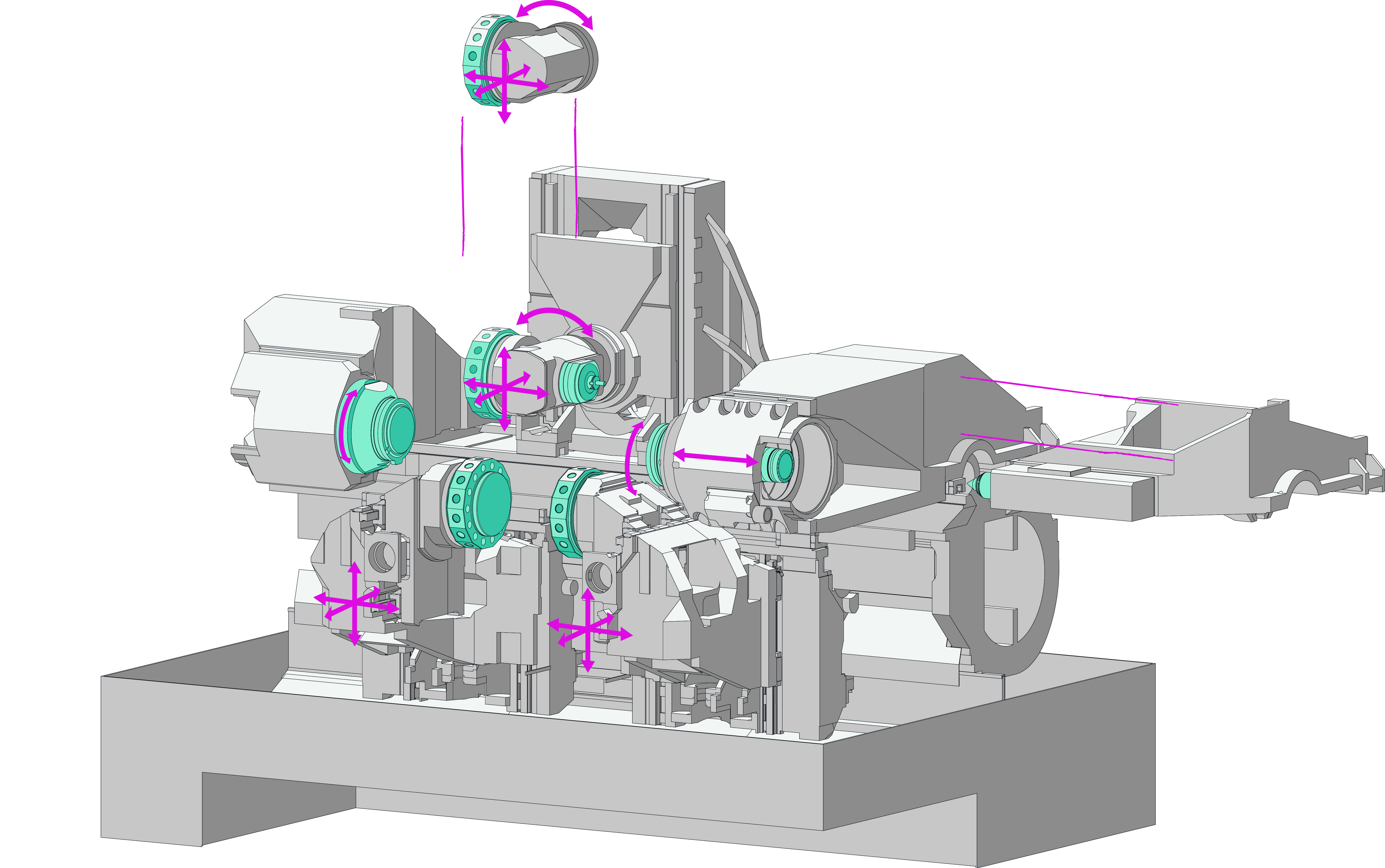

For six-sided full-surface machining to become possible, a lathe such as the INDEX G200 must coordinate highly complex motion sequences in all axes.
When searching for a suitable encoder for this application, the INDEX developers quickly came upon the ROQ encoder from HEIDENHAIN. “It is small, can be built in everywhere and is completely insensitive to contamination,” as Beck explained the choice. Also, thanks to the DRIVE-CLiQ interface, it can be easily connected to the machine control and has sufficient reserves with a single-turn resolution of 24 bits to ensure the required accuracy.
Beck noted another argument for the additional encoder: the gain in safety. To save space, INDEX integrates the motor for the Z-axis backwards, so to speak, under the axis and drives it with a toothed belt. Depending on the amount of chips and the machine load, this toothed belt can tear and stop the spindle. The rotary encoder already on the motor would not detect such toothed belt failure. The machine would continue machining. “In the worst case, the tool carriers could crash into the stationary counter spindle,” Beck pointed out: “Then up to 1 week of machine downtime and damage of several thousand euros are possible—a catastrophe for any company.” Preventing such disasters is one of the HEIDENHAIN rotary encoder’s tasks.
