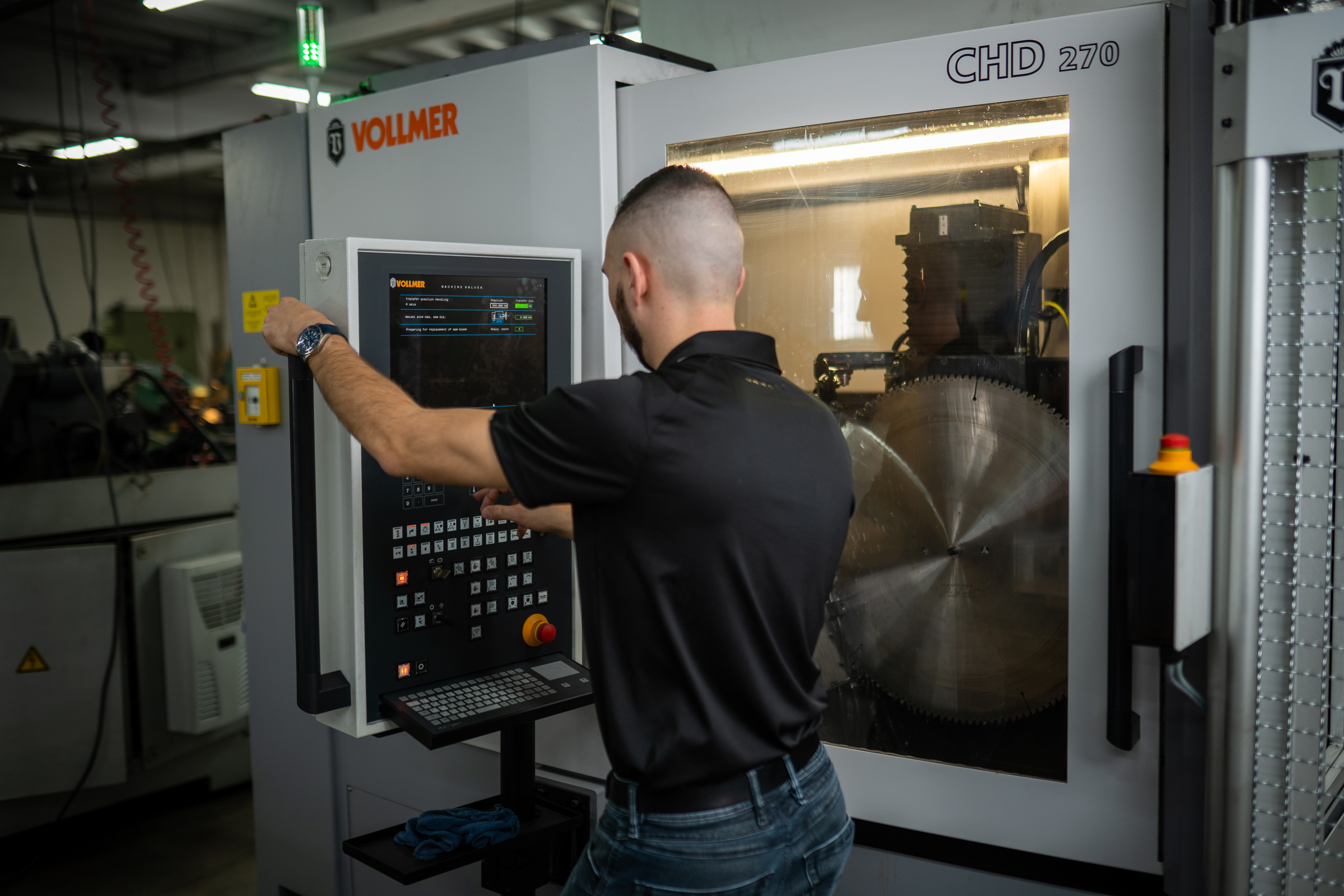

Automation technology has helped this Delson, Canada-based company overcome these obstacles. The company invested in a Vollmer CHD 270 8-axis TCT circular saw blade sharpening machine, combining it with the Vollmer ND250 automation station that enabled the company to run unmanned production throughout the pandemic.

With production requirements increasing from 350 to 1,000 blades a week, the CHD270 was a necessity. The CHD270 can process saw blades from 3.15” to 33” diameter whilst the ND250 4-axis double gripper automation cell has five carriages to accommodate up to 450 saw blades or a maximum load of 1,500kg.
“Saw servicing changed overnight,” said Riberdy. “We went from two operators running seven machines non-stop to one operator working across the CHD270, the CP200 and one or two Akemat machines. With the Vollmer CHD270, our operator can spend two hours loading and unloading around 150 saws and then setting the machine to run for 24 hours unmanned – giving the operator time and capacity to work on other machines.”
