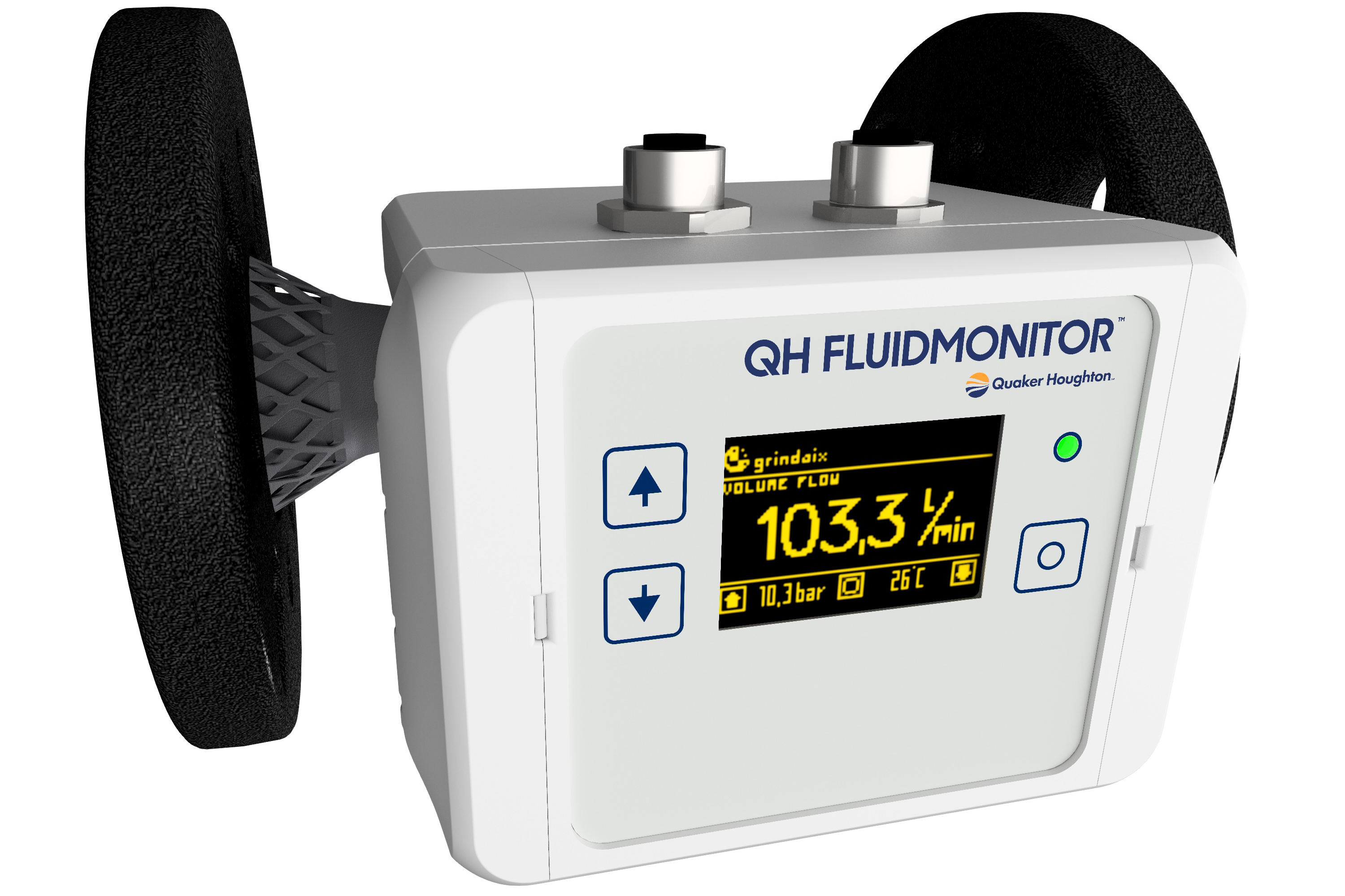

In precision grinding, for example, fluid temperature, pressure and flow are critical for achieving required tolerances and surface finishes while simultaneously maximizing wheel life. Automated monitoring systems, like QH FLUIDMONITOR™ GQ, instantly detect key parameter drift, enabling immediate correction before surface quality is compromised. In grinding, even a 5% drop-in flow rate can result in a 1 µm form/dimensional failure due to component expansion. Keeping fluid parameters consistent via QH FLUIDMONITOR GQ ensures consistent part quality, extended grinding wheel life, and can even improve wheel performance by 20-30%.
The device was specially developed for grinding, and unlike most other flow sensors on the market, is not wear-sensitive to fast-flowing abrasive particles in the fluid. Together with customized QH Grindaix Nozzles, the device monitors the recommended optimal flow rate for the process-adapted nozzles, ensuring that users always have their fluid in exactly the right place, at the required speed and in the required quantity.

QH FLUIDMONITOR
