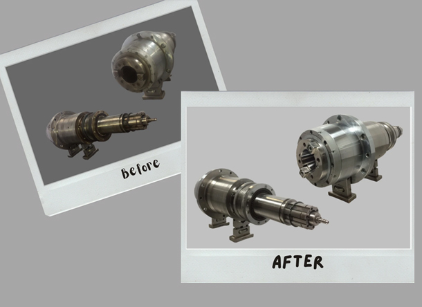

According to Flores, one specific brand of CNC machine had a unique situation where the spindles on a couple of units lost orientation.
"This was something we didn't hear and didn't see on the controller. We just saw the result when it was trying to do an automatic tool change. With the wrong orientation the automatic tool changer would jam," says Flores. "The spindle certainly wasn't bad; it was spinning correctly. It was just flipping on the orientation and was an OEM defect."
According to Flores, neither reaching out to the spindle manufacturer nor the CNC machine OEM was helpful.
Instead, Flores turned to MZI Precision of Huntington Beach, Calif., an experienced machine tool spindle rebuilder. He consulted with Ed Zitney, President of MZI Precision who observed the machine and saw that it was slipping. He took the spindle and created a retrofit for it.
Zitney explained that in these cases, the spindle would lose its location about the tool changer, which is typically a proximity switch issue. "We tested the proximity sensor, examined the location settings, the gap, and looked for any damage on the spindle's pickup diameter or the sensor," he said.
"We discovered that all the proximity components were in good working order, but that on this particular model of spindle the compression rings were not capable of holding the coupling 100% in place. It would turn slightly, causing the machine controls to see a loss of positioning," said Zitney.
Utilizing all OEM components, MZI Precision engineered four pins that would locate and lock the coupling in place. This eliminated the movement and solved the issue of the machine faulting out because of the lost position.
According to Flores, the retrofit quickly and cost-effectively resolved the spindle problem, facilitating tool changes.
"The engineered pins lock the spindle in place. It does not slip and lose its orientation, so tool changes are easy," says Flores. He pointed out the significant impact on production and the bottom line.
"Purchasing a new spindle would have cost us ten thousand dollars plus about a thousand dollars to expedite it air freight from Taiwan and may not have solved the problem because it was an OEM design issue," says Flores. "For the same reason, a rebuild alone probably would not have resolved it. Working with an expert [MZI Precision] we ended up saving thousands of dollars per machine for a critical retrofit that will help us keep six CNC machines reliably operating going forward."

According to Welci he currently oversees about 15 CNC machines in his shop, and most are relatively new. When MZI Precision rebuilt the spindle of an older machine to OEM specification, however, within a few days after installation the grease had mysteriously washed out of the bearings, posing a performance hazard.
When MZI Precision investigated onsite its technicians found that the vertical milling spindle was driven by a gearbox filled with oil, and oil from the gearbox had overflowed into the top end of the spindle.
"The spindle design did not have a proper seal to restrict the oil from entering the spindle, so the oil displaced the bearing grease. The bearings ran very hot in the oil and would burn up very quickly," explains Zitney.
According to Zitney, the fix was to engineer and manufacture a new top-end cover/slinger. This new part covers the top end of the spindle and rotates with the spindle when running, preventing oil from entering the spindle's top.
For even greater reliability and performance, Welci 's shop upgraded to ceramic hybrid bearings in the spindle at MZI Precision's recommendation. With the engineered changes and the upgraded bearings, the problem is solved. The spindle is far better outfitted for reliable performance than the OEM-supplied unit.
