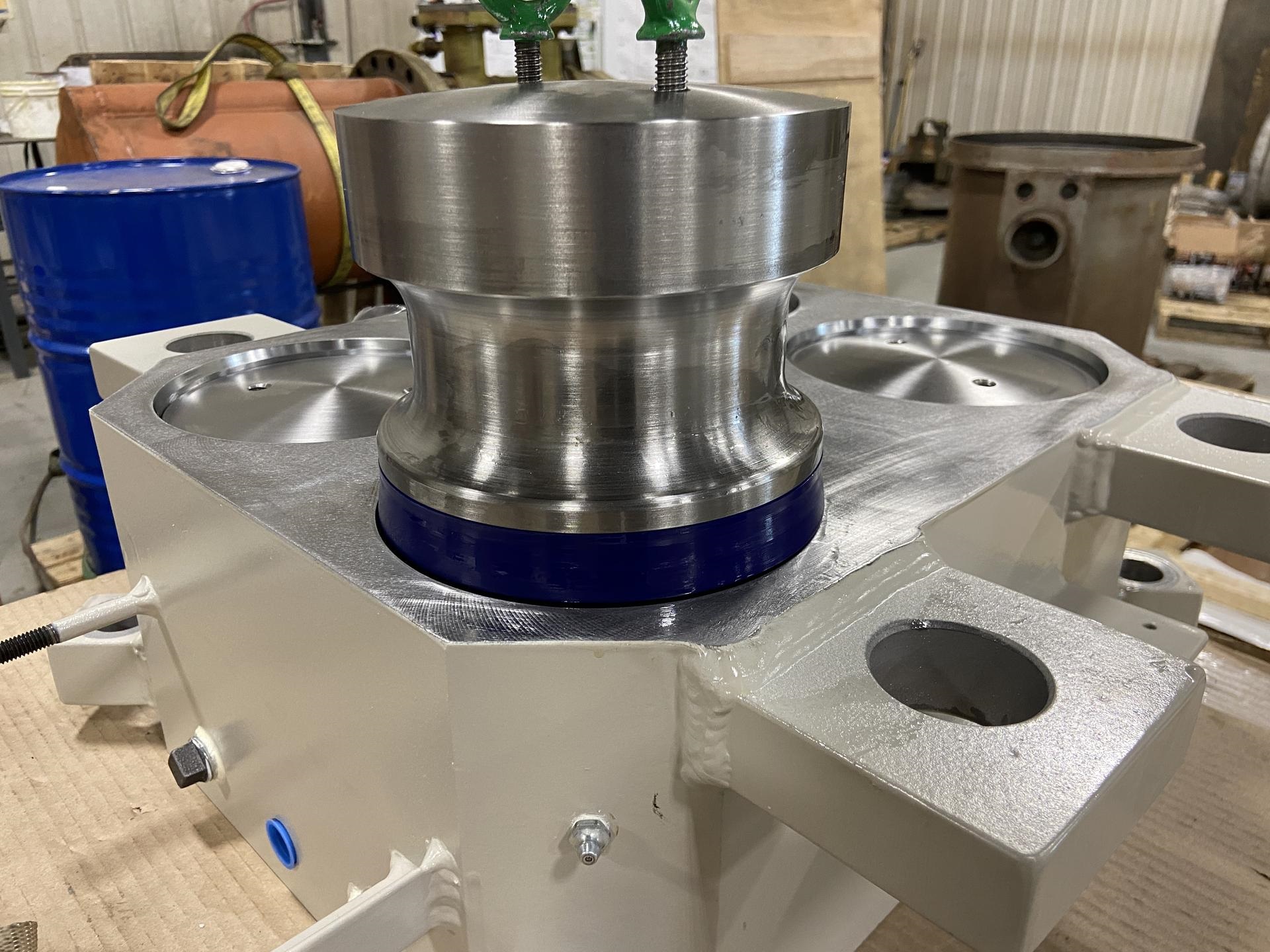

Each retrofit involved 262 bearings per turbine including wicket gate bearings and seals, Thorseal linkage bearings, Thordon SXL operating ring wear pads, and servo motor bearings and seals. The bearings being installed have high-end edge loading performance and range from about 100 to 300mm (4-12in) outside diameter.
The servomotors are being made entirely by Thordon distributor RMH Industries, one of the company’s specialties honed over the last 50 years. Gaétan Dionne, RMH Industries’ General Manager, cites, for example, that the company can install Thordon’s bearings on the servomotors using liquid nitrogen in less than a minute.

Greg Auger, Commercial Director at Millstream Engineering, explains that installing the wicket gate bearings requires careful attention to detail.
“It is critical to get accurate measurements of the shaft and housing dimensions before final machining of the ThorPlas-Blue bearings so that they can be sized correctly for proper fit and clearance. During installation, care must be taken to press-fit the bearings to prevent damage, and then they must be protected from risk of damage while other overhaul work continues. Careful measuring of the installed dimensions will help verify that all the large components will assemble correctly.”
