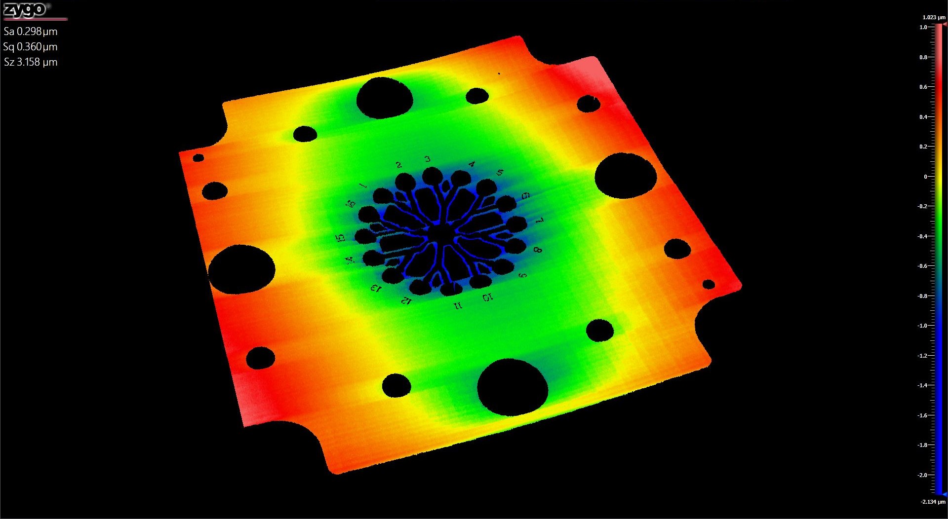

3D model of mold plateFor some applications, the decision may be to do some modeling. This does not work very well when looking at roughness — as modeling capabilities aren’t able to handle roughness — but modeling is better when looking at waviness and form. This is especially the case if looking to make two complex components, for example gears, or bearings, or camshafts. It is possible to model the interfaces and develop some pretty good estimates of surface texture profiles that will work.

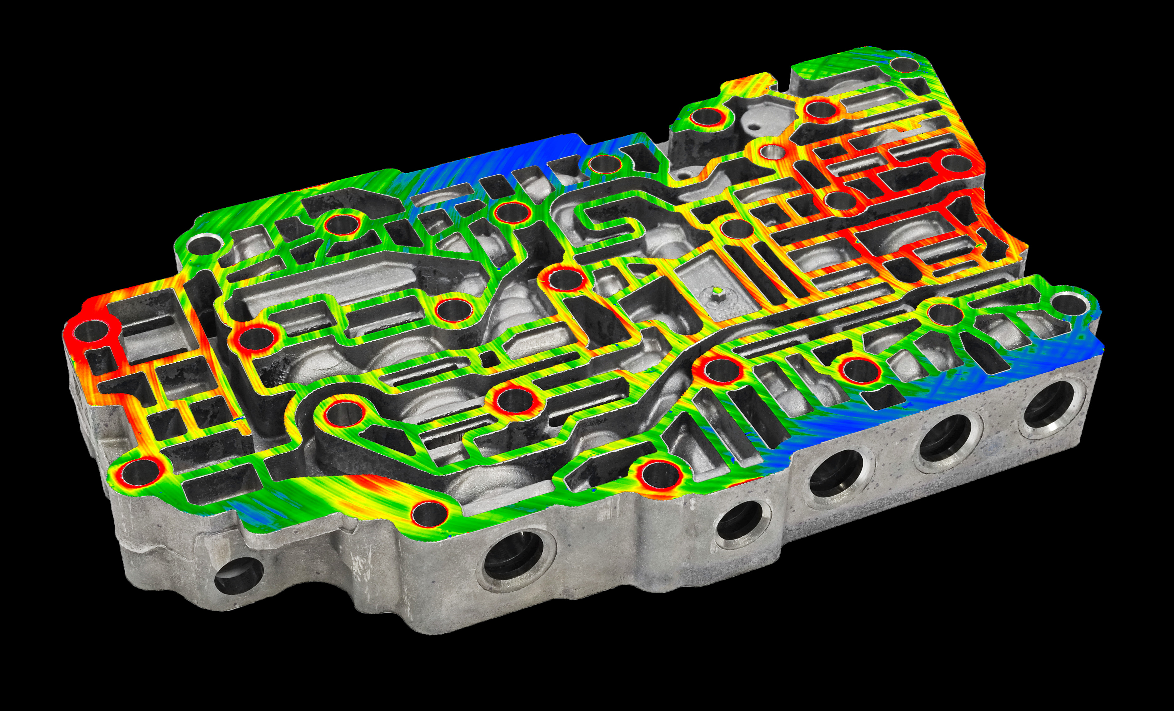

Valve body overlay hoverThis leads to the issue at the heart of surface texture parameter specification. How do we know the parameters being used are the correct ones to use?
Musolff says, “On a most basic level, it is possible to see that surface texture parameters are working by looking at them. If you look at a system where there is wear between one part and another, you may see bands or stripes on a surface that is going to be waviness. With roughness, you’re not going to see stripes, the wavelength isn’t big enough, but if you see stripes you’d better have waviness parameters included in your specification. I think it’s a question of using logic. For example, if you have a gasket sealing against liquids, it’s likely if it leaks it’s probably not a roughness issue, especially if the liquid is fairly viscous like an oil. If you have leakage, it takes some area for that fluid to pass through which again tells you something about waviness more than roughness.”

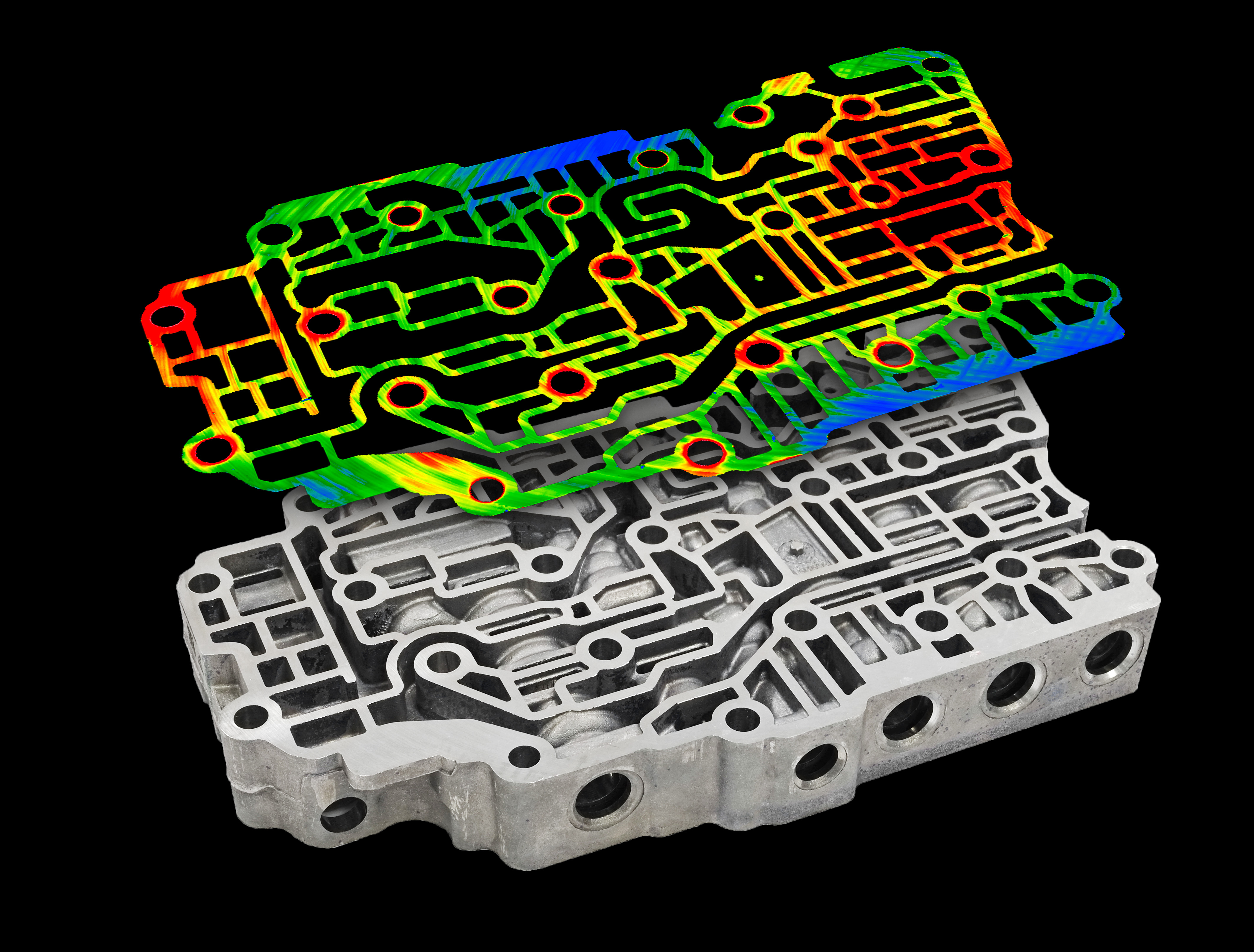

Valve bodyMalburg comments, “You can see so many things in the data, but one of the most important lessons to learn is the ability to separate data from noise. Can I trust my measurement? When we look at a picture of a surface in three dimensions are we seeing the surface or are we seeing noise in the measurement? Many times there are irregularities that aren’t real, so an engineer needs to ask, ‘can I trust the data?’ That comes with a little practice. There are some easy tools to adopt, however. For example, if you measure a surface left to right, spin the surface around and measure it right to left and see if it’s the same shape. Measure slower, measure faster, measure with different magnifications, but start to try to separate the measurement from the surface.”
Musolff adds, “Also ask, ‘if I see these features in my measurement does that make sense for this surface?’ If you think about a lapped surface, for example, the process shouldn’t generate miscellaneous random high peaks. If you measure that surface and get a lot of random high peaks you are measuring something and it’s not the surface. You are most likely measuring debris. You haven’t cleaned that surface well enough before your measurement. So use logic. Is what I’m seeing and how this part was made making sense when viewed together? The question of whether you can believe what your instruments are telling you brings up the whole question of uncertainty. Do you have noise or other factors coming into your equipment that is having an appreciable significant impact on your data? There are methods to measure the uncertainty of your system, ‘how much error can there be?’, ‘how wrong can my answer be?’ These aren’t often well understood or well applied, so this is another area that people should become more familiar with.”
Malburg concludes, “The key is to look at your surface as a surface with a well-scaled profile graph and a nice 3D rendering that you can move. Not just a static picture but using the ability to spin your data around and see how features relate to each other is the most powerful tool we have today. I often struggle when a company approaches me and says ‘here’s some data for our surfaces that aren’t working and they give me a list of numbers not pictures. Not data sets that I can look at, but instead a column of RA roughness values. Such numbers aren’t descriptive. An analogy I love to use is I could come home from a concert and tell you it was 105 decibels. But so is a fire truck. The best advice is to go to the concert, be there and listen to it.
