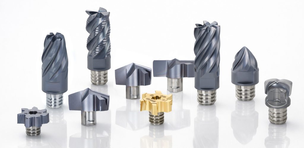

Rising tungsten prices, increasing raw-material scarcity, and growing demand from high-end manufacturing sectors are reshaping the global cutting tool industry, according to a new release from Tungaloy Corporation.
In 2025, carbide rod and cutting tool manufacturers implemented multiple price adjustments, with their full impact expected to become more visible in 2026. As cost pressure increases, manufacturers are being challenged not only to manage higher prices but also to rethink how cutting tools are designed, used, and replaced.
At Tungaloy, this challenge is being addressed through tool architecture. The company is emphasizing exchangeable-head solid carbide systems that reduce material consumption and environmental impact while achieving superior machining performance.
Conventional solid carbide tools require full replacement once worn, resulting in high material consumption and waste. Exchangeable-head systems take a different approach: only the worn cutting head is replaced, reducing carbide usage, limiting waste, and lowering exposure to raw-material price volatility—an increasingly important consideration as access to critical resources becomes more constrained. Tungaloy’s DrillMeister drilling system and TungMeister milling system are designed around this principle, enabling more efficient and responsible use of limited carbide resources compared with conventional solid tools.
Beyond material efficiency, the modular design provides a high degree of versatility. TungMeister offers a wide range of milling heads for applications such as high-feed, face, shoulder, slotting, and chamfering operations, while DrillMeister provides various drilling heads optimized for different drilling requirements. This flexibility allows manufacturers to adapt to changing production needs while reducing tooling inventory.
Emerging industries demand tight tolerances, consistent surface quality, and stable processes, often under high tool consumption rates. By combining material efficiency with modular versatility, exchangeable-head systems help manufacturers balance productivity, cost stability, and long-term resource efficiency in these high-precision environments.
Tungaloy’s philosophy is that when material costs continue to rise, the industry must look beyond short-term reactions.
Smarter, long-term solutions are needed. Solutions built into the architecture of the tool itself. By reducing material waste and improving versatility, manufacturers can maintain productivity and stability even under changing conditions. In times like these, it is important not to lose focus—or, quite literally, not to lose your head.
