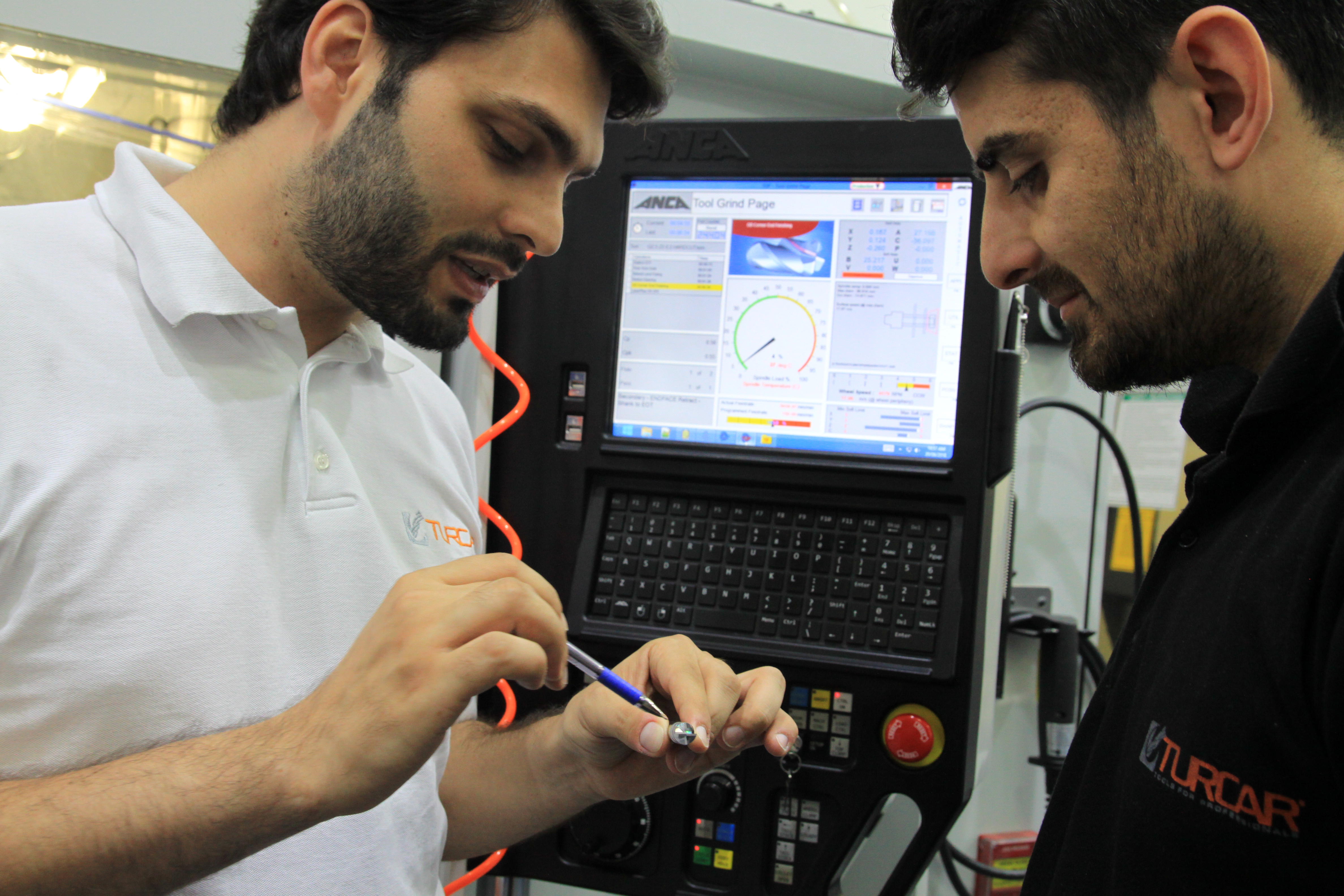

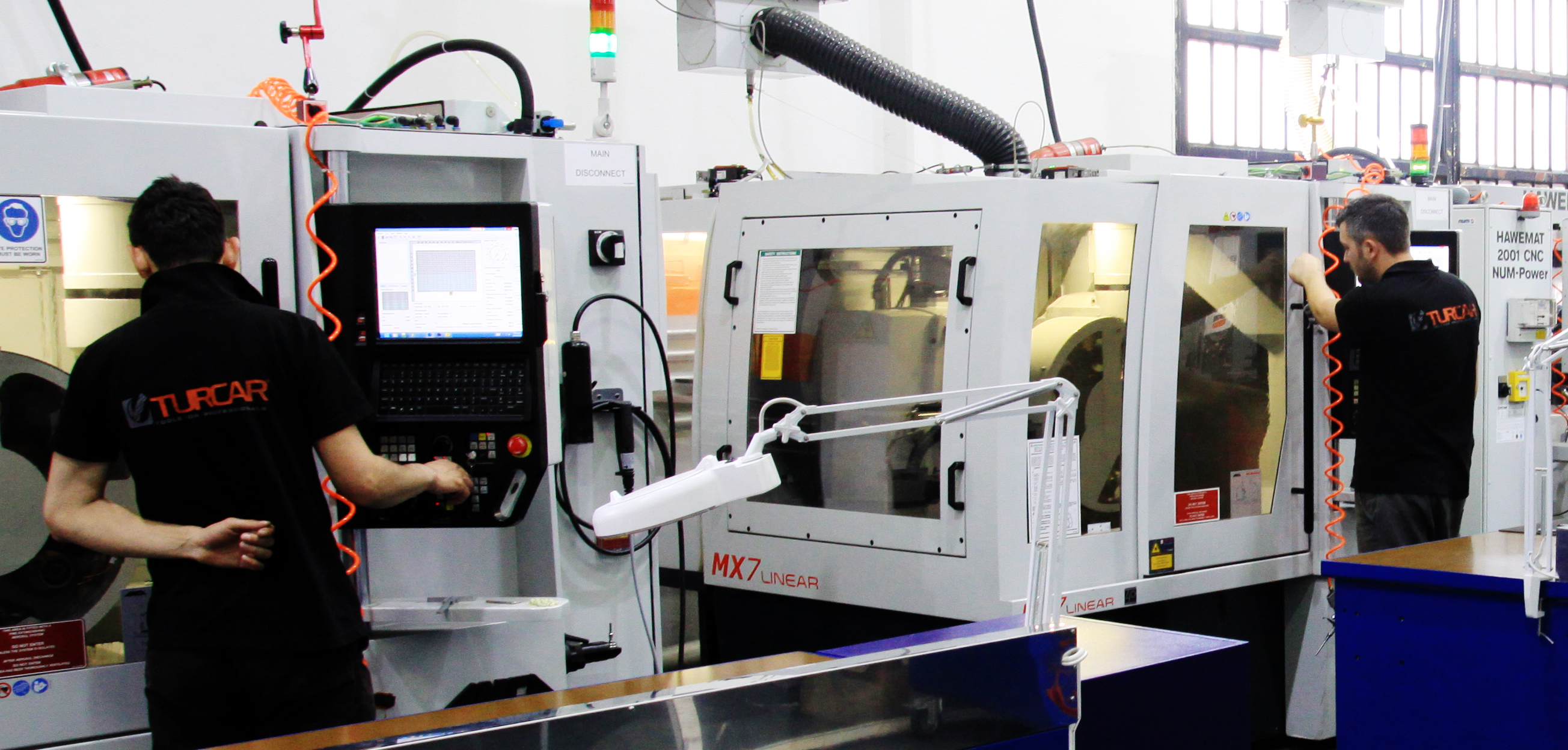

Turcar purchased an ANCA MX7 Linear, which includes the linear motor feature. Added to this is the RoboMate loader, which means the MX7 is the right machine to process large orders quickly and efficiently.

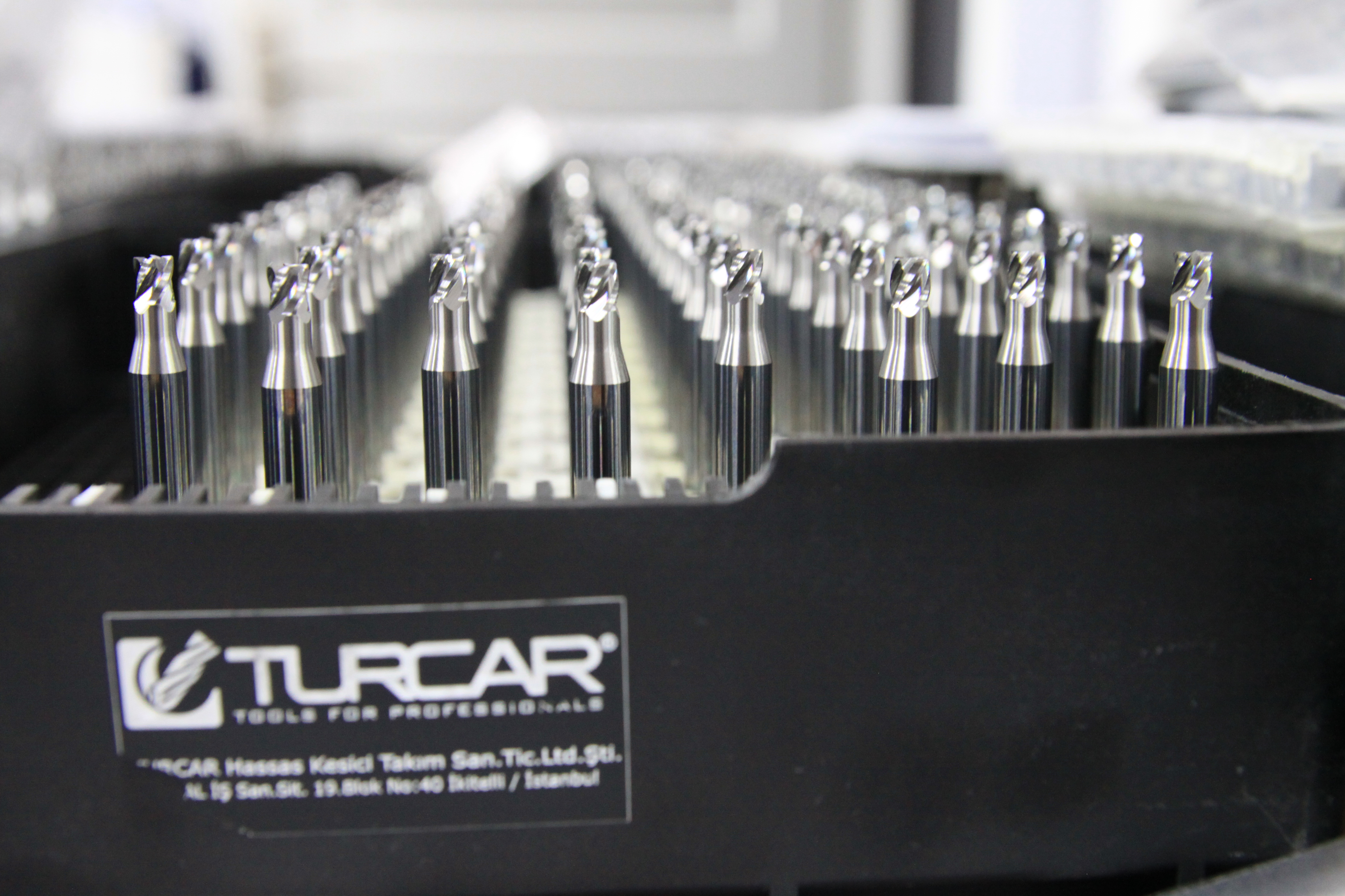

Solid-carbide drills have tight-tolerance requirements. For serial production of solid-carbide drills, Turcar equipped its new MX7 with iView and a P-axis. Through this investment, they are producing tools more economically.
iView is a measuring system that measures the ground tool in its original clamping inside the grinding machine. An image of the ground tool is taken by the iView camera, then compares the ideal overlay shape, which is generated by the iView software. The grinding cycle is then automatically compensated. The P-axis allows automatically repositioning of the tailstock for different length tools without manual intervention.

"The RoboMate automatic tools loader has helped our employees focus more time on product development and research. That's why we also chose the RoboMate loader for our second machine. With the help of the LaserPlus option, the process is very stable, the measurement is done automatically, then compensated if necessary, thus we have extremely low waste."
The RoboMate Loader is a standard automation system for use on the ANCA tool grinders. The automatic loader increases capacity and reduces training with its commonality across several ANCA machines. This means new staff can be trained faster and existing staff can use the automation system on several ANCA machines after being taught one product. Specialist knowledge loss due to employee absence can then is less of an issue.
Öztürk said: "There are a lot of advantages of the RoboMate. The biggest advantage is that instead of a machine standing idle, automation means production can be significantly increased. Process accuracy is another advantage of this technology and the accurate surface finish is why our customers choose to work with us.

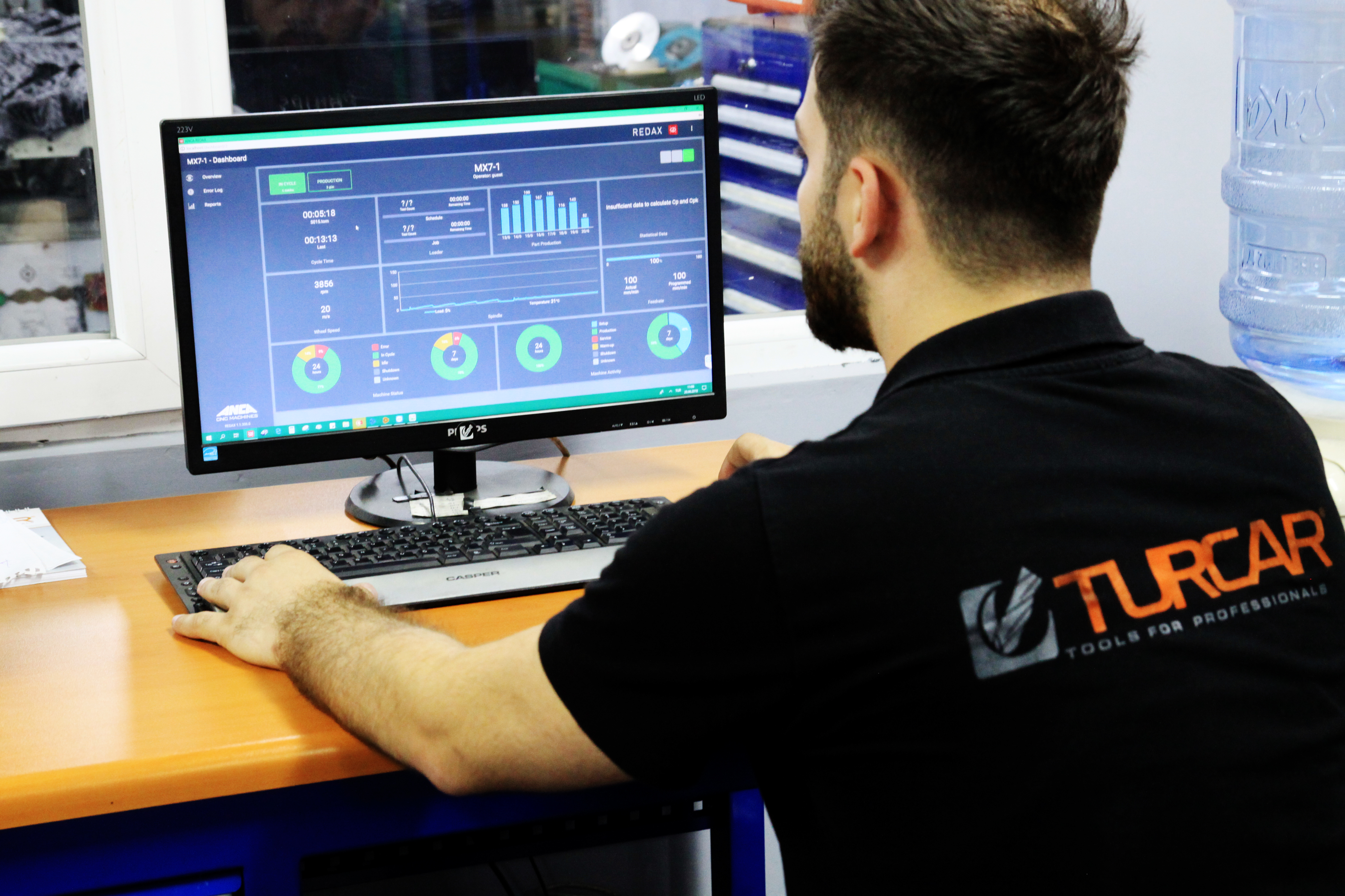

He added: "With the installation of the production and machine monitoring software REDAX , we have expanded the possibilities of data analysis more than ever. Thanks to this excellent software, we are able to track our production planning more accurately. It means we can track the current status and activity of our machines and use the data to plan our production processes. For example, based on the Cp and Cpk values and the spindle temperature values, we can intervene quickly and prevent possible errors during production.
