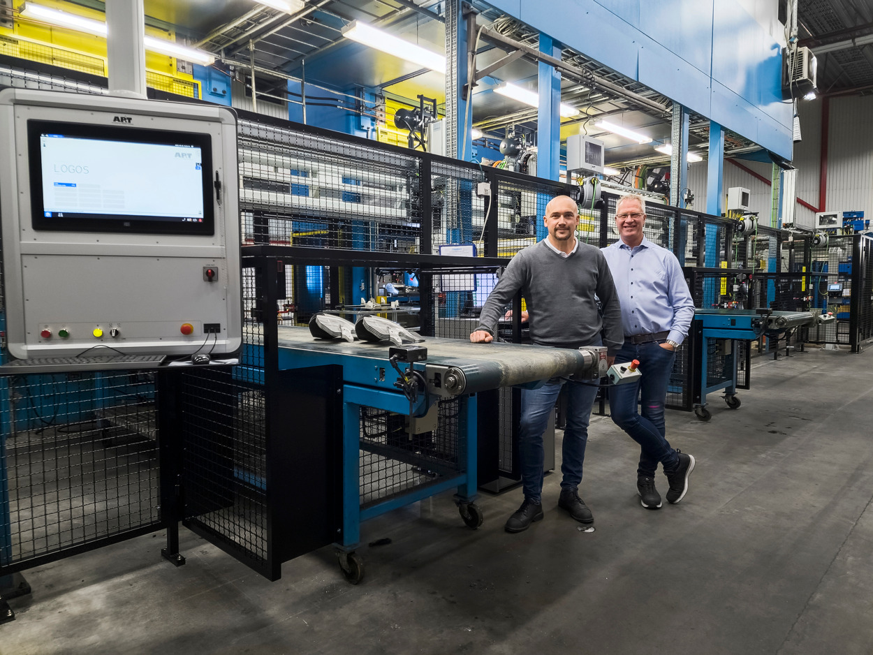

AP&T's Dan Barvö with Tomas Lidbacken, CEO of PVI Esskå.
Top: The fully automated press line manufactures chassis and body parts for heavy trucks. The upgrade increased production capacity by about 500 hours/year. Above: AP&T's Dan Barvö with Tomas Lidbacken, CEO of PVI Esskå.
