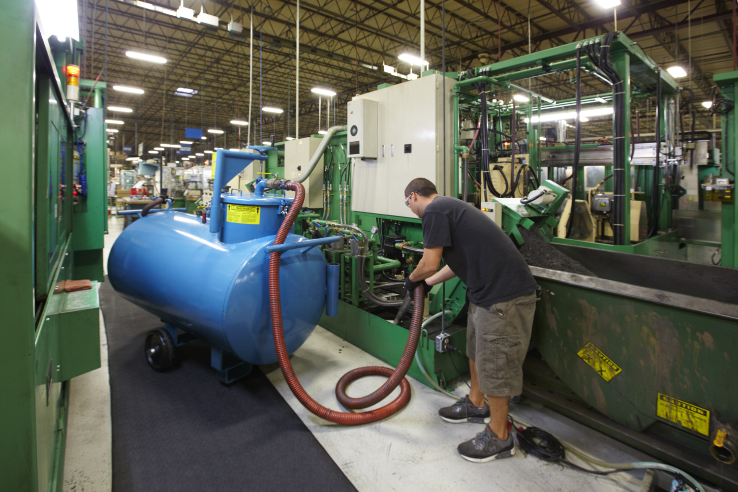

Even though this modernized facility relies chiefly on automation, the job of cleaning out the machines’ sumps had been covered strictly by manual labor. Each machine has three separate tanks and it used to take eight to 11 hours to clean them all out. The Chicopee plant would use an air pump for the liquid, then shovel and scoop out the chips and fines by hand, and finally wipe out the tanks with rags. It was a nasty, time-consuming job.
Then, the automotive division made the decision to purchase an Eriez push sump cleaner with a 275-gallon capacity. This versatile, portable cleaner handles the gritty work of removing chips and fines from cutting oil, saving the company money by re-using the purified cutting oil that keeps the precision machines humming.

They would schedule the clean-up at night when the machines were down. A lot of man hours were needed — a group leader, machine specialist and operator to perform the work and they had to wear protective suits. It would take up to 11 hours to clean all the machines out, plus the company was hauling away all the spent cutting oil. The company was buying cutting oil 220 gallons at a time to replace what the company was throwing away.
U.S. Tsubaki Automotive saves big with Eriez portable sump cleaner image

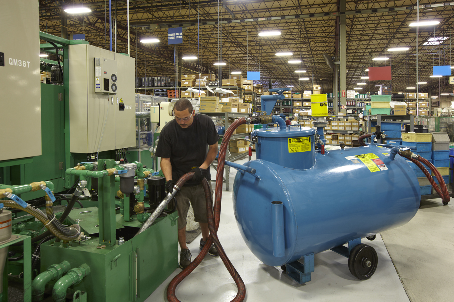

U.S. Tsubaki needed a “continuous improvement idea,” and decided on the Eriez portable sump cleaner. The sump cleaner features a single compartment with 275-gallon (1,000 L) capacity and has center-mounted, high-impact, ball bearing wheels for maneuverability and low rolling resistance.
During the process of cleaning, the sump cleaner removes the cutting oil, sludge and chips from the sumps, filters the sludge and chips from the oil, and returns the filtered oil to the sumps, or transports the oil to waste treatment for disposal. Eriez offers sump cleaners ranging from 65 gallons (246 L) to 1,000 gallons (3,780 L) of capacity.
With the Eriez sump cleaner, it now takes two hours to do the complete job, where it used to take eight to 11 hours per machine. The automotive division re-uses the filtered oil at least one time over, which saves 50% on oil consumption. The change-outs are done three to four times per year on seven lines with three machines each. The economics are impressive. The company saves almost $70,000 per year in cutting oil alone. When you add in labor savings and reduction in downtime, the total payback is over $150,000 per year. As a matter of truth, the Eriez sump cleaner paid for itself in the first year.
