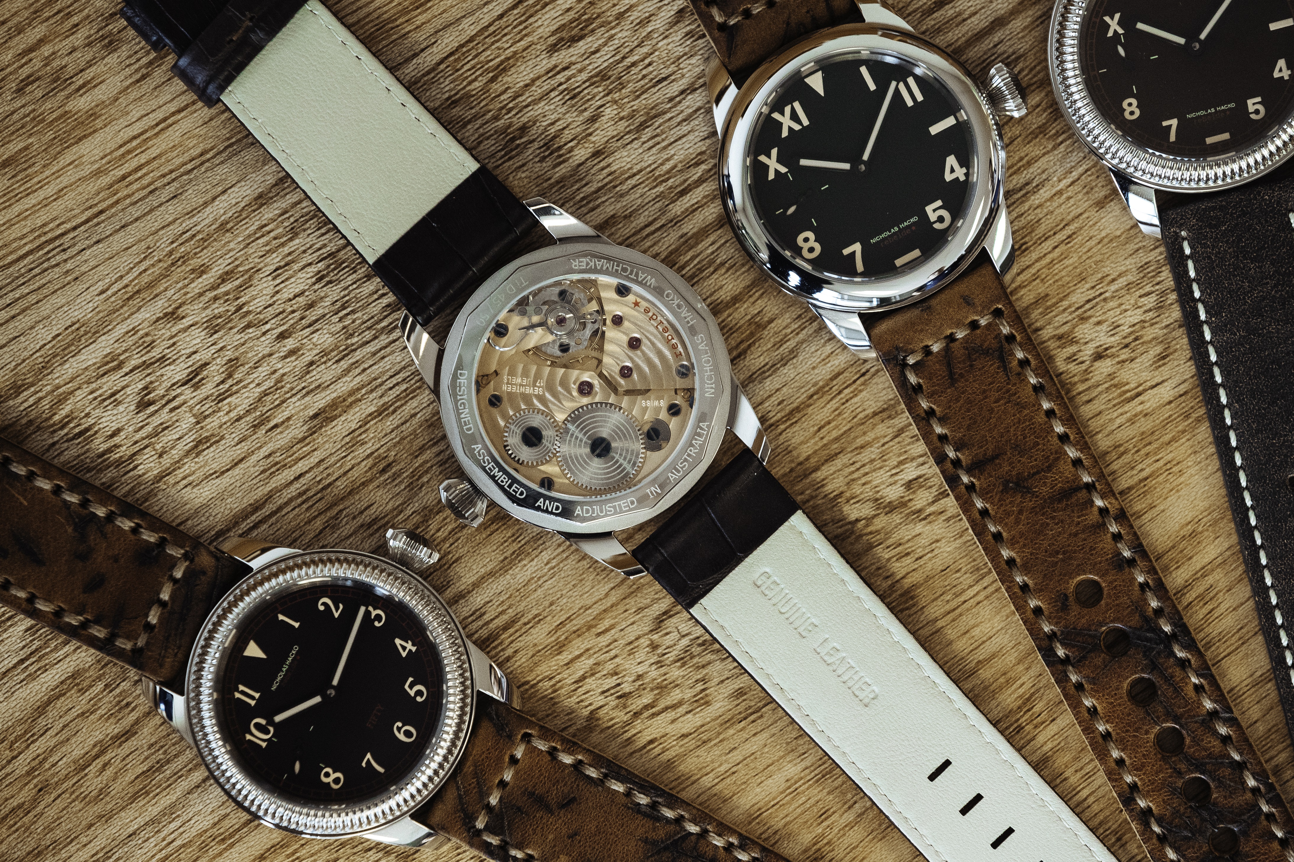

NH Watches has been designing and producing its own watches since 2016—watches made in Australia. Photos courtesy of Kern Precision
In 2011, Hacko took his first step towards making his own watches by founding his own small business called “Nicholas Hacko Watchmaker” – in short NH Watches. Initially, he repaired watches and manufactured replacement parts. Inspired and motivated by the high precision of traditional watch manufacturers and by using his expertise in high-quality workmanship and flawless assembly, five years later Hacko created his first entirely self-designed and developed watch.
Since then, the Australian has been living his dream and enjoying significant commercial success. He produces exclusive, unique timepieces in the price range from USD $1,200 to $11,000. As Hacko explains, he has already surpassed his original goal of making 100 watches per year: “Thanks to a long waiting list of enquiries from interested parties, we have already sold more than 600 watches after only three years. And the huge demand from Australia, Europe and Asia is still going up.”

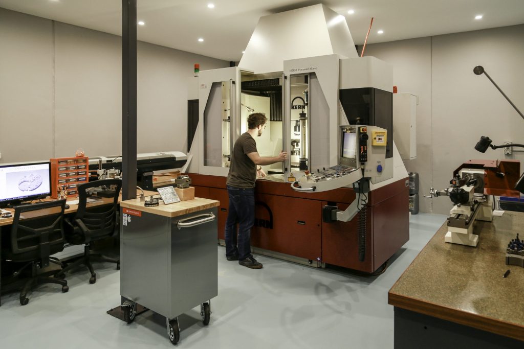

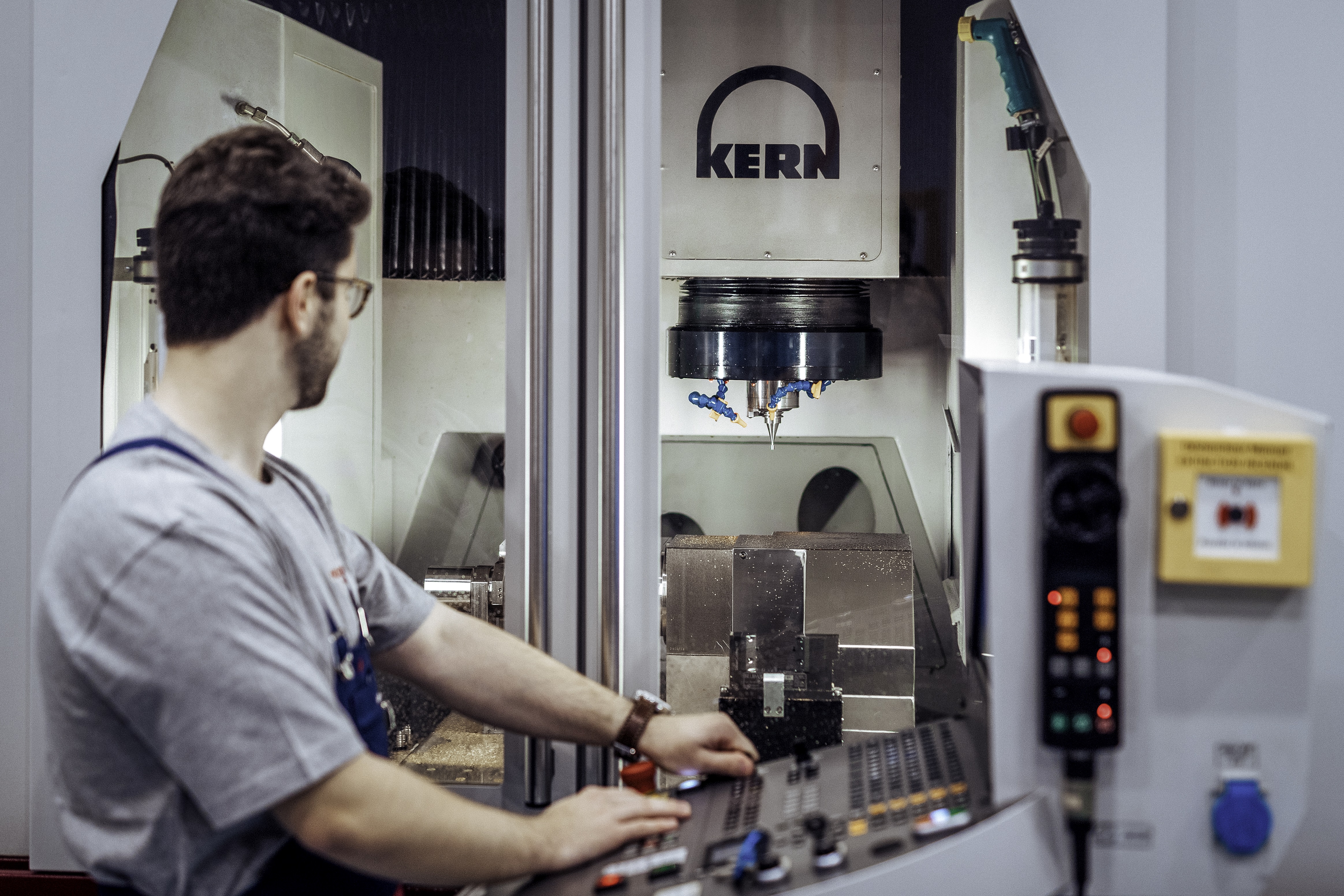

In 2017, Nicholas Hacko invested in a used Kern Pyramid Nano: “This 5-axis machining center still has the same tremendous precision as it did at the beginning of its life. It produces each part exactly the way we program it—faultless.”
Producing microparts with μm precision

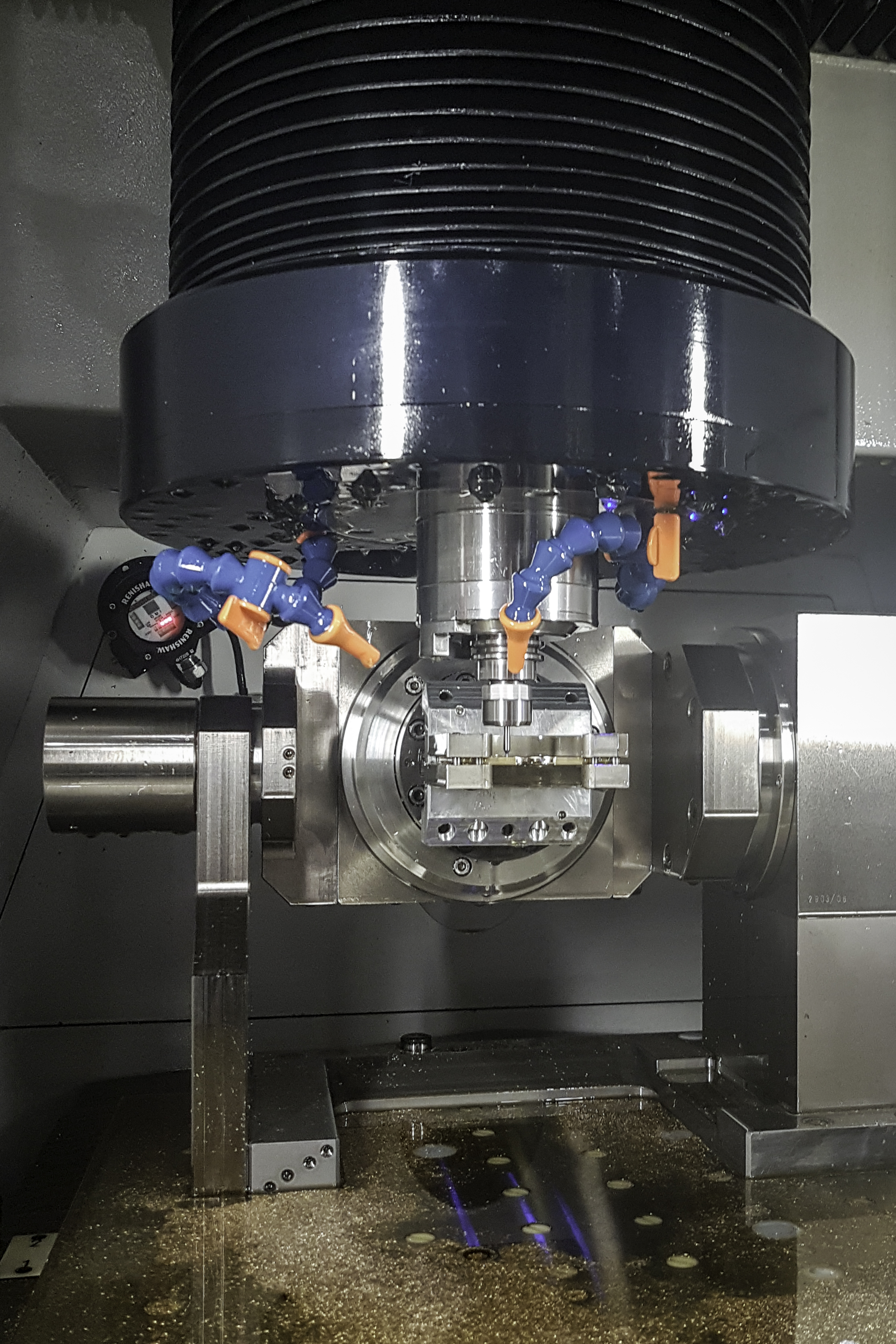

Besides its founder’s creativity and entrepreneurial spirit, Hacko believes that two additional factors are crucial for the success of the brand. First of all, of course, his employees, seven highly motivated people and three of them are apprentices learning the watchmaker’s trade. And then he underlines the importance of his equipment and introduces the Kern Pyramid Nano, a high-precision 5-axis machining center he has been using since 2017. “This machine mills very small gears, bridges, pallets, mainplates and other micro parts with greater precision than is actually necessary,” Hacko said.
Or, to put this into numbers: Hacko typically needs a production accuracy of between 6 µm and 10 µm to ensure his watches keep perfect time throughout their life. In exceptional cases, XY pitch accuracy of just +/-2 μm must be met when drilling and interpolating holes in metal plates. The Kern Pyramid Nano, developed for ultraprecise production by Kern Microtechnik GmbH, Eschenlohe, Germany, reliably achieves a machining accuracy of less than 1 μm—throughout the entire service life of the machine.

This outstanding level of performance is the result of numerous technical refinements that were incorporated into the machining center’s development. While Matthias Fritz, head of development at Kern, is not prepared to reveal all of the Pyramid Nano’s secrets, he is happy to name a few key factors: “We’ve equipped the Kern Pyramid Nano with complex, hydrostatic guides and drives that are not subject to any mechanical wear. In addition, our hydrostatics dampen any vibrations, so even high rates of acceleration have no effect on the machining accuracy.” The result is a machining center in which productivity and precision go hand in hand.

After inspection and maintenance by the Kern service department, the transaction was soon completed—Hacko can now personally confirm Kern’s claim that the machine’s performance and precision remain unchanged throughout its service life. “It’s just like my watches,” he beams, before expressing his satisfaction with the usability of his 5-axis milling center: “We took a small team from our company to Eschenlohe, Germany, where we received excellent training in the Kern Training Center.”
During their visit, the Australians learned all the skills needed to reliably produce high-quality parts, including programming with Heidenhain conversational code, using the right tools and setting up the milling center.
The machine’s final adjustments and commissioning in Sydney also went very smooth. With on-site support from a Kern service technician, it was ready for use in early March 2018. It has been running with the help of Kern’s teleservice support ever since and “produces each part exactly as we program it. It simply doesn’t make any mistakes,” says Nicholas.

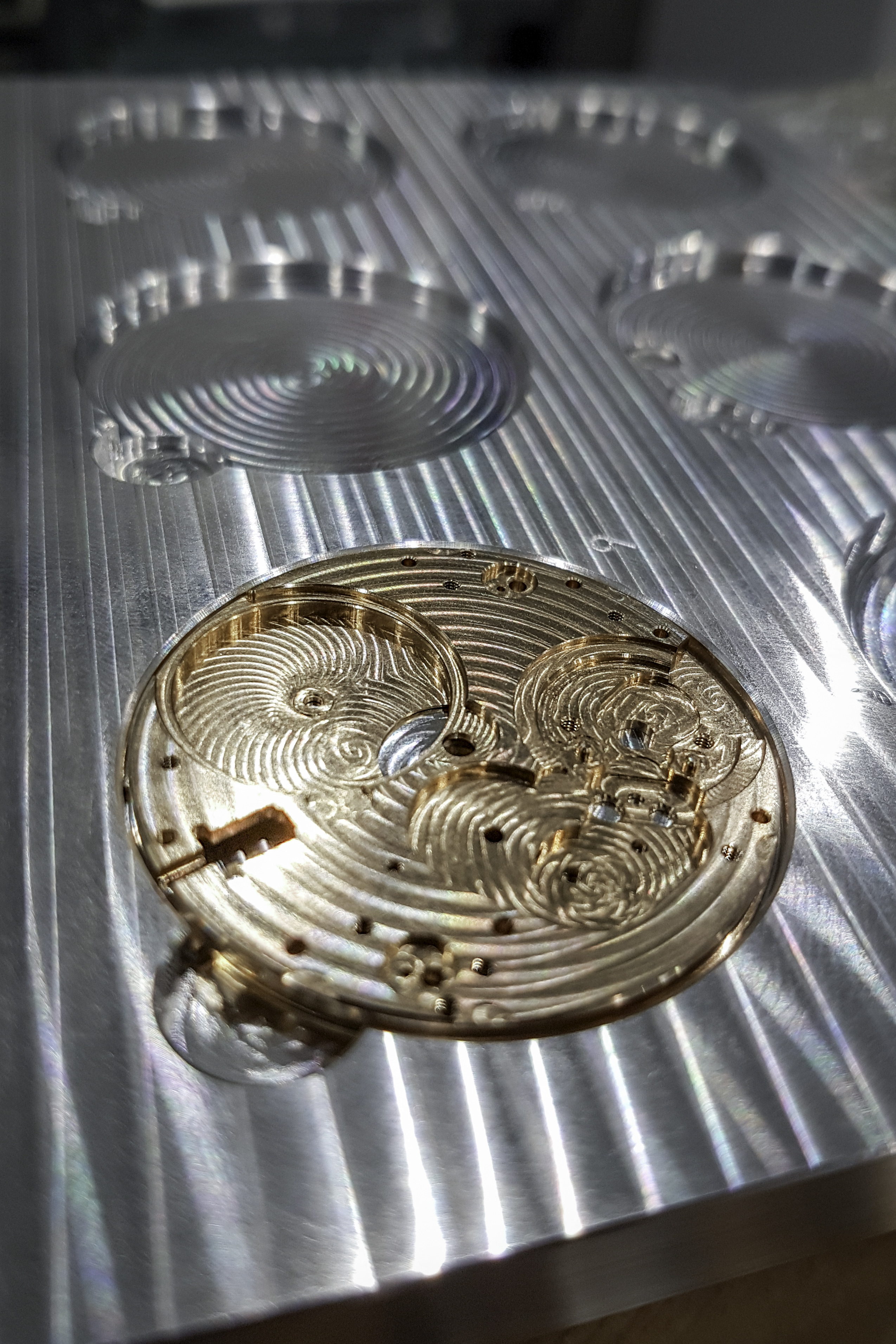

High-precision microparts, such as these boards and gears, ensure that the watches stay tuned.
