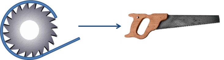

A grinding wheel can be viewed like a saw blade or a round cutting tool with multiple cutting points along its circumference. Photo credit: Norton | Saint-Gobain Abrasives
Figure 1a. A grinding wheel can be viewed like a saw blade or a round cutting tool with multiple cutting points, or teeth, along its circumference. All images courtesy of Norton | Saint-Gobain Abrasives
If we opened up the wheel and laid it flat to make it into a handsaw, the blade length would be the same as the circumference of the wheel. Photo credit: Norton | Saint-Gobain Abrasives
Figure 1b. If we opened up the wheel and laid it flat to make it into a handsaw, the blade length would be the same as the circumference of the wheel. A new wheel would provide a much longer saw blade than a used wheel.

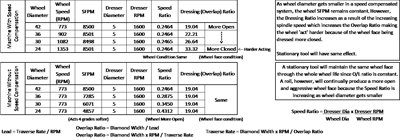

Tables showing machine with and without speed compensation
Based on what we know by convention and experience, the grade or hardness of the wheel is controlled by increasing the spindle speed as the wheel wears. So the wheel behaves the same at the new-wheel diameter as it does when it approaches the stub diameter. The amount the grade changes, or how much softer it will act as it gets smaller, has never really been studied in detail. (The rule of thumb is that the wheel will shift approximately one grade for every 1,000 SFPM change in wheel speed.)
At some point, the spindle will not be able to keep pace to maintain the surface speed of the wheel and, at that time, the wheel will keep acting softer and softer until it stubs out. On grinders that do not compensate speed for wear, this softening happens more quickly and consistently.
The overlap ratio of the dresser also changes as the wheel diameter changes. This means we do not dress the wheel the same as it wears, because we do not compensate for the wheel diameter in the dressing program. We set the dressing program based on the wheel speed and diameter when the wheel is new.
As a wheel wears, the machine increases the wheel speed to maintain the surface speed, but it is rare that the machine would also adjust the dresser speed to maintain how we dress the wheel. As the wheel gets smaller, the overlap ratio increases, which closes the wheel face. A closed wheel face tends to make the wheel "act" harder.
Knowing that grinding wheels are designed to behave consistently from new to stub, all our experience supports that the dress frequency of a given wheel or set should remain the same throughout its entire usable life. Any subtle changes in the wheel's grade or its tendency to act softer as it wears, are being offset or compensated for by the slight increase in the "effective" hardness created by how a wheel is dressed (i.e. due to the increased overlap ratio, which close the wheel face). As a result, the wheel should perform the same throughout its entire usable life.

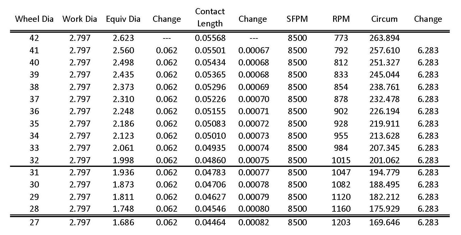

To explain changes to the wheel's performance because of reductions in the contact length, we need to take a close look at the process. Analogous to making cuts with a saw, on the surface a longer saw will cut better with less effort, but it isn't just the length of the blade that needs to be considered. We also need to look at how much of the blade is in contact with the material being cut or, in our case, how much of the wheel is in contact with the part. To calculate the contact length of the wheel, we need to look at the equivalent diameter of the operation.
Again, for the purposes of this article, we will work with the previously stated parameters.
Equivalent diameter or De1 = (DWheel x Dwork) / (DWheel + Dwork) and Contact length = Lc1 := √doc × De1 (or the square root of doc × De1)
Table showing wheel diameter, circumference, rpm, contact length, etc.
A 42"-dia. wheel would require a 14" flange based on ANSI Standards. That means the absolute minimum wheel stub diameter would be 28". However, most grinders have the wheel stub out an inch or two from the flange, meaning the stub diameter is more likely around 32" (indicated above by the single and double underlining).
The above calculations show that the equivalent diameter and contact length of the wheel does get smaller as the wheel wears. This would suggest that the wheel should act softer as the customer's engineer suggested, but the amount and rate of change is so small and steady that any significant change in the wheel's behavior or performance is unlikely.
More likely, the minor softening of the wheel caused by the changes in the contact length is offset by the changes in how the wheel is dressed. We know that as the wheel wears, the overlap ratio of the dresser changes, resulting in a more closed and harder-acting wheel.
When we take everything together, it is proven that in a grinding system that maintains a constant wheel speed, a properly specified and designed grinding wheel should behave and perform the same at its stub diameter as when it was new.
Therefore, unless there are other factors influencing the wheel's behavior, the grinding wheel should not require any adjustments or changes to maintain its performance. It should be noted, however, that in a system that does not compensate for wear, the wheel will wear more quickly and therefore, its performance will be altered due to the changes in surface speed and the continual softening of the wheel.
Finally, in most systems, the controller may only adjust wheel spindle speed (rpm), and not adjust for dresser wear or increases in dresser speed (rpm) as the wheel wears. Even though we can show that in a speed-compensated system, the wheel behaves consistently through its whole usable life, as would be expected. To truly optimize and maintain the system, the grinding program should also adjust or compensate for the dresser speed and overlap ratios to maintain wheel face and dress conditions.
