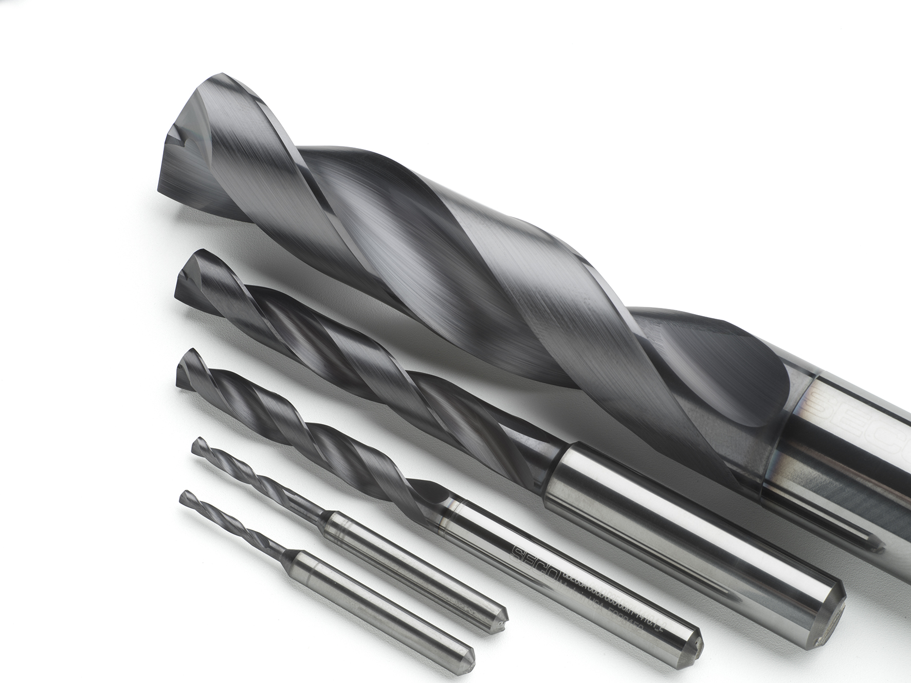

For its latest generation of solid-carbide drills, for instance, Seco paid particular attention to coolant delivery in the design of its new Feedmax –P drills. They have coolant holes directly adjacent to the cutting edge – precisely where it is needed most. Heat can also be reduced by decreasing the size of the land margins, which limits the friction caused when the drill, as opposed to the cutting edge itself, comes in contact with the hole surface.

Seco paid particular attention to coolant delivery in the design of its new Feedmax –P drills. Photos courtesy of Seco Tools

That strength can also remain undiminished for longer periods of time thanks to advances in coatings. Materials like the titanium aluminum nitride (TiAlN) coating on the Feedmax -P drills cause microstructural changes that strengthen the drill’s materials and allow it to resist oxidation at high temperatures. For drill surfaces, the coating creates feed barriers that outperform those of typical TiN coatings. In combination with larger flutes and optimized cutting edges, this results in solid-carbide drills that can be anywhere from 20 to 100 percent better in terms of productivity and total tool life.

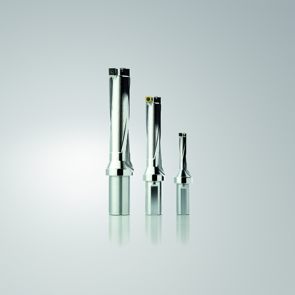

Like solid-carbide drills, indexable insert drills have experienced the same kinds of radical design changes and improvements. Even the smallest details, such as the location of coolant holes, have been tweaked in these latest designs. Of course, the most important changes have happened at the very front of the drills, particularly with respect to the area where chips make contact with the drill body after being broken off by the cutting edge.
Fast moving chips constantly hit the walls of the drill body flutes, causing the surfaces to crater and erode. Generally, a few microns of nickel-Teflon will provide surface protection, but a far superior solution is laser hardening. This process involves quickly heating a ferrous metal with a moving laser then utilizing the self-quenching nature of these materials to cool it. The resulting martensitic structure of the metal surface is just as strong as traditional coatings, at 60 HRC, but the 0.3 mm to 0.5 mm of hardened material is much thicker, significantly extending the life of the tool.
In addition to the application of laser hardening, Seco has also further refined the flute geometries of its new Perfomax indexable-insert drills. Even a difference of one or two degrees in the helix angle of flutes can create dramatic improvements in drill performance, while extended flute radii keep chips from escaping. The flutes also incorporate friction-reducing wave patterns on their surfaces to increase lubricity and further streamline chip evacuation.

The flutes on Perfomax indexable-insert drills incorporate friction-reducing wave patterns on their surfaces to increase lubricity and further streamline chip evacuation.
Outside of the flutes, additional radial clearance and grooved surfaces on the drill body keep noncutting surfaces away from the hole, which reduces chip jamming and drill damage. Even the shanks of these drills have new performance-improving features, such as chamfered flats that eliminate the markings of setscrews from holders left on the flats of drill body shanks, as well as large corner radii in the insert pockets for additional strength and rigidity.
