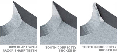

Break-In Visualized
What does breaking-in a blade actually do? New bandsaw blades have very sharp edges on the teeth. That very sharp edge is easily broken and chipped if not broken in properly. Just like a very sharp pencil, the sharp point can break off when you start using it, leaving an irregular, jagged point that doesn’t write well. By gradually increasing the feed pressure during break-in, the sharp tooth edge is evenly honed, leaving a very fine radius to the leading edge of the tooth. This radius allows the chip to shear away from the workpiece more readily, and also gives the required support to the tooth tip, which undergoes extreme forces in the cutting process.
Break-In Process
The process to break-in a bandsaw blade will vary depending on the characteristics of the material being cut. While breaking-in a blade, have the machine running at the normal surface feet per minute.
For softer materials, such as carbon steel and aluminum, adjust the feed pressure to 50 percent of the normal cutting rate for the first 50 to 100 square inches. Then, gradually increase the feed pressure to 100 percent cutting rate.
For harder materials, such as nickel-based alloys, including Inconel, or other difficult materials such as hardened steels, tool steels and stainless steels, adjust the feed pressure to 75 percent of the normal cutting rate for 25 to 75 square inches. Gradually increase the cutting rate to reach 100 percent after 50 square inches. As the feed pressure is increased to the 100 percent cutting rate, be careful to avoid creating vibrations that can occur by increasing the rate too quickly.

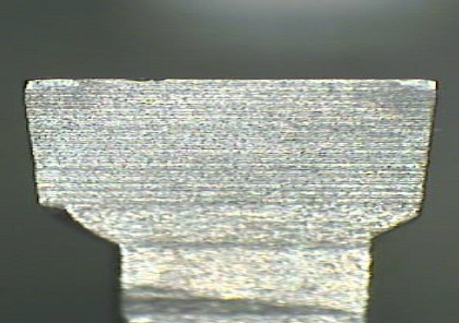

Below is an example of damage to a tooth’s cutting edge that can happen when the proper break-in process is not followed. The photo shows a carbide-tipped bandsaw blades. The blade was run at full speed and with full feed pressure on its initial cut.

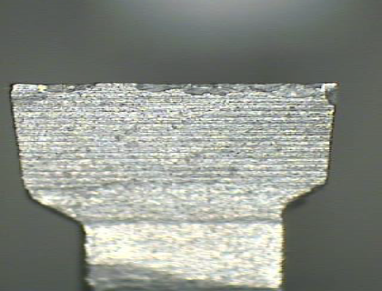

The following photo shows how with a proper break-in, tooth edge damage can be avoided.
