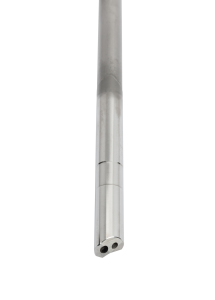

Custom-Designed Double Contour Single Flute Gundrill
The machining improvements are achieved by a special cutting drill contour with an added rear contour configuration that acts like a guide pad while the drill remains in the bushing, keeping the tool on location. Once the drill is in the cut, these guide pads continue to force the tool to cut a straight path for the remainder of operation.

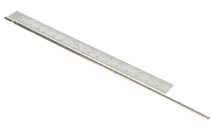

Single Flute Extended Length Gundrill
In a field study on an aluminum cylinder head, the application of the extended drill was able to achieve a tool life of 2,000 parts per drill when machining holes of 8 mm diameter at 5,000 RPM in the cut and a feed rate of 1200mm/minute. Prior to the deep hole gundrill operation, there were two twist drill passes with the gundrill connecting the center portion of this feature in the head.

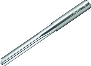

DC165 Advance
The drills are coolant-through, straight flute (G-drills), with emulsion or oil and coolant pressure of 145-580 PSI (10-40 bar). They are offered in cylindrical shank configuration and have a 120° point angle with tolerance of m7. They are also offered in L/D ratio of 5 x Dc as standard, with options for shorter and longer drills to be ordered and specials through Walter's signature Xpress quotation program.

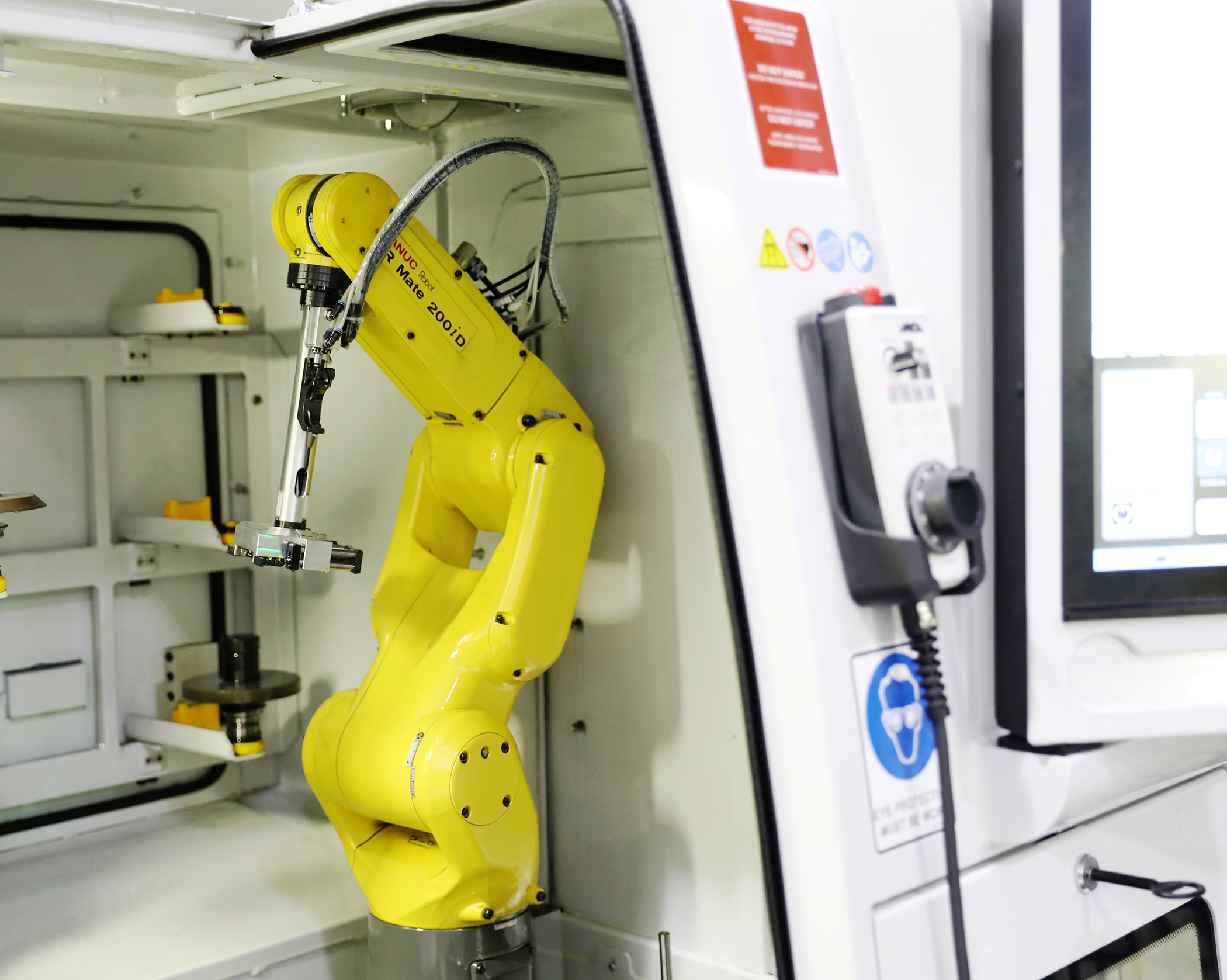

FX Linear Medical Drill Loading Kit
ANCA has designed a special dental drill loading kit including tailored RoboMate pallets for FX machines using a Fanuc 200iD robot loader. The pallet top allows a reduction of the insertion depth of the shank with an 8mm pocket depth, so that drills with only 10mm of available shank length can be loaded. The robot grippers have also been modified for the reduced thickness of medical tools. The medical gripper can accommodate Ø2-10mm x 100mm with a maximum head diameter of 14mm.

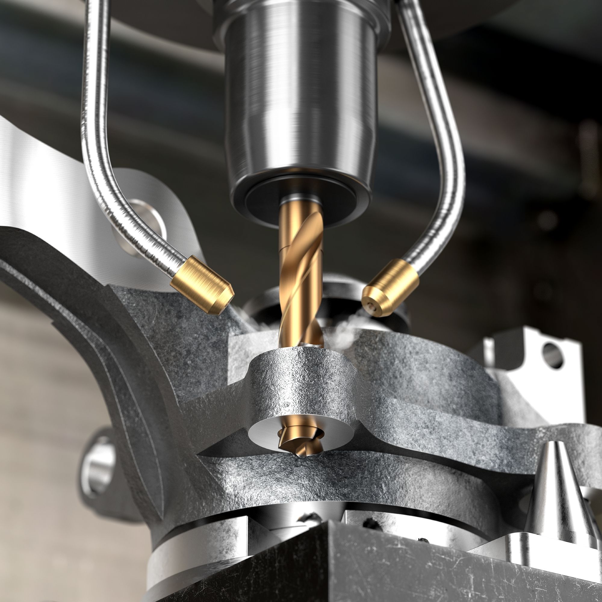

DC 175 Supreme Solid Carbide Drill
In addition to the cooling and geometry, Walter's new WJ30RZ and WJ30RY grades also boost performance because their highly wear-resistant TiAlSiN-based layer applied using HIPIMS coating technology takes the form of a complete coating for 3 and 5xDc (WJ30RZ grade) and a point coating for 8×Dc (WJ30RY grade). The 8×Dc version also features a polished flute for deep drilling. The result is a very smooth surface which ensures optimum chip evacuation and minimizes built-up edges. The ability to recondition the drills boosts the cost effectiveness three times, paired with its long tool life, also further boosts cost-effectiveness.

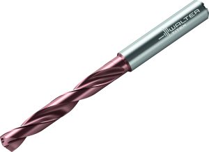

Upgraded CoroDrill 860
The drill features a new grade, with an improved multi-layer physical vapor deposition (PVD) coating. The results are enhanced wear resistance, better tool life and an overall increase in productivity and thereby reduced cost-per-component.n
