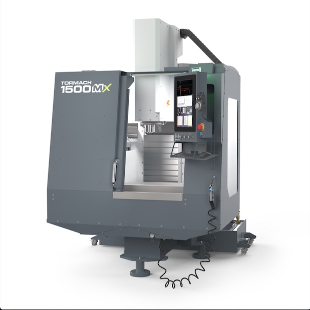

The 1500MX offers a host of features designed to enhance machining efficiency and precision. Crafted with an epoxy granite frame made in the U.S., this machine boasts ten times the damping of cast iron, ensuring chatter-free cuts, superior surface finishes, and 30% longer tool life.
Equipped with a robust 4HP, 10K RPM BT30 spindle (with a maximum of 6HP), it delivers ample torque for cutting through various materials and offers enough spindle speed to take advantage of modern carbide tooling. Additionally, every 1500MX is thru-spindle coolant (TSC) ready, facilitating seamless integration of TSC for enhanced drilling efficiency, smoother finishes, part consistency, and extended tool life.
Featuring servo motors with absolute encoders boasting 23-bit accuracy and battery backup, this CNC mill eliminates the need for machine referencing, ensuring uninterrupted precision even between power cycles. Cutting feed rates of up to 1200IPM (XY) reduce cycle times and take advantage of adaptive tool paths.
