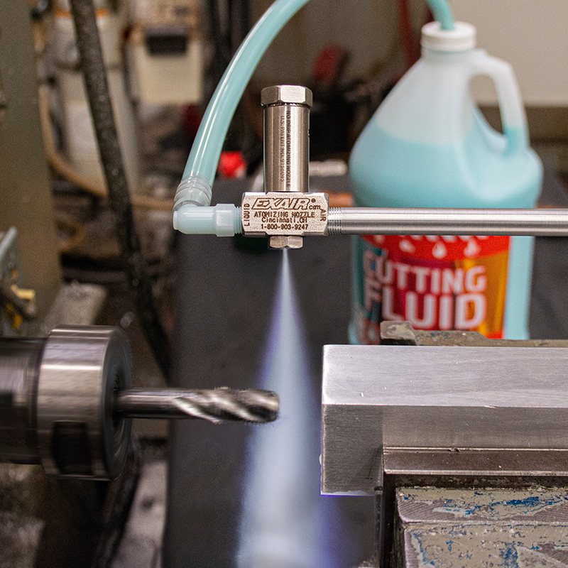

EXAIR's new 1/8 NPT No Drip Siphon Fed Air Atomizing Spray Nozzles provide consistent and even flow of non-pressurized liquid for applications like marking, lubricating, rinsing, cooling, quenching, wetting (moistening), dust control and humidification. The intelligent design of this Siphon Fed spray nozzle allows for the absence of liquid pressure and in turn, uses gravity fed liquids or lifted liquids from a siphon height of 36 inches (91cm) with the added benefit of positively stopping liquid flow when compressed air is shut off.
Post spray drips waste precious resources such as expensive coatings, chemicals or water, and unwanted drips can ruin product function on sealing or mating surfaces as well as ruin the appearance of painted or coated finishes. EXAIR's No Drip Atomizing Nozzles are ideal for these situations where no post-spray drip is permissible. When the compressed air supply is shut off, the no drip nozzle positively seals off the flow of liquid eliminating the possibility of drips.
