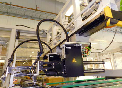

The major advantage of WEISS’ 3-axis system is that end-users only pay for what they actually need. Thus, procurement costs for the three axes are significantly lower when compared with a 4-axis SCARA. The key to this intelligent handling solution relies on standard components that have been proven in thousands of applications and can be combined to create perfectly matched sub-systems. For this specific palletizing example, WEISS selected a type HN 100 linear motor axis as the basic axis.
Permanently connected to the basic axis is the HP series direct-drive pick & place module, which forms the 2nd and 3rd axis. Unlike a SCARA robot, the strokes of the axes can be precisely matched to the dimensions of the tray.

Given the sophisticated combination of various handling and axis units, the WEISS automated process is considerably more flexible. For example, two pick and place units can be positioned on a basic axis with a length of up to four meters and can work independently of each other. Instead of eight axes, only six are required. The customer effectively pays for six axes (basic axis with two carriages and two pick and place units) and utilizes the rail of the basic axis twofold, making cost advantages compared to the eight SCARA axes even more significant.
