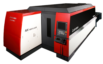

3015 NX-F Fiber Laser System
Mitsubishi EDM/Laser offers its new Fiber Laser line. Fusing Mitsubishi's laser processing machines with the advanced fiber laser beam, this Fiber Laser has evolved laser processing to an entirely new level of performance, according to the company.
April 13, 2013
Mitsubishi EDM/Laser offers its new Fiber Laser line. Fusing Mitsubishi’s laser processing machines with the advanced fiber laser beam, this Fiber Laser has evolved laser processing to an entirely new level of performance, according to the company.
The 3015 NX-F comes standard with a fiber laser oscillator, a z-axis linear drive, preset auto-focus processing head, a 64-bit NC with 15-in. touch screen NC-panel, and more. The stroke on the new NX-F will be 125.9″ (3198mm) by 62.9″ (1598mm) by 4.7″ (119mm), with positioning accuracy of 0.0019/20″ (0.05/500mm). And the rapid-traverse rate on the single axis machines will be 4724″ (120 m) per minute, or 6680″ (170 m) per minute on simultaneous machines.
